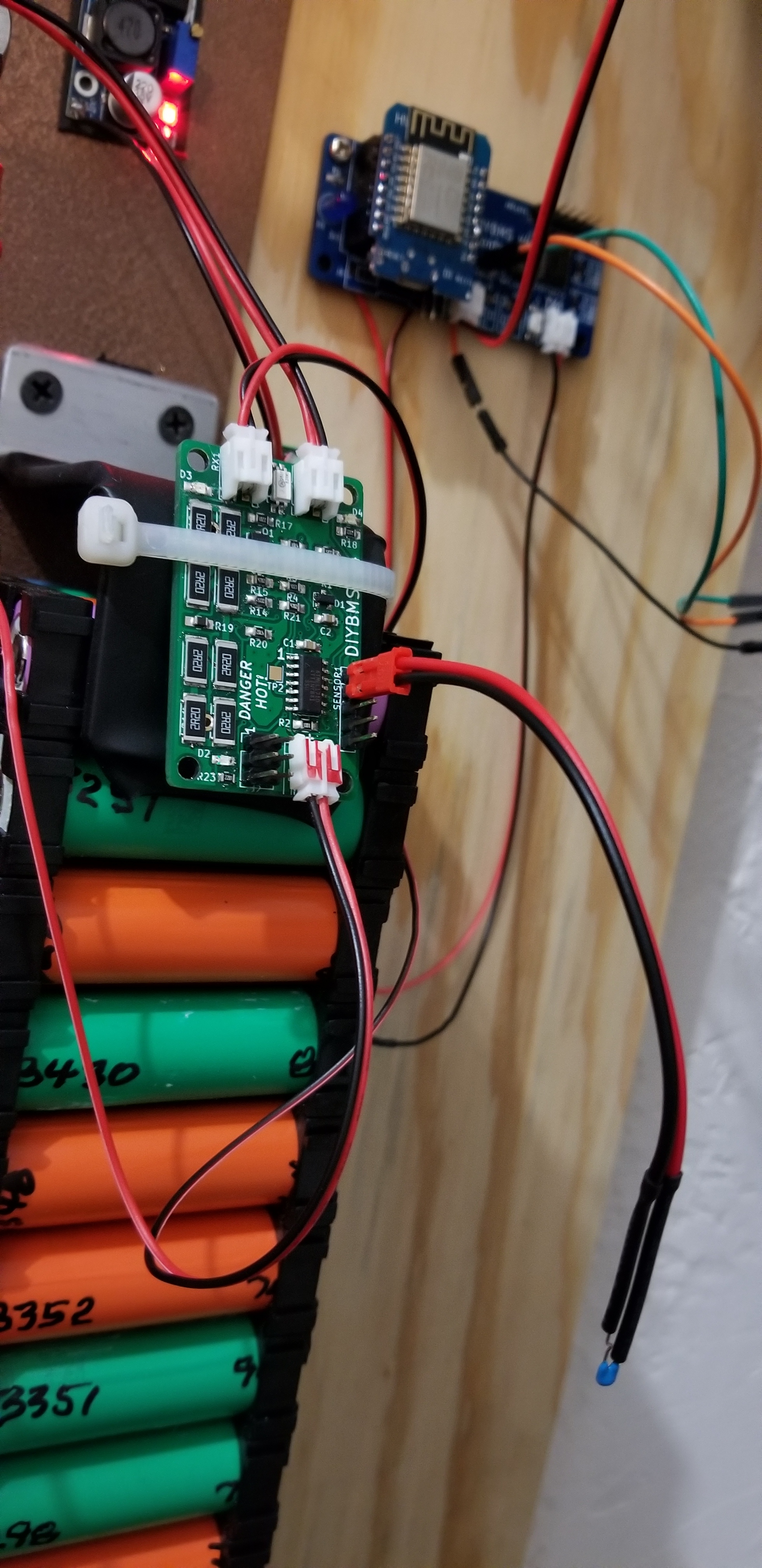

Okay, I think they kept going all the way through like normal, not sure of that. They are normal now with 2nd controller board.
After plugging in 1 external thermistor in cell #0 lost communication. Green lights running through, BUT, #0 starts over before the last half of cell bank finishes.
I’m still testing, trying to bring up one at a time. Appears that the controller board is at fault.

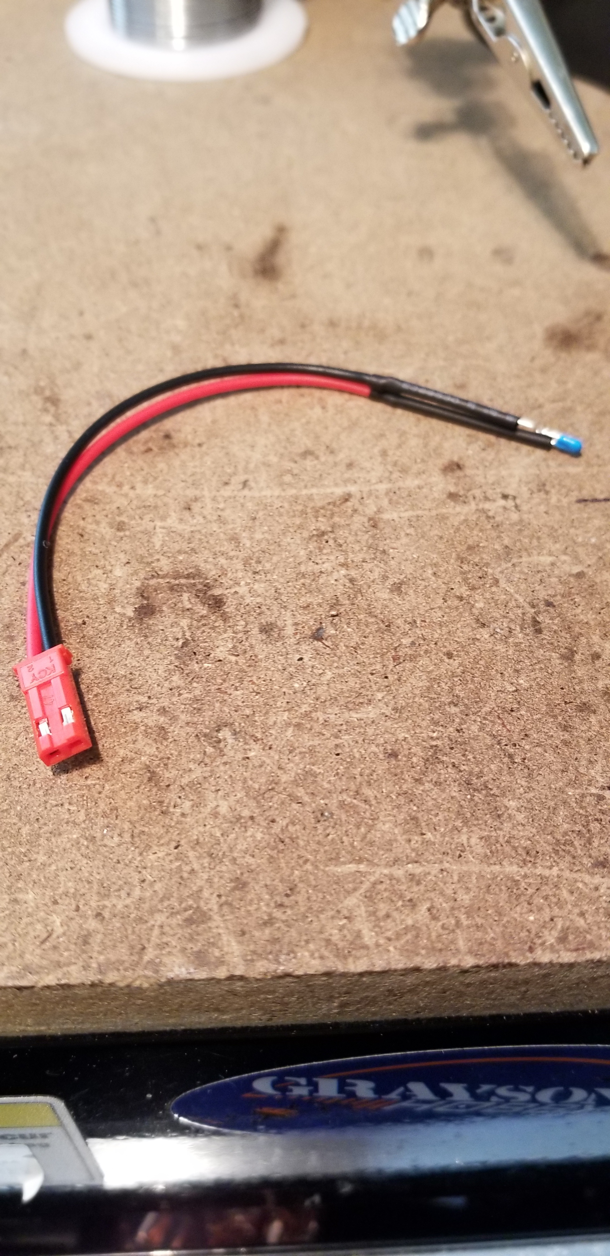

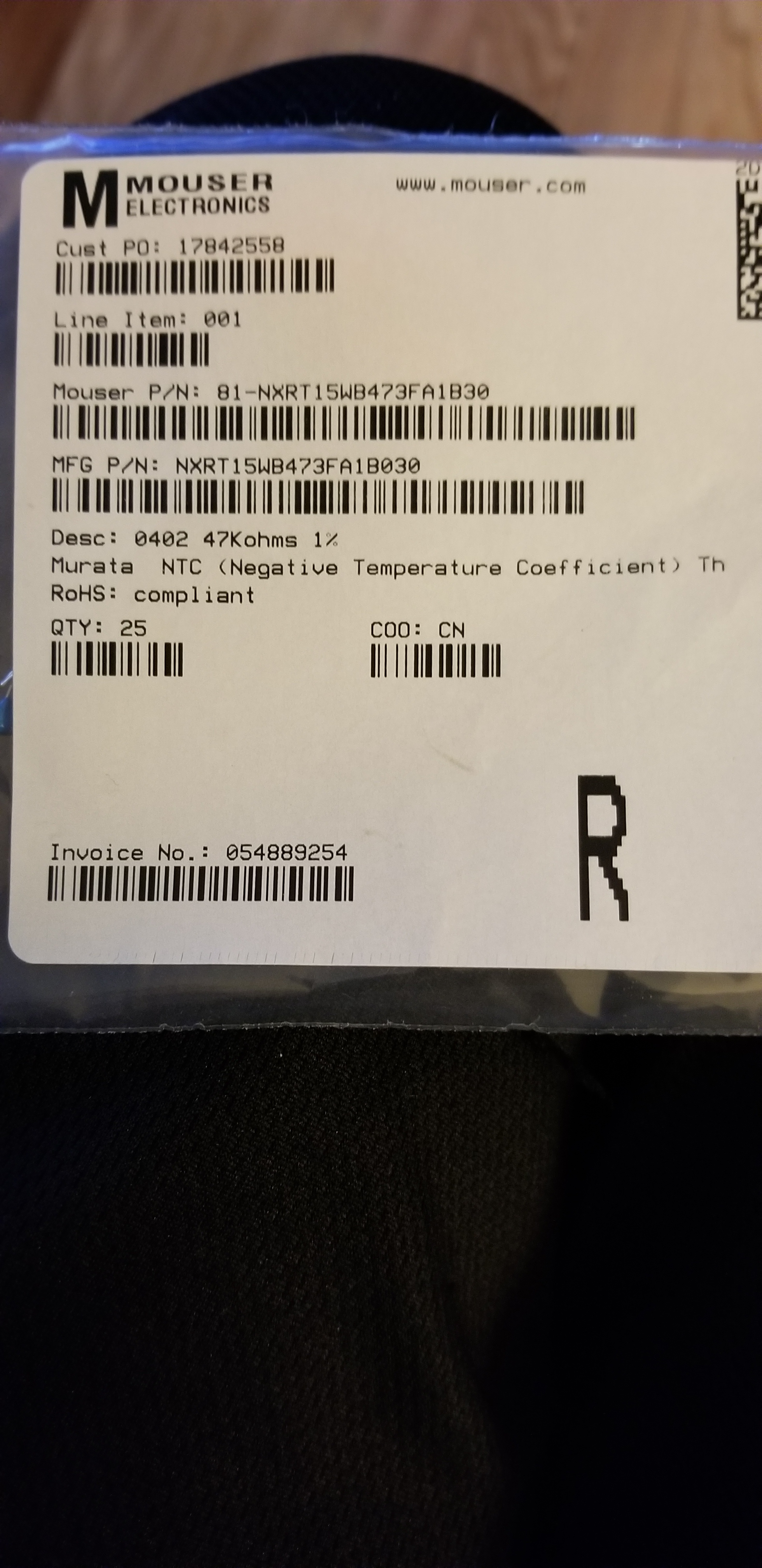

Pics of the thermistor:
Okay, after much thrashing about, making a 3’ jumper to walk through the modules (doesn’t work, too long?)(turned out to be bad solder joint). I was able to determine the second module is not working??? Controller is fine.
So, one of those external sensors is bad, maybe shorted, I will test them.
Reconnect supposedly bad module, works fine. All thermistors are okay. I am at lost to explain what is at fault.
Maybe the external sensor is throwing off the comm?
Nope! Started connecting them again, from #0 to #3 all working fine. Will continue building.

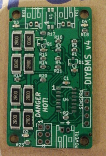

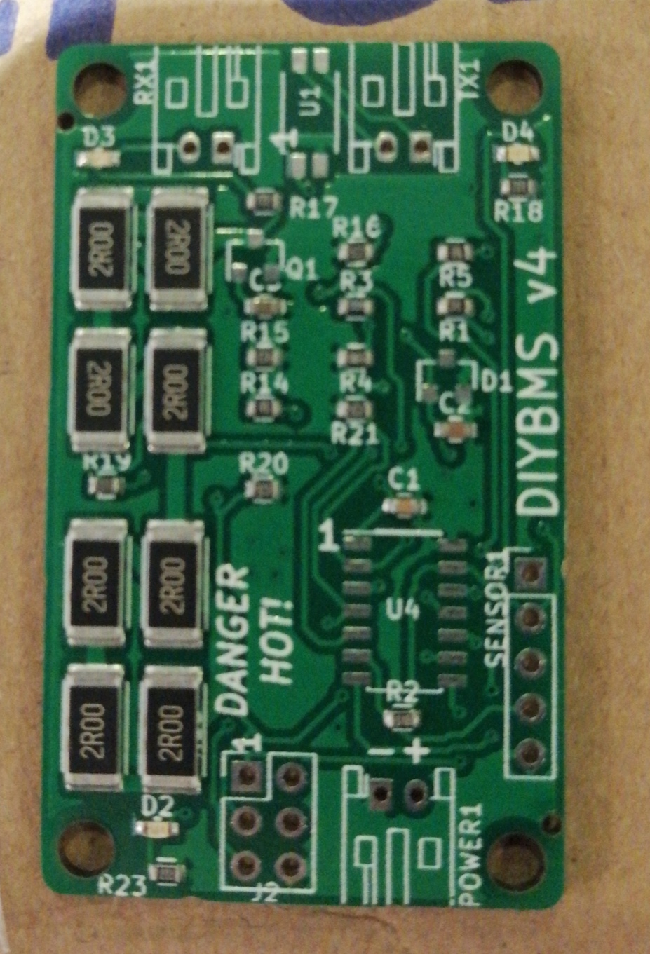

My jlcpcb assembled boards arrived today. These use the small 0603 sized parts, they are tiny! Not all parts are available via jlc so I will handsolder the rest.
Only having a couple components to solder isn’t too bad really, that new assembled board looks great. Can’t wait to see how it tests out and then I’ll order the 30 I was planning to order.

Looks good so far, first module up and running.
I’ve tweaked the resistor value for the blue led as its quite dim
I’ve also swapped the optoisolator from HMHA2801 to HMHA2801AR2 they should be very similar, but I’ve not tested that yet so if you are planning to order, might be worth handsoldering these.
Also swapped over LM4040B to LM4040A20IDBZR as this is available through the JLC assembly but the price is very high, so again exclude and handsolder using parts from elsewhere. Its the trade off of cheap assembly against availability of parts.
Even with handsoldering, only took 5 minutes to complete the board so happy with that.

Hi @atanisoft I’ve just uploaded a full set of Gerbers and BOM/CPL files - the placement looks good on these.
Note that I’ve selected some replacement parts
  1. Swapped LM4040 for ADZ5040 (cheaper and available)
  2. Swapped HMHA2801 for HMHA2801A (this part has a lower CTR which may be a problem)
The cost for assembly at the moment and all the part (excludes ATTINY841) is $73 USD for 30, so less than $2.50 USD per board.
NOTE I’VE NOT TESTED THESE NEW COMPONENTS SO YOU DO SO AT YOUR OWN RISK/COST - IF UNSURE, EXCLUDE THEM FROM ASSEMBLY AND USE THE OLD PARTS.
https://github.com/stuartpittaway/diyBMSv4/tree/jlcpcb_assembly
Edited: Also changed resistors in voltage divider to basic parts, so this reduces the cost to $67 USD so $2.23 USD per board
That isn’t too bad, add in the ATTiny and the overall cost for a 30 pack of boards will be ~$100 USD (approx $1USD per ATTiny from Mouser or DigiKey).
from a review of the datasheets they appear to be a drop in replacement with the ADR5040 having slightly tighter tolerances for the output voltage but otherwise functionally identical. Definitely worth a test though.
From the datasheet of HMHA2801 it appears to be a not recommended for new designs, perhaps swapping for the FOD817 would work and not have the concern of the HMHA2801A?
