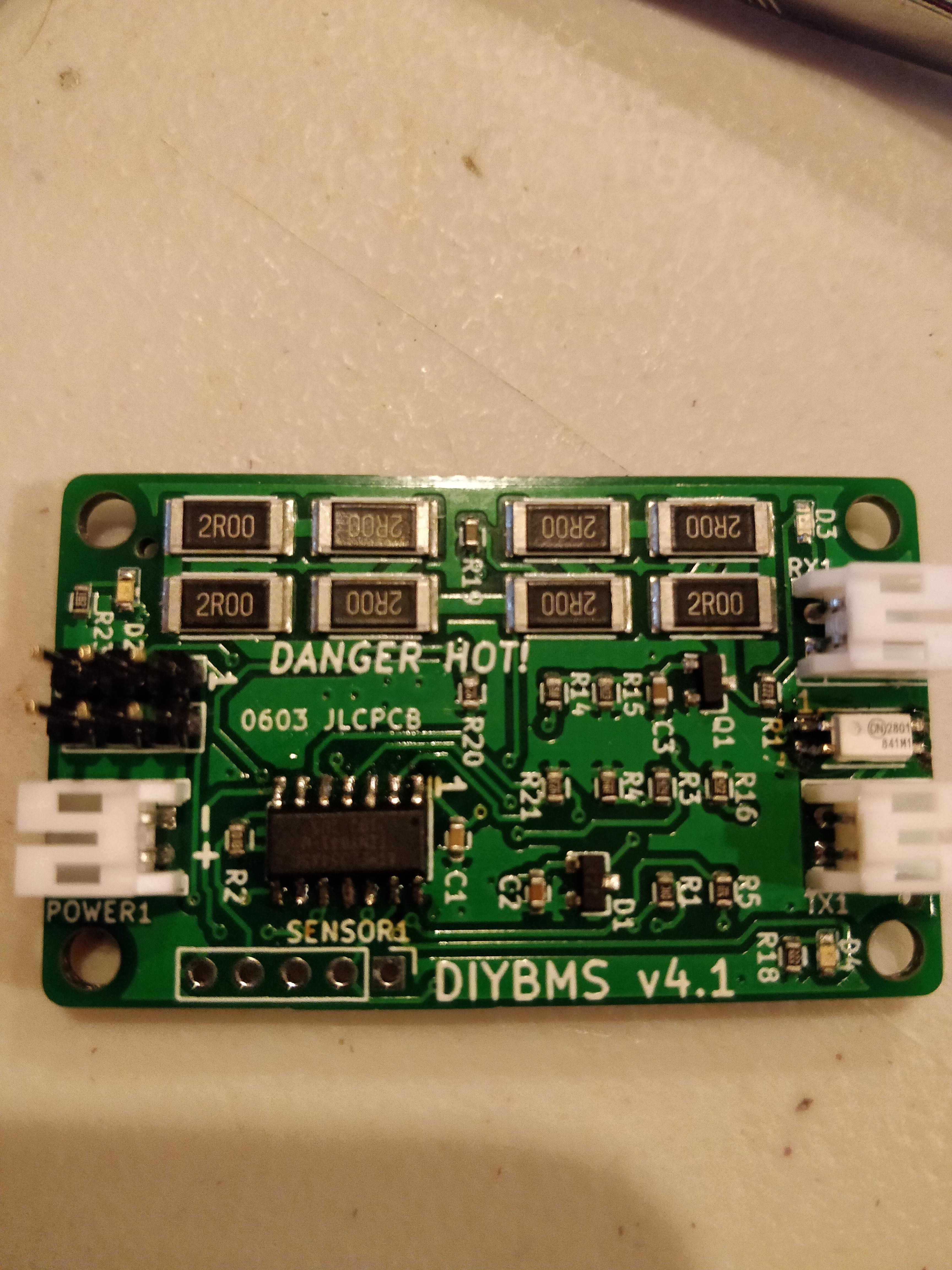

Received my 30 mostly populated boards today as well as the ATTinys and opto-isolators…
First board assembled:
Overall the quality looks pretty decent and soldering the ATTiny wasn’t that bad with a 75W iron (900M-T-B tip, wish I had a smaller one!), flux pen and 0.025" solder.
Now to fight with the USB ASP device on Gentoo Linux, it doesn’t seem to be showing up for some reason when plugged in. Once I solve that I will flash this and do some basic sanity testing.
Before you connect the battery just do a simple multimeter continuity test between positive and negative pins on the module to check for dead shorts.
There is also a test sketch program in the code you can use which will test the LEDs and load resistors, don’t leave it running for long as it will drain the battery!

Perfect, I was able to sort out the USBASP problems on Linux by adding the udev config file and restarting udevd. I was able to flash the test program and the actual program. I just need to sort out how to read Serial1 output from the board, it looked like it is routed to the 6pin header so I think I should be able to connect a few jumper wires to connect it to the FTDI cable I have.
Don’t bother with the serial1 output from the modules, it won’t reveal anything interesting.
The debug serial console is on the controller.
The only reason I’m interested in that output is from the test program at this point. The controller is not ready for testing and I won’t be able to hook up the modules to each other yet since I don’t have the crimp on connectors (skipped ordering them with the rest of the parts as I had some on hand but they are too big). I should have them on hand next week though. Until then I will do some tests with the modules as-is to ensure they at least power up and are mostly functional.
Also keep in mind I will be using an esp32 for the controller rather than the ESP8266, more on that later though…
EDIT: tested all seven assembled modules with the test program and they all appear to be acting normal. Will test further once the crimp connectors arrive next week.

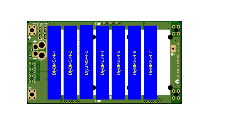

Stuart and others - dragging up an old post from Edoardo_Conti, I am also interested in creating a Jehu compatible BMS “diyBMSv4-Jehu” lets call it, that would allow me to stack a single (165mm x 88mm) PWB with 7 diyBMSv4 PWB segments side-by-side and then use the 16pin IDC connector to link each single stacked cell to each diyBMSv4 portion of the circuit. This would essentially replace his Walfront 24v 7s BMS. Other than current limitations can you think of any other limitations that I need to be aware of?

Be VERY careful with those PCBs. The PCB traces near the IDC connector pins are setup as “fuses” and can cause the BMS not to see that there is a problem cell on a PCB in the stack. This is one of the reasons that I will not be using the stack of these PCBs that I have on hand.

Does that only apply to the Jedu BMS rather than other BMS systems?

This is more of a general problem with the Jehu PCBs, I like the idea of them but there are a few critical issues with them (and similarly created PCBs). The biggest is the trace “fuse” on the BMS sense lines, this is a problem mostly in the event that one of them burns then the BMS will not see the failed cell/fuse and it won’t know or be able to disconnect the broken PCB from the “pack”. Ideally the PCB should be designed as parallel cells with fuses between the cells and the “bus” so that one PCB can be dropped from the pack easily and safely if/when there is an anomaly on the PCB.
However, if you do adapt diyBMS to the Jehu PCBs, I would highly suggest bridging the “fuse” on the PCBs and using multiple smaller stacks of the PCBs in parallel so diyBMS can drop a stack quickly if there is a problem on one of the PCBs in the stack. I would also highly suggest the external thermistors to monitor each PCB for any heat and disconnect when over heating.
