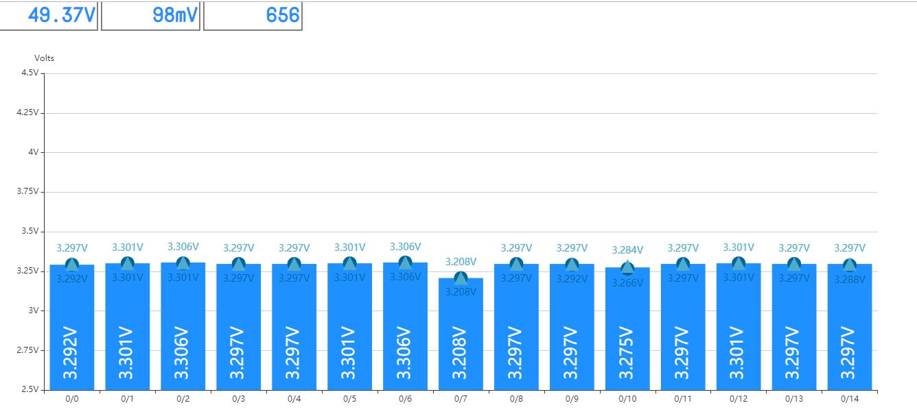

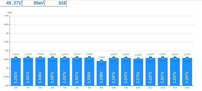

Did the issue with no more than 15S get resolved? I have a 16S system and have the same issue. The BMS will only display 15 of the 16 cells.
Thanks!
Regards,
Jeff
Yes the 15S issue is resolved, but you will need to download, compile and flash to the controller and all modules. Sorry!
