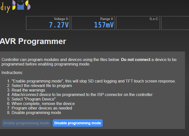

hi all,
apologies for asking a most likely silly Q, but I have my system running on a v4.3 board with v4.4 modules 8S LifePO4 bank on my boat for the last three years. Once a year I’d update s/w (over wifi) and once or twice I’ve updated modules (mainly to set them to 5k)
However, following a mishap (unrelated to diybms) I had to disconnect everything for a couple of weeks. Noticed that the v4.4 modules stopped blinking randomly as they do, some went dead, some went constantly lit. Disconnected from the cells, connected again, dead, cells all around 3.2V.
controller is stuck to waiting for modules (for ever)
Got some backup modules, works with them, so thought I’d reflash the modules just in case.
And here is my problem on the latest s/w 30.3.25 as well as an older 8.24 that I’ve tried, the More>AVR Programmer comes up with the text but without the selection of module code to upload. Furthermore, I don’t get the orange warning on top of the screen that I’m in programming mode.
Edit to add that tft screen changes to the normal AVR Programming white screen with the progress bar at the bottom (empty).
What am I missing please?
[ignore the values, its my backup board with just two 18650 modules for testing…]
cheers
V.
Hello, how did you flash the esp? Over the air/network? I don’t think that updates the firmware files, a full flash using a cable and the precompiled firmware files from GitHub would be my place to start.
hi Stuart,
OTA, same wifi, using my own compile as well as your esp32-controller-firmware-over-the-air.bin
will do it again using PlatformIO and a usb cable to the esp32 and see if I do get the full menu with options. Hadn’t occurred to me that OTA wouldn’t update the firmware files!
thanks will report my success first on having the full menu on the interface and also of reflashing the 8 v4.4 modules that seem lost…
V.
managed to program the latest esp32-controller-firmware-complete.bin using NodeMCU-PyFlasher as per the instructions.
got the full proper list on the AVR Programmer screen, thanks!

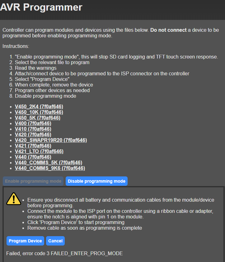

Now I’ve only managed to reprogram two of the 8 1.9f modules, on all the others I get the:
Failed, error code 3 FAILED_ENTER_PROG_MODE and fwiw I dont get the orange band on the top of the window saying I’m in programming mode, just a warning for say 15-20secs saying that some features are disabled while in prog mode…
Cables cannot be wrong as I managed to program one module twice and after a lot of fooling around and getting the same Error 3, managed a second one, wonder if I could do anything other than getting a dedicated programmer to do the job. Seems that whole setup is flaky…
cheers
V.
Have you tried rebooting the controller between programming? If it managed to do 2, I’m surprised the others didn’t work. Could the modules be bad?

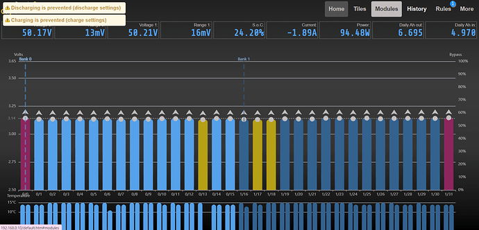

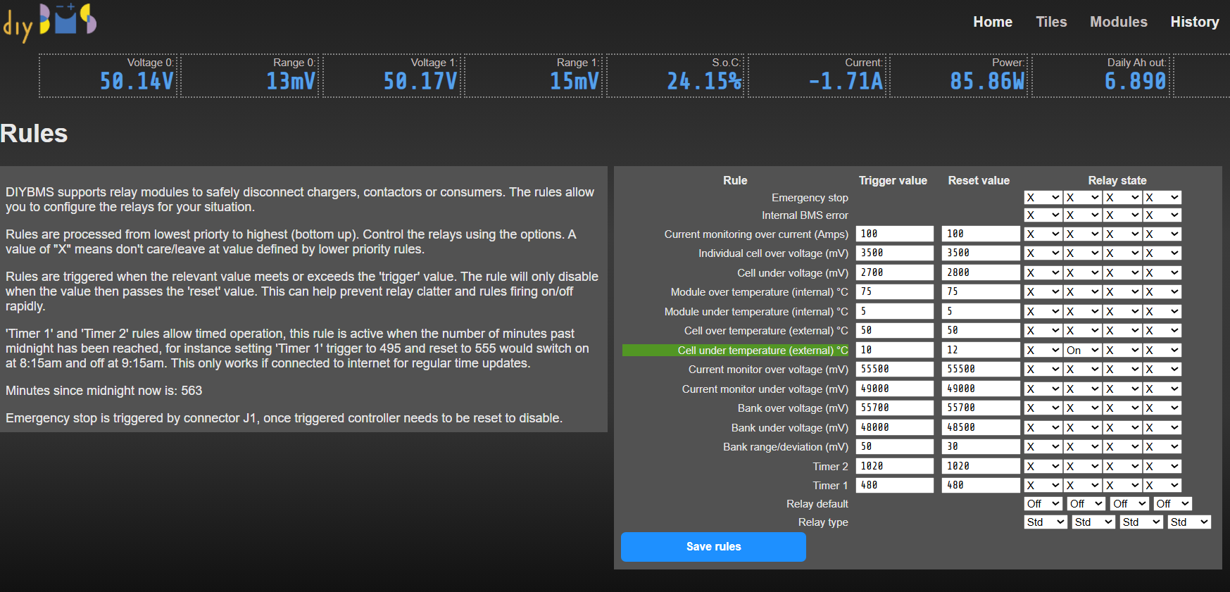

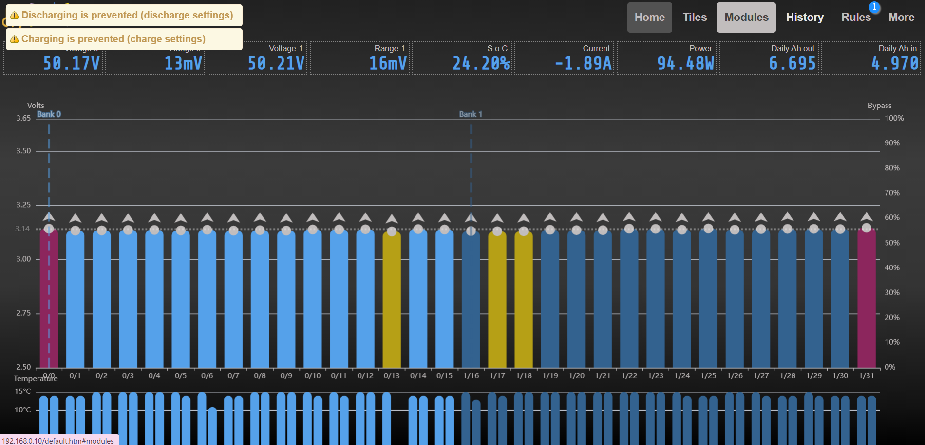

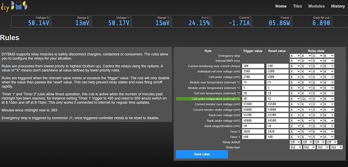

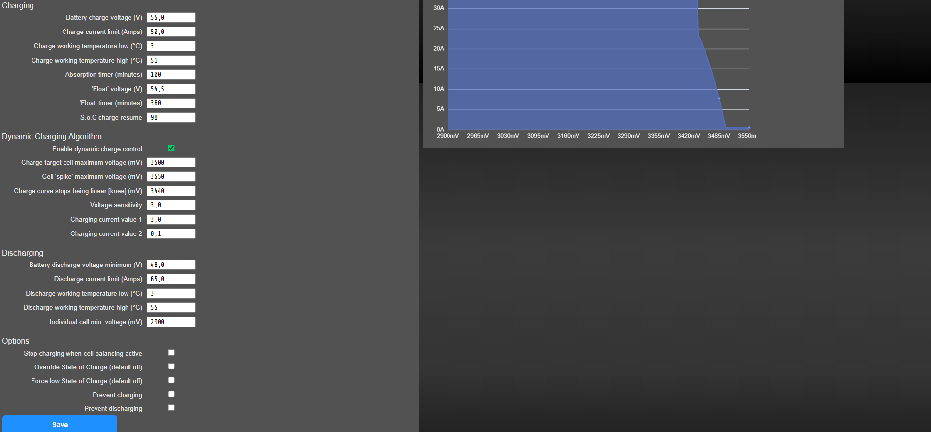

Hello, DIY writes me prevent charging and discharging. But I do not know why. Please can you tell me when I can found what do this restictions? Thank you very much.
Cells are reporting under temperature so charging is prevented. -
Thank you,
I hope I am not totaly wrong, but it seams that relay rules are not for relays only, but they are for charging/discharging rules too?
There are another temperature values, voltge values… at charging and discharging settings, these values does prevent charging and discharging?
If yes, then are there some rules twice…
Is possible to set somewhere, if relay rule will be conected to charging/discharging rules?
If not, is possible to add this to the firmware?
The project’s code is open-source, so anything’s possible :slight_smile: But you may have to DIY…
Don’t forget the pull request!
It should be great if I can DIY, but unfortunately I can not program this. :sleepy_face:
Yes, some of the rules also affect the charge rules, this was deliberate, but for the life of me I can’t remember why now! Old age!!
