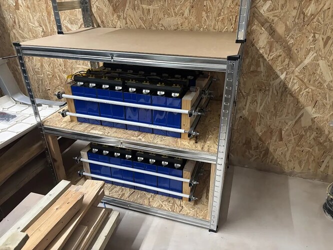

I bought a set of controller, 16S board and passive balancer from Stuartā€™s shop a while back and finally got around to setting it up. Iā€™ve got a 2P16S battery of EVE MB31 314Ah cells that i charged and top balanced by placing all of them in parallel for a few days. Unfortunately, my battery module insists that two of the cells are off by a 20ish mV and it really wants to balance them. Iā€™ve measured the voltages right on the 17-pin terminal block and they are all within a mV of each other. Also, the measured voltage for the rest of the cells is off (it should be 3.320V, according to my fairly good multimeter, not 3.327V). Calibrating the cell in the module configuration does nothing. Any good ideas?
Obligatory angry pixy porn:
Try removing the balance pcb. I have had to replace some mosfets on the balancing pcb. Due to incorrect manipulation, I have had measurement errors in the voltage, some cells were at 0mv and others had more voltage than the real one.
Thank you, that was it!
