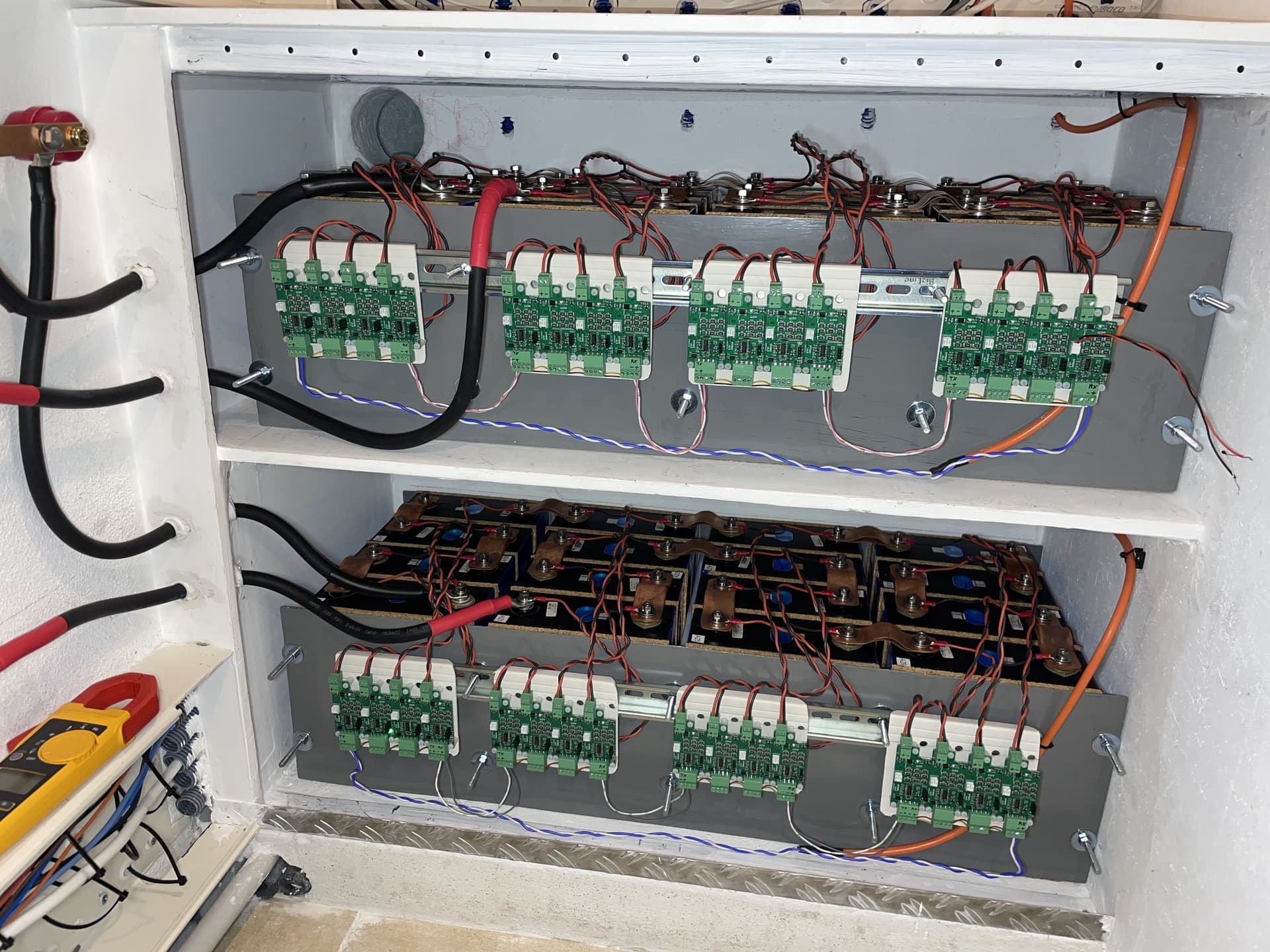

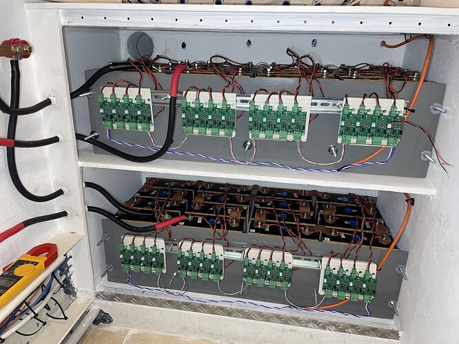

I’m looking at using diyBMS with an 18S LiFePO4 setup, it’s 4P totalling to about 840Ah off the top of my head. It’s going onto a Victron setup with a Multiplus 10000VA inverter, smart solar MPPT and Cerbo GX.
My question is, should i use just 1 module/slave board for all the 4P cells, or divide them in two or four and have multiple module/slave boards, for the paralleled cells.
Secoundly, I assume diyBMS is happy integrating with victron Cerbo? And if so, should i add a separate contactor for the batteries or is this not necessary normally?
Thanks!

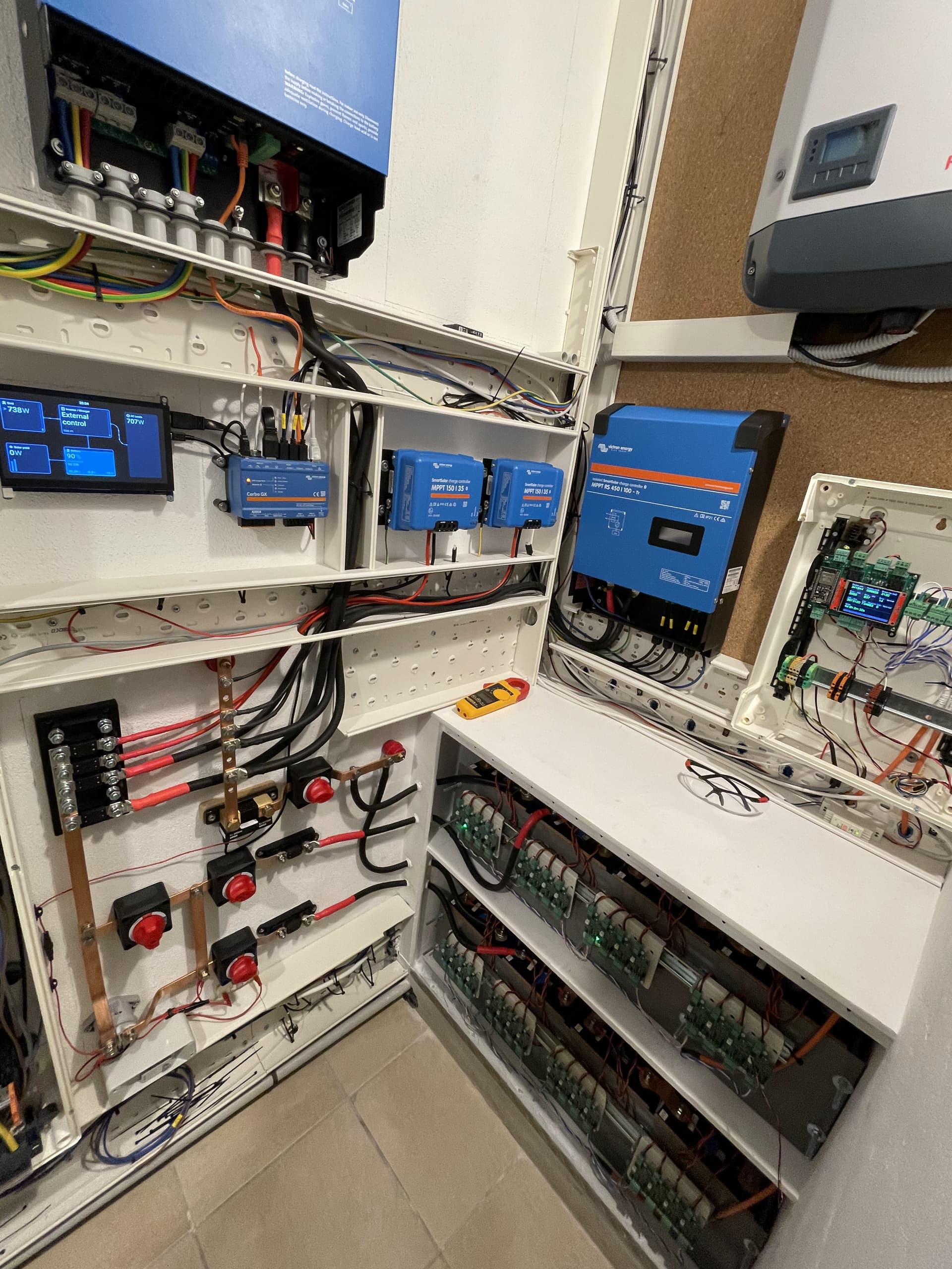

Because the batteries are in modules of 6S that can’t easily be divided up as they’re welded tabs. I’ve only just arrived at this installation but I’m rather worried it’s all too high voltage for the victron systems. I suppose that would put an absorption voltage of about 65V. Is that too high for victron stuff, I’ve not worked with Victron before. It’s a 250/100 MPPT.
This is far from the only 18s Victron system out there. As long as your solar array yields higher voltage than the batteries, you’re all good.

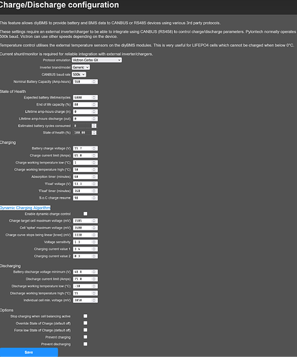

Hi, Everyone,
Thanks to all of you and Stuart especially, i realise the project of 32 cell of lifepo4 with the V4.5 modules. (I started to assemble the devices when the all in one was not available)
I’ve did few days only of testing and seems to work good.

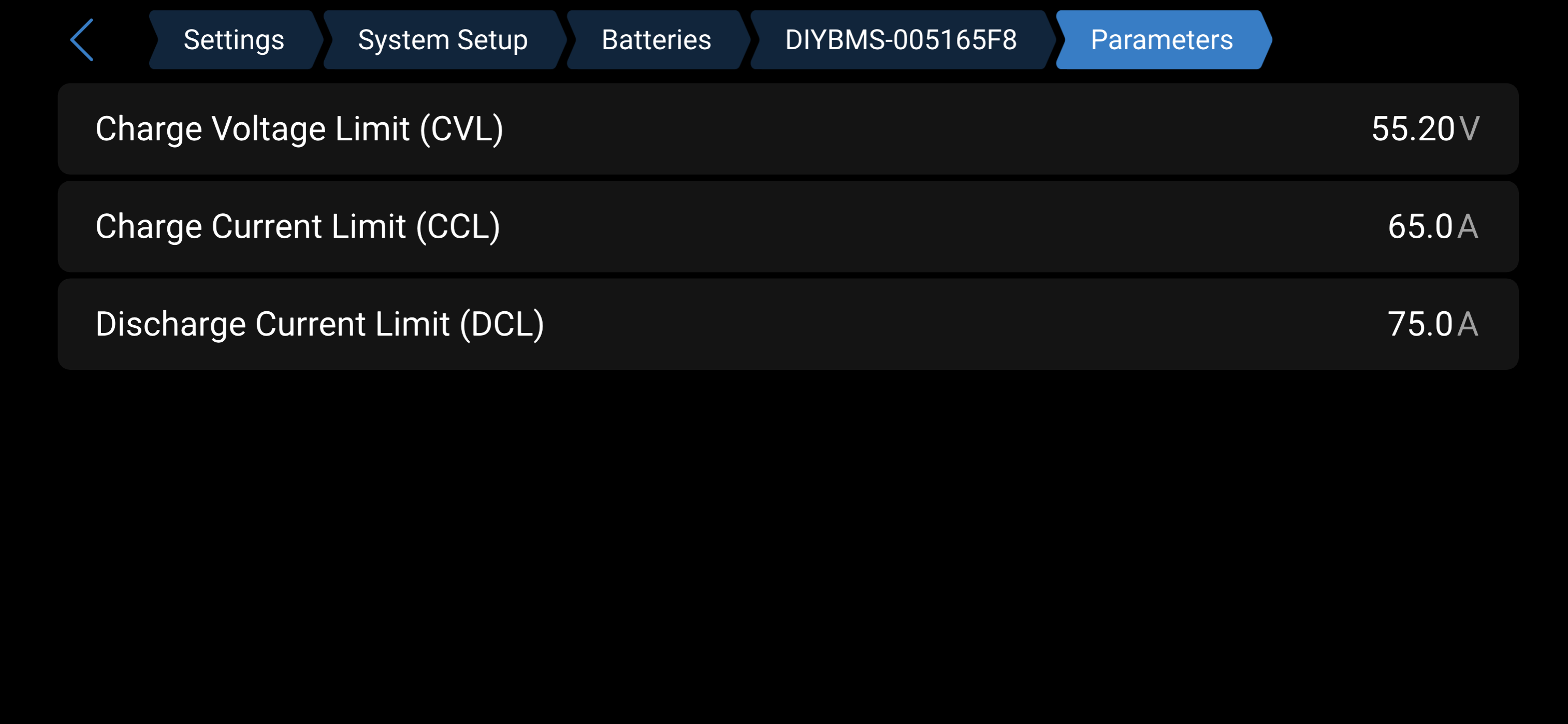

I Connected the Victron cerboGX to the diyBMS controller via CAN.
But i have problem with the ā€œDynamic Charging Algorithmā€.
If activated, during charging the charging stop for some short, see the Victron Smart Shunt monitoring current attach.
Seems the BMS sometimes send the value 0 to the Maximum current allowed for 1seconds.

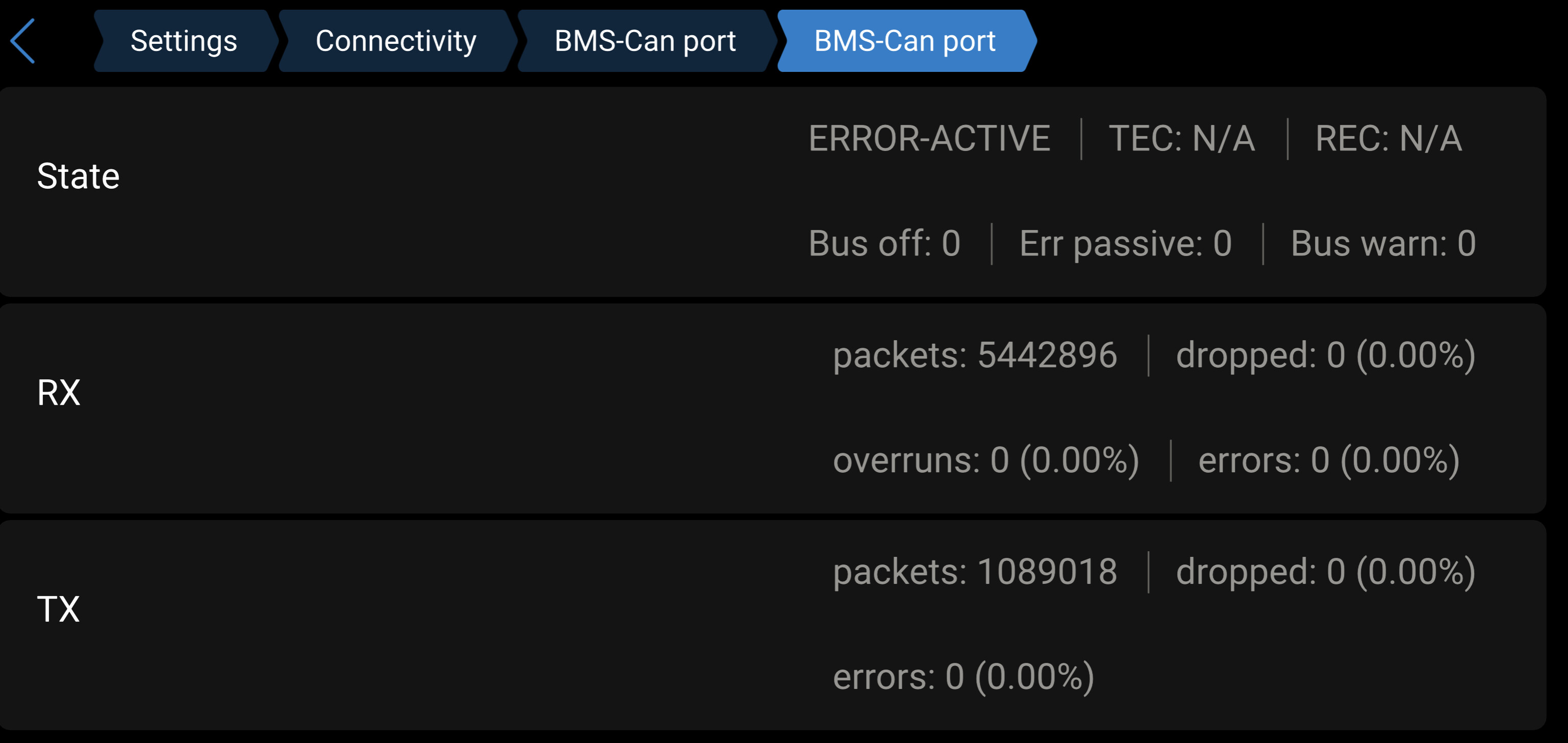

There is no CAN problem see attach.
There is no reset of the bms.
what about my parameters in diybms, are they ok ?
I don’t have diybms shunt, only Victron smart shunt.
Let me know what information i can give you more to help solve the problem ?
Thanks for help
Mickael

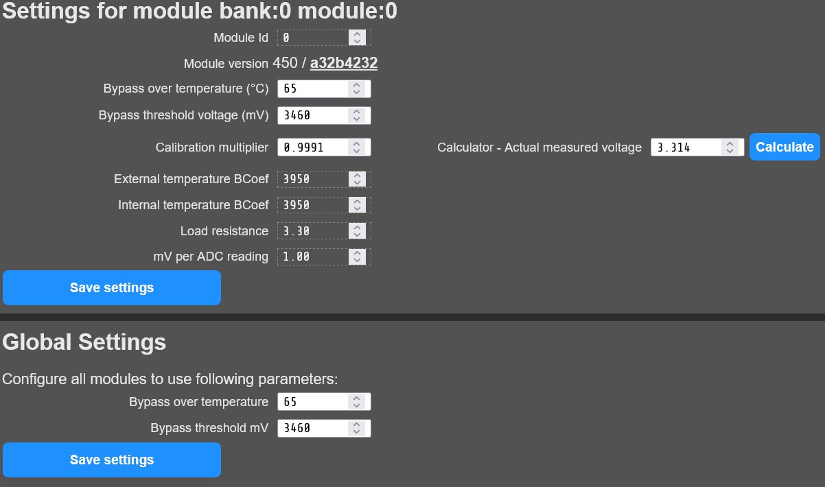

What did you enter as global settings for the modules?

In the Victron VRM portal, you can also view the CVL and CCL values under ā€œAdvancedā€. You could take a screenshot there.

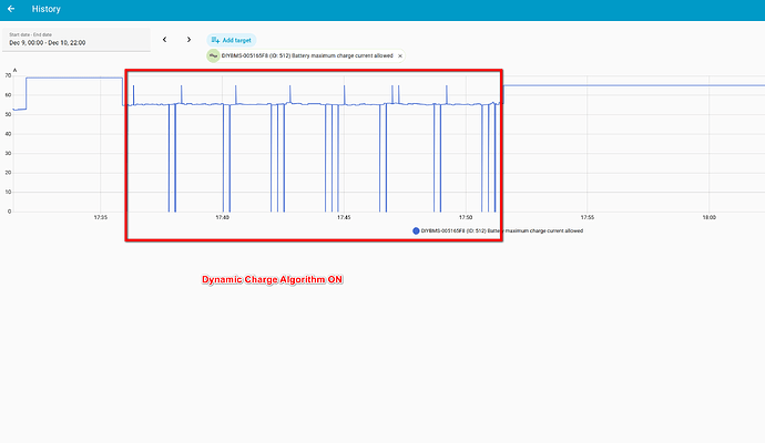

Hi, Thanks for reply
Here is my settings for module 1 but all the same for other module except calibration that i did.
CVL and CCL work fine and are updated good.
But when i activate ā€œdynamic charge algorithmā€ sometime CCL drop to 0 for 1second and the inverter instantly stop charging, and start again. We can hear a ā€œclackā€ noise in the Multiplus at this moment
I connected the diybms to Home assistant via MQTT and can see the value CCL drop to 1sec.
This problem happends since the first start of the installation.
To find the source of the problem i was thinking :
Why during normal charging (battery voltage at about 3,3V ) diybms controller could send CCL = 0 to the cerbo ?
Also is it normal that the display of the tile ā€œCharge modeā€ is always written ā€œStandardā€ ?
Best regards

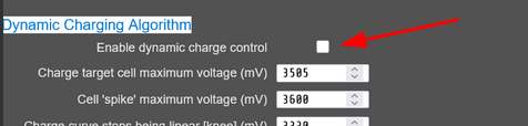

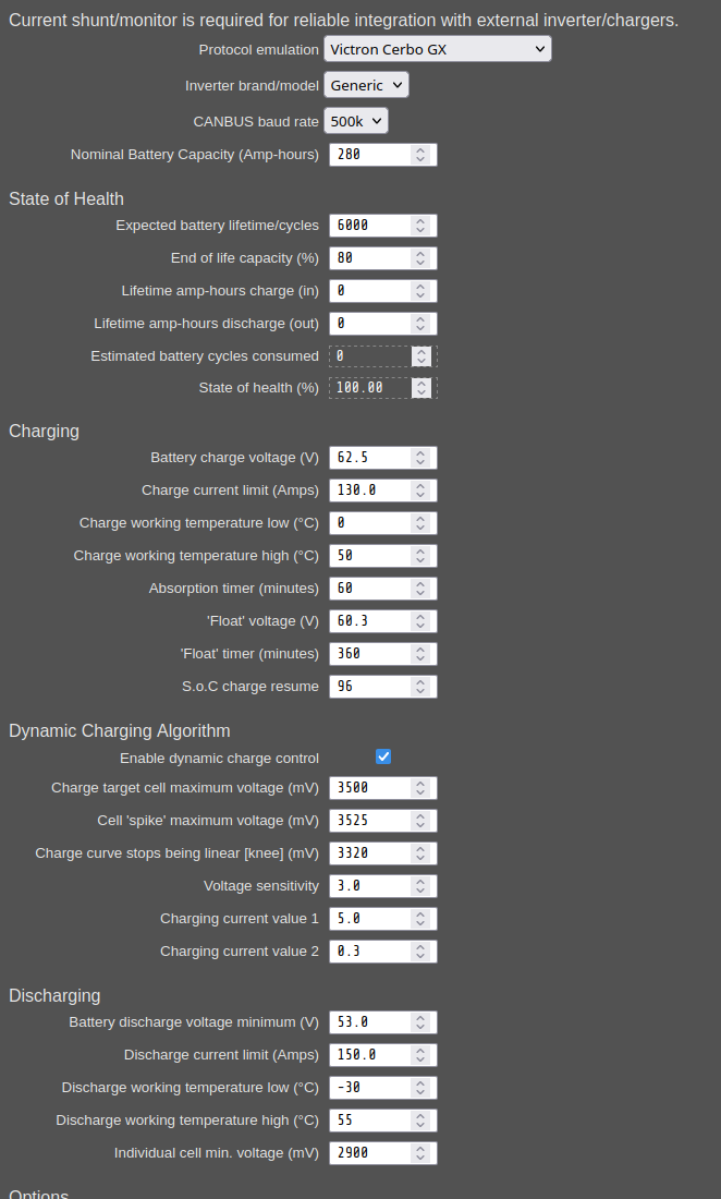

You have not enabled dynamic charging.

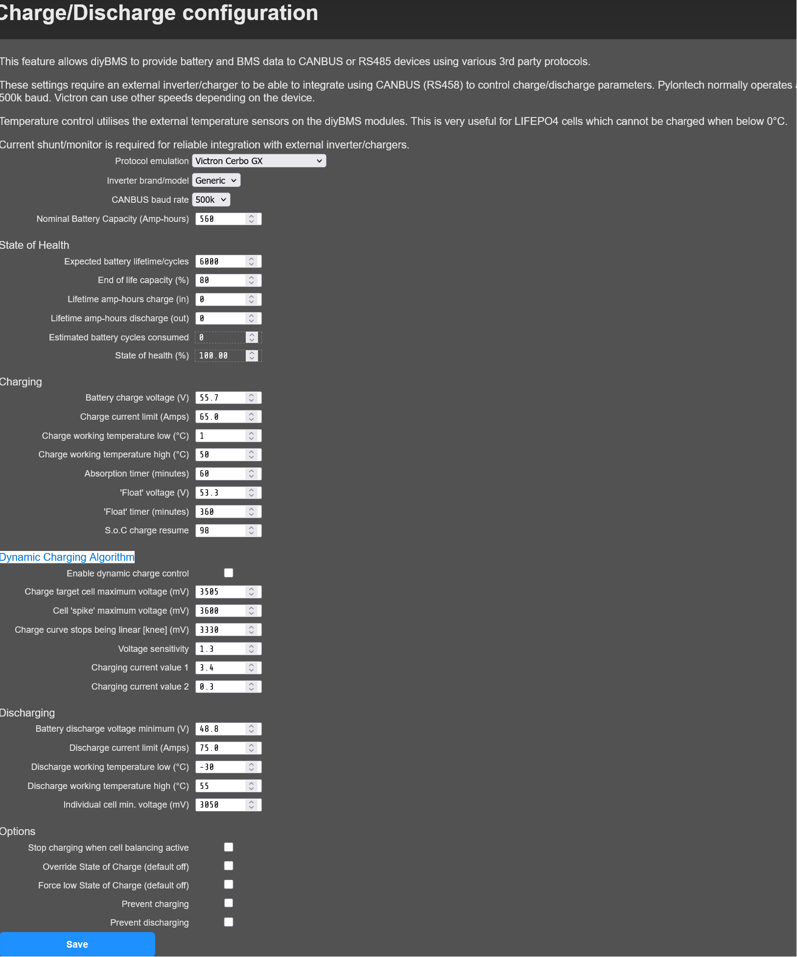

Here are screenshots of my settings. I have 18 cells, for your information.
ā€œCharge Modeā€ will not change for you, this only works if you use the DIYBMS shunt. Therefore, ā€˜Absorption’ and ā€œFloatā€ also have no effect.
Yes it is on purpose because i activate for testing only as i’m afraid my inverter will not like this if i leave for long time.
relay made noise when current drop so fast.
Thanks, i took my settings here from ā€œstuartā€

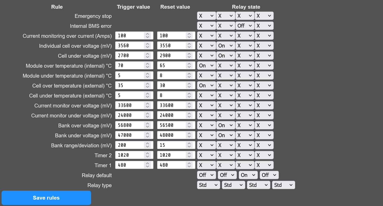

Do you have any rules that are triggering (temperature etc)?

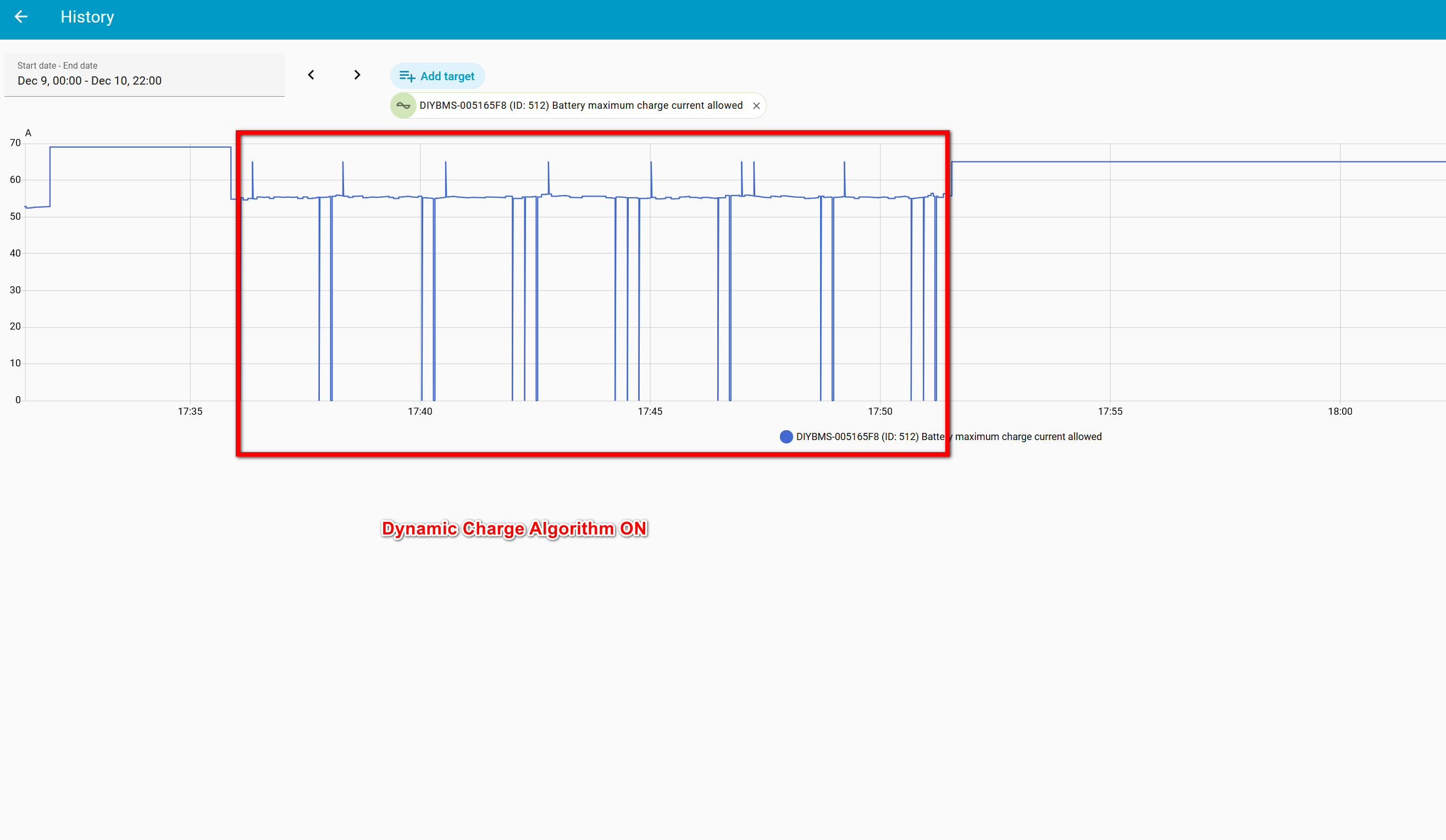

On the Victron Cerbo GX side, connected MQTT to home assistant, i found this graph where we can see this current dropping.
What do you mean by ā€œ From what I could see, the controller never sent the zero current setting ā€œ ?
On my picture graph we can see ā€œBattery Maximum Charge Current Allowedā€ dropping to 0 many times
If you saw this on the CAN bus it means this value come from the ESP.
Maybe a variable in the calculation that could end up to send overt the CAN bus ā€œBattery Maximum Charge Current Allowedā€ = 0 sometimes ?
Let me know what loggin i can do, problem happends instantly as i check dynamic charge algorithm.
No no rules

There is a check in the code which runs before any data is sent on the can is - it basically checks the BMS is in a safe position/configuration including the rules.
If this is fails it’s checks it will default to ā€˜stop’ charging - I’m wondering if this is what you are seeing, something isn’t happy!
Although you don’t use the rules with the relays, the logic in them is used for this check, so make sure they are configured with meaningful values.
