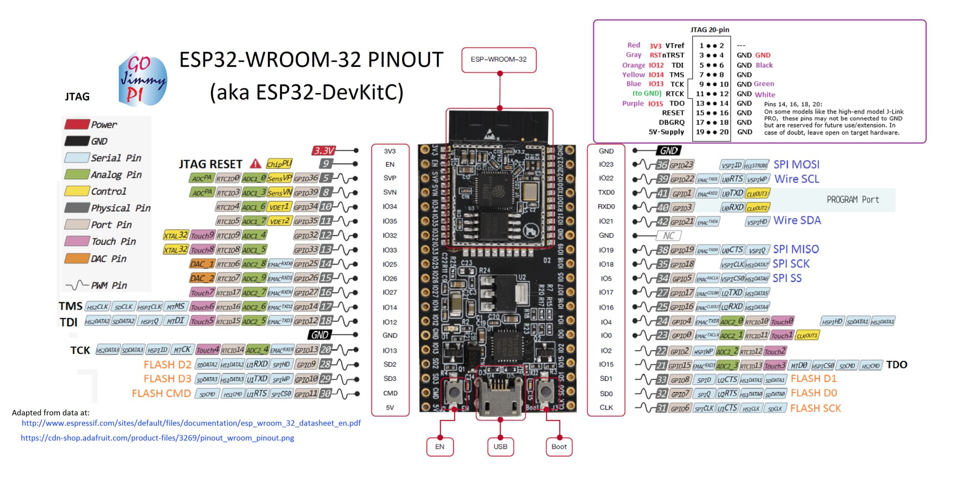

Hi @Tim_Kelley you need the ESP32 thats got the same footprint as the “DEVKIT-C” layout - these may be more suitable Amazon link

Hi all, I am getting an error after writing the controller firmware to the esp32 and rebooting. I have used different cables (but the same PC) and even different releases of diyBMS. No luck. I purchased the following:
https://www.amazon.com/dp/B08M5Q1DZF?psc=1&ref=ppx_yo2ov_dt_b_product_details
and
https://www.amazon.com/dp/B08HMJ1X6W?ref=ppx_yo2ov_dt_b_product_details&th=1
Programming finishes fine both connected and disconnected from the controller. Any suggestions on a next troubleshooting step?
I am running on the assumption that my esp32s have hardware that isn’t compatible with the controller (“TCA6416A Not Fitted” and “TCA9534APWR Error”) and have to take another shot at buy more esp32. Please tell me I am wrong.

Hi Tim, has the controller board ever worked (with any ESP?) it could be a bad TCA chip or poor soldering?
Check the pins on the ESP32 to ensure they match the footprint like below…
I get the same error when I am in putty without being connected to the board, One of my ESP32s worked with my old v4.2 controller before I made smoke, so I cannot confirm that it still works, but I can confirm that none of the batches (4+3) that I ordered work with any of the 5 4.6 boards I have. I soldered SW1 and SW2 on - I am not sure what they are for, but I since I had the iron out, I figured why not? I have also jumped JP1. I am booting w/o an SD Card, and both with and without a TFT.
I was able to get some nonstandard (narrower) esp32s to work with the board for a time, but the TFTs cause them to go into a boot loop. My best guess is something is soldered on backwards or the wrong part, that is causing the ESP32s to die. Without a known good, is difficult to troubleshoot. Any suggestions are welcome.
