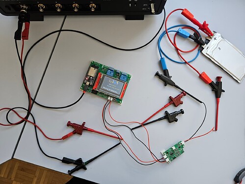

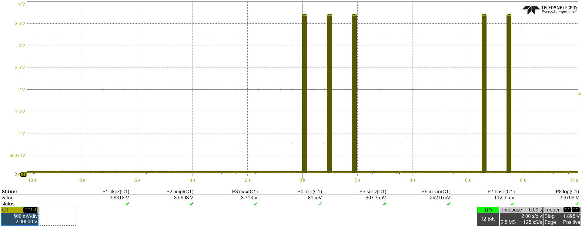

I have the following problem and can not solve it for four days:
The modules are not recognized. The controller stays in the “Waiting for Modules…” state and sometimes restarts.
Initial situation:
  • Controller & modules (V4.5) partially assembled ordered from JLCPCB - Only Attiny1624, INA229 & connectors soldered by myself. I checked the solder joints and alignment of the ICs and could not find any fault. Component D2 on the modules has the correct orientation.
  • ControllerBoardTest program loaded on board via PlatformIo. The boardtest was successful incl. Tx & Rx communication (Led flashes green at the end and relays switch every second). No errors appeared in Serial Monitor).
  • Website is accessible and settings can be made.
  • Modules were programmed via an Arduino Uno with AVRDUDESS. (according to the manual DIY UPDI USB programmer which can be made with cheap hardware)
    Firmware: module_fw_V450_10K_ATtiny1624_450_e0_h0_l0.hex
    I also wrote a blink program for LED D4 on the module to test the UPDI programmer. Worked with every module.
    When module is attached to power supply, LED D4 blinks four times, then twice every 8 seconds. As soon as the controller is attached the LED stays off.
  • Tested with 10 modules (either in 1S1P or 2S1P configuration). Tx to Rx rule was followed for the cables. Tested with and without temperature sensor connected.

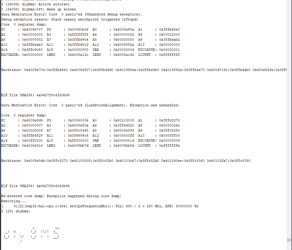

  • Controller randomly restarts at least every 2 minutes (it doesn’t matter if a module is connected or not) after the following error code:
    Guru Meditation Error: Core 0 panic’ed (Unhandled debug exception).
    Debug exception reason: Stack canary watchpoint triggered (tftupd)

What I have already tried:
  • Programming the ESP32 several times via the Pyflasher with the latest firmware “esp32-controller-firmware-complete.bin” (Compiled_Firmware_2023-09-12-10-49). I also tried with an older version, doesn’t work either. Controller firmware upgrade via the website with the file “esp32-controller-firmware-over-the-air.bin” did not make any difference either.
  • Programming the modules several times with the versions V450_ 2K4, 5K & 10K.

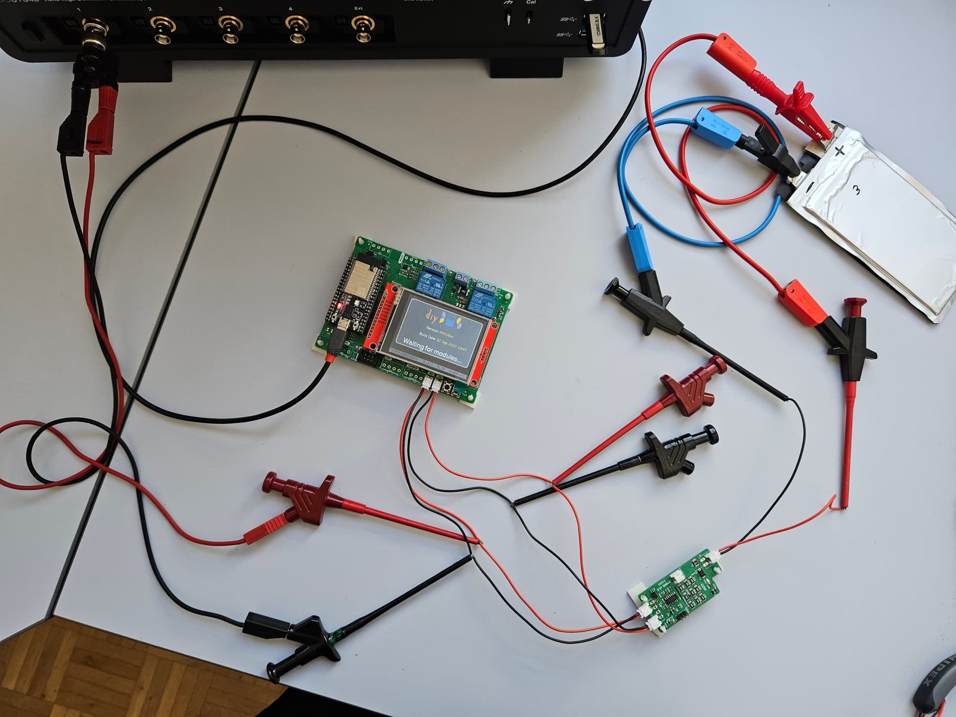

  • With an oscilloscope I tried to narrow down the error via the Tx/Rx communication:
    1st measurement: Direct connection from Tx to Rx at the controller: Transmission is OK (With test program, as well as the normal program).
2nd measurement: Between controller Tx and module Rx: Transmission is OK
3rd measurement: Between module TX and controller Rx: Voltage remains stable at approx. 3.3 V. Signal is not transmitted.
So it is clear that something is wrong with the module.
Do you have any tips what I could try to fix the error with the controller and the error with the module?
I will also try the UPDI programming via a USB-Serial FTDI in the next week, as soon as I get the material.
If you are using the 10K firmware on the module, are you also selecting 10K on the communication speed in the web interface?
Likewise, select the total number of cells you have.
You shouldn’t be seeing the frequent reboots.
The nvs not found messages indicates that you have not saved any settings yet - including the baud rate/communication speed
Solved
It was the communication speed, which i didn’t set in the web interface (More → Settings → Modules & Banks). I set it to 10K and it worked (with the matching Firmware installed: module_fw_V450_10K_ATtiny1624_450_e0_h0_l0.hex).
Since then there are also no restarts of the controller.

That could be a faulty esp32 to cause problems so early on boot up
I am getting a similar error. I will reflash another esp32 and let you know how it goes.

PC      : 0x4008e502  PS      : 0x00060336  A0      : 0x4008552a  A1      : 0x3f                                                                                                                          fb4700
A2      : 0x00020000  A3      : 0x0002e000  A4      : 0x0000a000  A5      : 0x00                                                                                                                          000000
A6      : 0x00ff0000  A7      : 0xff000000  A8      : 0xa0000000  A9      : 0xe0                                                                                                                          000000
A10     : 0x0000001c  A11     : 0x00000000  A12     : 0x00000000  A13     : 0x00                                                                                                                          000000
A14     : 0x3ffc9c50  A15     : 0x00000000  SAR     : 0x00000004  EXCCAUSE: 0x00                                                                                                                          000001
EXCVADDR: 0x00000000  LBEG    : 0x4008a12c  LEND    : 0x4008a142  LCOUNT  : 0xff                                                                                                                          ffffff
Backtrace: 0x4008e4ff:0x3ffb4700 0x40085527:0x3ffb47e0 0x4019f8ee:0x3ffb4af0 0x4                                                                                                                          019f92a:0x3ffb4b80 0x400d715c:0x3ffb4bc0 0x400e543e:0x3ffb4c30 0x400e5588:0x3ffb                                                                                                                          4cb0 0x400e5da7:0x3ffb4d30 0x400e610c:0x3ffb4e80
ELF file SHA256: 4a9427f9c4320b96
Rebooting...
ets Jul 29 2019 12:21:46
I solved the problem by replacing the esp32 with another
Are you using the SD Card slot on the TFT screen ? That can sometimes be the problem.
No. But I think I found the problem: The ESP32s I ordered (https://www.amazon.com/dp/B0B3JF5H4M?ref=ppx_yo2ov_dt_b_product_details&th=1) all seem to have the same issue.
