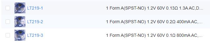

no stock of the LT219-1, are those other ones compatible?
lt219

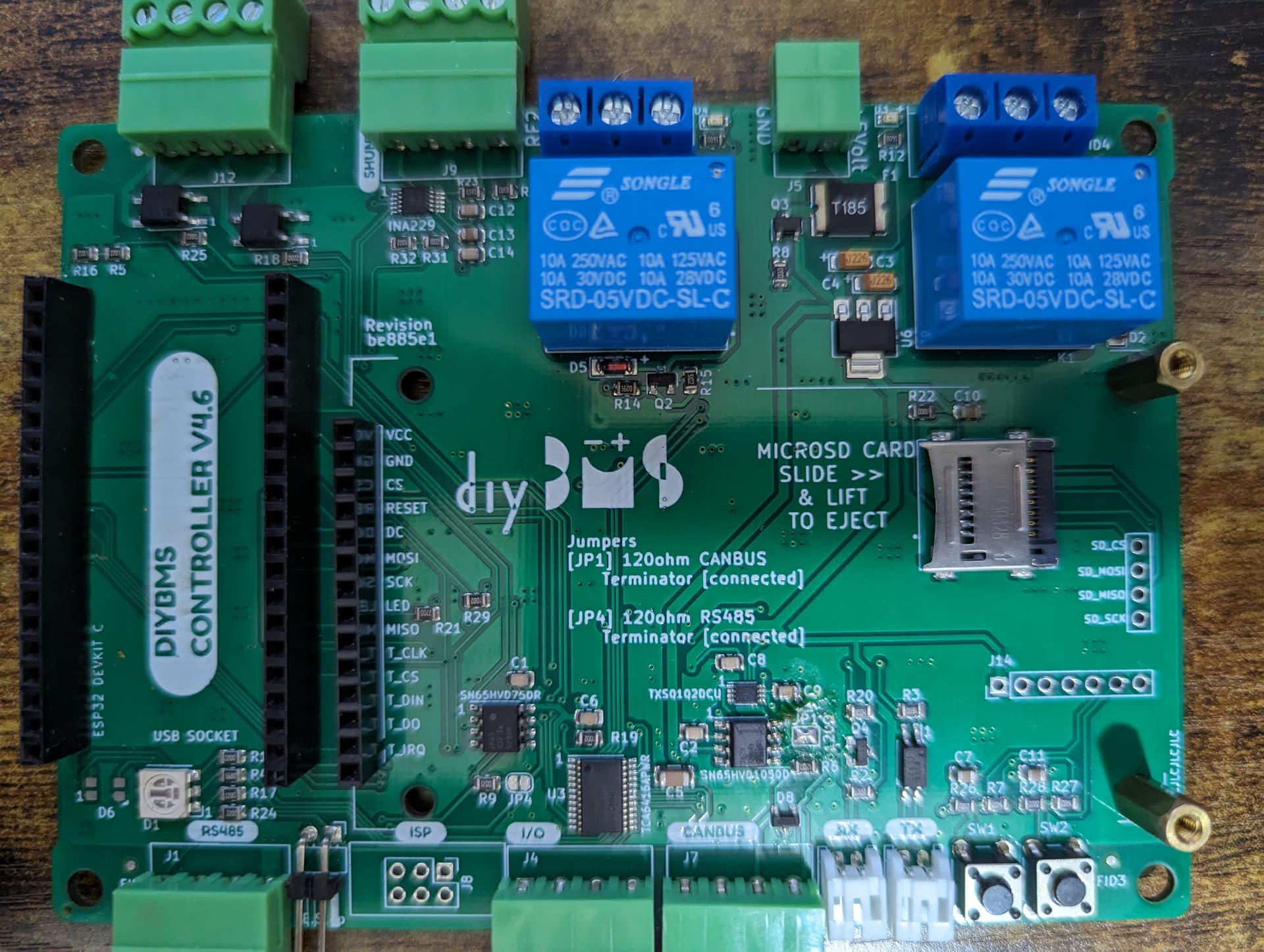

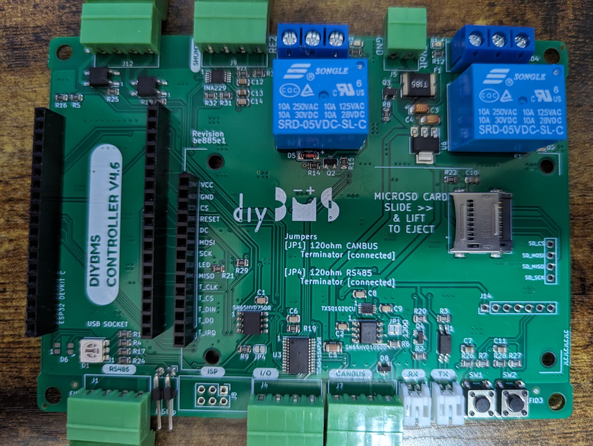

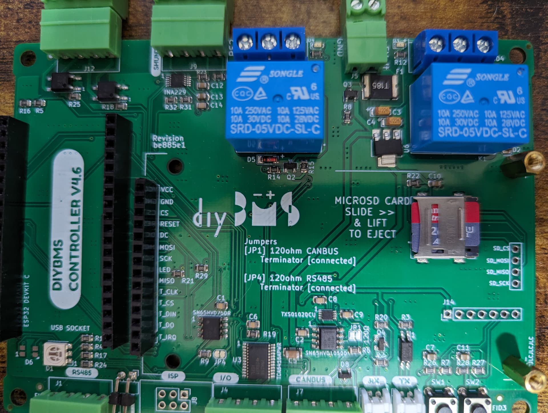

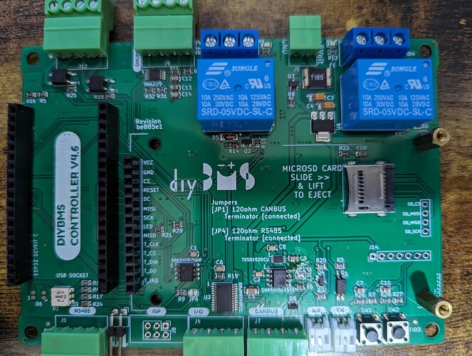

Can you get some high res photos of the v4.6 boards you have so I can cross check?
shipping discount of up to 15$
A release today should fix this problem - it only appears to occur on newer revision 3 ESP32 chips.
You can upgrade as usual from GITHUB.
Here are 3 of the boards from a batch of 5 assembled by JLCPCB giving the error. One from this batch works; I have not soldered up the 5th.
Did you solder on the SMD parts as well? I’ve released new code today which should solve the TFT issue, but you were still getting issues with i2c communication so that’s either a bad TCA6416 chip or a bad soldering joint near that chip.

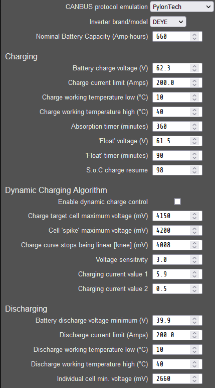

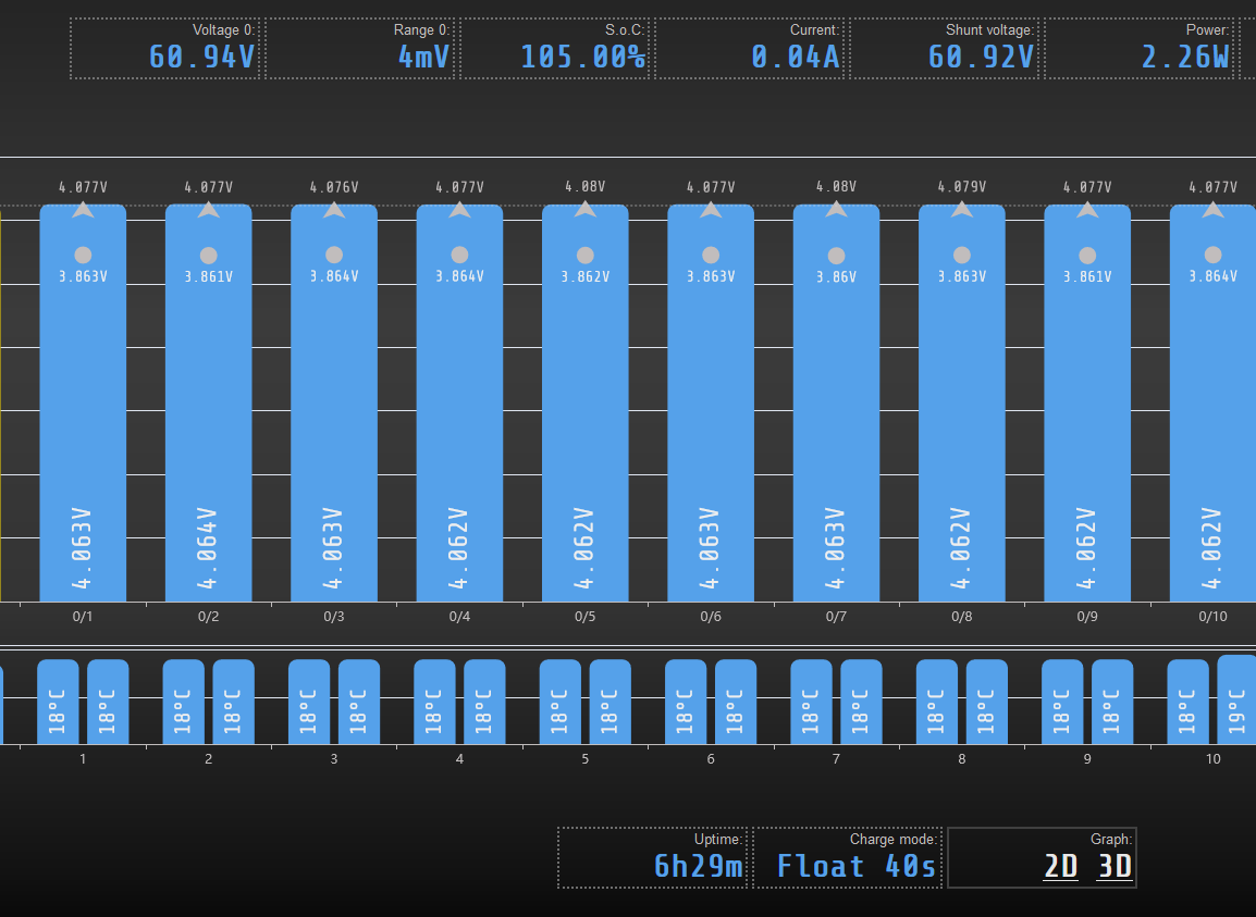

I have a problem with the Deye inverter and the BMS but I think I know now why the Deye does strange things.
I think the reson is that the Deye get via Can the information from the BMS that the SOC is 105%
I have NCR18650 Cels with a voltage range of 2,5 to 4,2V and 15 in series so voltage range is 37,5 to 63V
The actual voltage is 53,8x V, the BMS think that the SOC is 105%
How is the SOC calculated?

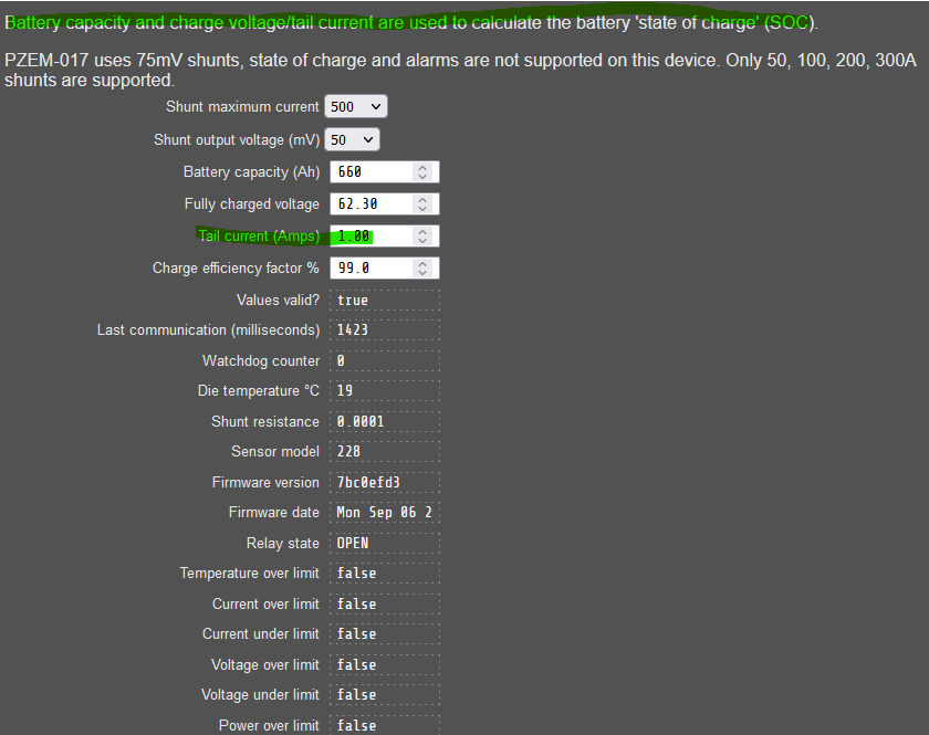

It maybe hase somthing to do with the Tail Current. I dont realy understand what a Tail current is. I thougt that this is the minimal charging current when the charge voltage is at max.
The datasheed of my cells say Charge Cut of at 4,2V and 65mA → 15*65mA = 1A
My setings:
i have set my tail current to 10A
I had the tail current before at 13A, was the same.
Battery got discharged during night and is now at 52.84V → SOC is still at 105%
Its geting charged now (Deye is set to V-Bat)
Values at 0755 - look on the Ah out and Ah in
and now 5 minutes later

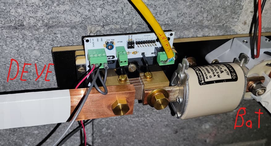

well I think I have to turn the shunt. Then the power input is input and not output :slight_smile:
Dam, if this is, and I think it is, realy the reason it has cost me quit a lot of hours.
Just looked on the second board I have and there is such a nice silk screan text I totaly ignored (OK the shunt cover it).
The SoC is calculated based on amp-hour (energy) counting, as you have seen looks like the shunt battery connection is round the wrong way, a negative current reading is for discharge of the battery.
The SoC has a hardcoded limit of 105%, because it is possible to go over 100% until the system is calibrated properly and the first “real” 100% charge is reached.
I would set the tail voltage and current to be just under the maximum “battery charge voltage (V)” value - so 62.2V and I would also set the tail current between 5 to 10 Amps.
Once that voltage/current combination is reached the shunt will reset to 100% - although due to the way the system works (taking into account the “Charge efficiency factor %”) you will probably see 99%.
You can also manually reset the SoC using the settings in the “Utilities” page.
I would also recommend updating the shunt firmware if you are taking it apart.
THX.
I changed the shunt connection and now it look much better
one step closer to get the BMS working with the Deye.

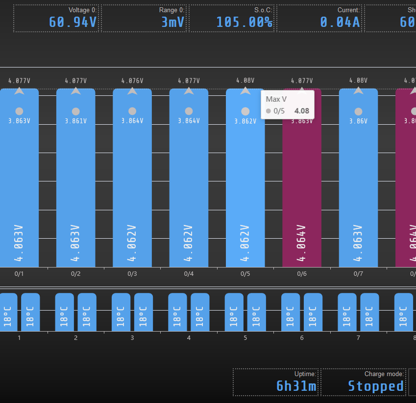

Float has just finished and status changed to stopped but the SOC is again 105%
Is this related to the Voltage of 60,94V witch is lower than the “Fully charged volate” of 62,3V?
