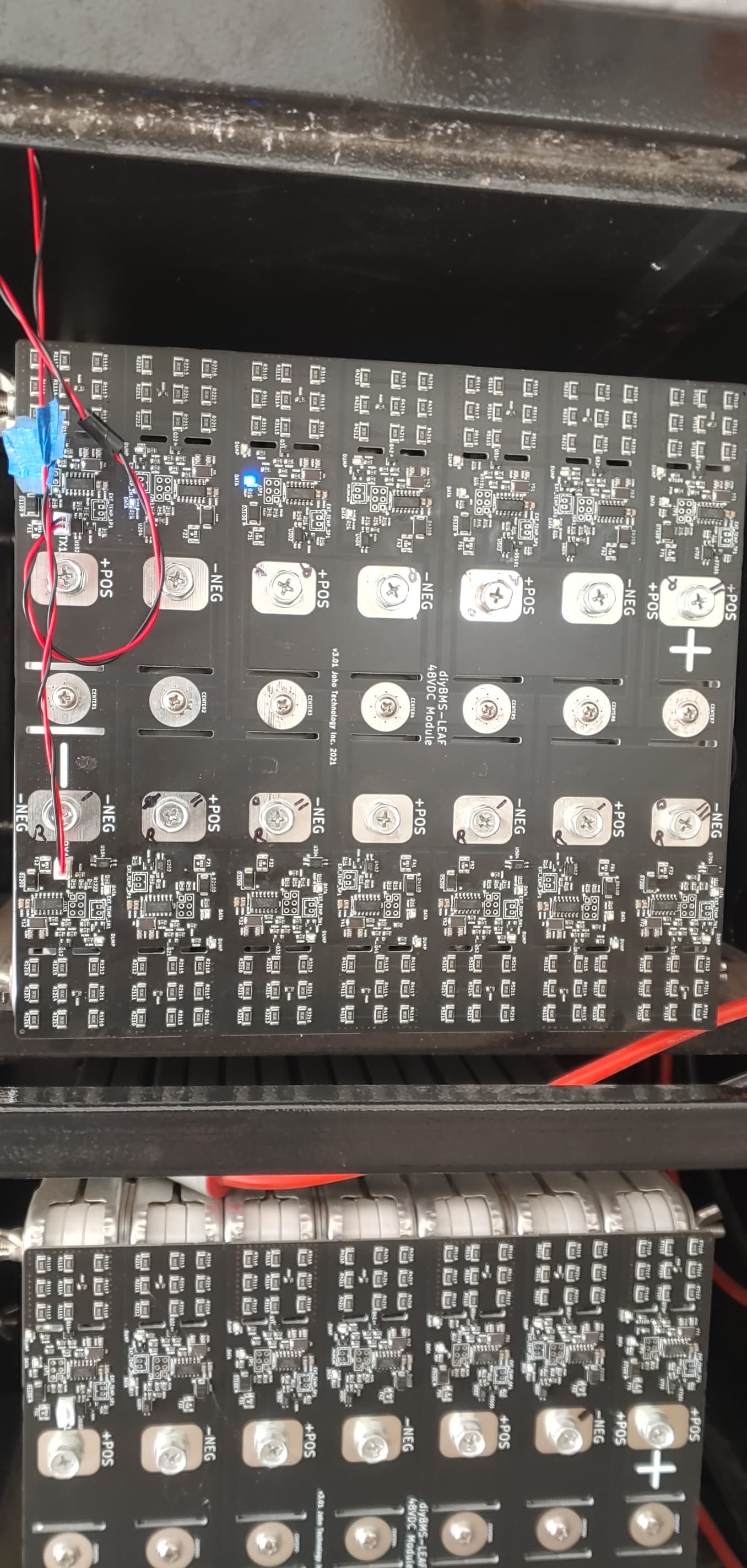

So I’ve been around here for awhile but I finally got around to working on my setup again and I have a problem with OOS and possibly bad CPU’s. Does anybody know how I can debug this reliably? I have desoldered and installed a lot of new cpus and I almost have an error free board but I’ll get random Oos. Is there debug code that can tell me which module communications stopped at? If communications couldn’t finish its trip?
It’s a unidirectional loop, so no there cannot be any debug code to show where comms stop, at least not when it’s completely broken.
Otherwise, well, you already have per-module packet counters and can infer from them where an intermittent error is located.
I was thinking about implementing like a timer in the code to trip if communications weren’t received in a certain amount of time, then add it to the information on the next comms trip to be recorded in the log. Seem viable?
You don’t even need a timer. Just check the sequence number for gaps.

I just found I get a lot more info on the PC browser than my phone. What can you tell from this? #2 I have installed a new CPU and a different optoisolator, same kind just from another board. These oos and crc mainly happen when the board is in bypass. And when I say #2 I mean physical #2 so #1 in the Pic, it wasnt passing the packets from #1 to #2 but after the new CPU it seems to pass them along but still losing packets. I am using these boards created by Allan Lind who tells me his are working flawlessly.
So I just replaced CPU’s #0,1,6,10,11
No more crc errors, now only OOS.
Also I’m using the 9k6 comms speed.
