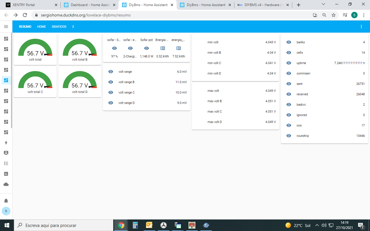

what is your round trip time with all this modules?
Hello Dan, 10400
Here’s a screenshot of what’s happening right now, the modules are in full balance work!
10second response time isnt that too slow?
56 modules… all in series, not much to do. But in practice, it works very well and I don’t see a great need for more speed, because each module is autonomous in balancing.
