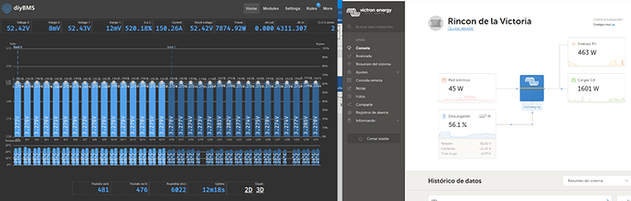

Problems with shunt and readings.
We start from here.
The shunt has a 500A 50Mv Shunt Resistor installed

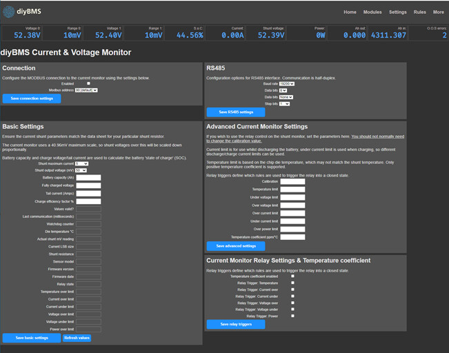

When I open the shunt configuration screen, the basic parameters option does not always appear.
If I activate the connection, I start to have data from the shunt but it does not mark any current or power, and the option of the rest of the configuration does not appear
I open the browser again and now I have the option, but always with this data:
When I try to record this data that is what I understand is the proper configuration:
And save them
I start to receive data, but wrong
Example:
Current 150.26A when the Victron System tells me about 21.5A
And on the other hand, the SOC goes from 44.56% to 520.18%
While obviously, the high amperage alarm is activated
On the other hand, if I reopen the shunt configuration, instead of presenting the recorded data, it returns me to the default Shunt data of 5A and 50mV
What could Stuart be going on?
I want to start communicating the BMS with Victron, but I can’t do it until I have reliable data through the Shunt.
your shunt isnt working, the data boxes below should have information in them, what are the lights doing on the shunt? red light flashing or green
lo siento , no tengo acceso visual al Shunt daba por supuesto que estaba correcto , tendré que acceder al shunt y verificar.
Google Tanslation:
Sorry, I do not have visual access to the Shunt, I assumed it was correct. I will have to access the shunt and verify.
[Moderator - RW]
I have been able to verify it, I have restarted the shunt and after a few green flashes, the red led remains fixed and the green one flashes every 5 seconds. But I don’t know what it can mean
That sounds normal.
The green led indicator is for communication with the controller.
The red led indicates when a shunt reading is taking place (flashing) or when solid indicates a rule has triggered.
The problem you have with the controller web page could be a JavaScript error, can you see any errors in the console? (Press F12)
I have tried another shunt and I have the same problem, the configuration values are not saved, I suspect it may be a firm corruption problem, tomorrow I will try to install the shunt firm again (latest version and we see results) .Thanks Stuart
I doubt it’s a problem with the shunt, probably firmware in the controller.
Please use the precompiled versions from GitHub and follow the instructions over there.

Indeed, I have tested in the test panel with a new firm for both the controller and the shunt and everything is perfect, now I will have to reprogram the shunt installed in the battery. Thank you all
