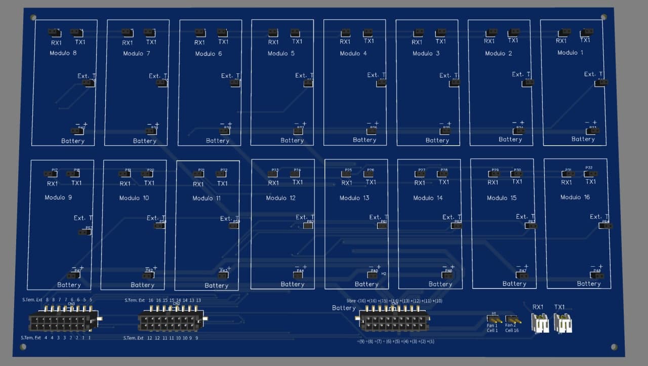

Looks good, but how does the heat on balancing is transported away?
I think you plug the modules upside down onto your PCB, is this correct?
If yes, the heat is locked between module and your PCB.
And I canā€˜t see if you use common wiring or direct 1:1 (every module has its own direct connection/cable +/- to the single cell)
This board is in its initial design phase.
The modules are placed with the resistors facing the outside, the idea is to add a system of fans to cool it, in fact the reason for integrating the 16 modules together is to facilitate the cooling of said modules.
The battery connections are made with 17 cables, the union of a battery with the previous, negative with positive, is used so that each cable that reaches the board, serves as a negative of one cell and positive of the next
