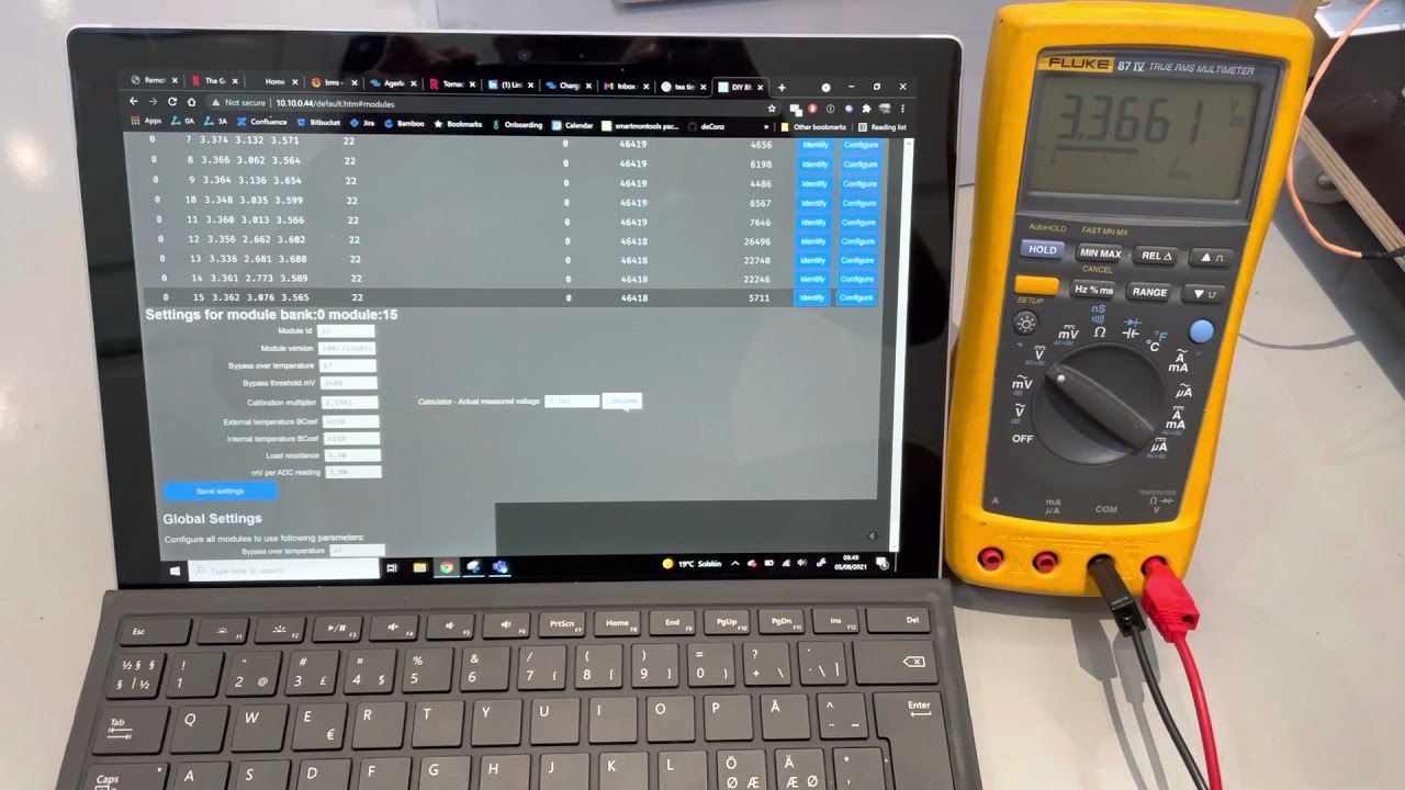

I am running the old controller with v4 modules. I see fluctuation on the voltage readings, see this video, is that normal ? You can see the readinf from the fluke meter which seems to be stable. As far as i can see all modules reacts the same, maybe it’s normal. I am measuring on Cell #15 with Fluke so it’s the one selected in the UI.
FYI: At the time of the video battery was beeing charged with 10A which is nothing compared to capacity of 160Ah and batery was around 60% SOC
I think diybms works in that way. The same occurs to me.
When did you build the V4 modules? There were reports of a bad batch/inaccurate tl432 chips, which are the main voltage reference.
my voltages also vary even when not charging but only a few mv.
how accurate is the module if you add 0.001v will it actually go up 0.001v?
My multimeter reads 0.025v too much right at the max error on the datasheet 3%.
No it’s not that accurate, from memory the module resolution is 0.004V, or 4mV.
i understand that is why it jumps ± 5mv when calibrating, if the reading goes up 5mv while you type you will be out by 4 or 5mv because it jumped to the next value.
