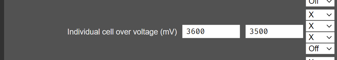

I have a 16pcs 160Ah LiFePo4 and the batteries are all in series to create a 48v battery bank, because i didn’t do a top balancing before i connected all batteries together like i should diyBMS struggles to balance at the same time the charger pushes 50 or more Amps to the pack, because of the long turn around time e.g 3s in my case cells can get dangerously high in voltage BEFORE the BMS turns things off. Because diyBMS can only tell my charger turn off or turn on and cannot adjust charge current one need to be careful not to destroy the cells. I had one cell get momentarily to 3,9V which is way to high for a LiFePo4. My rule is set at 3,6V but again because of the turn around time the voltage can still rise in those 3s above set rule.

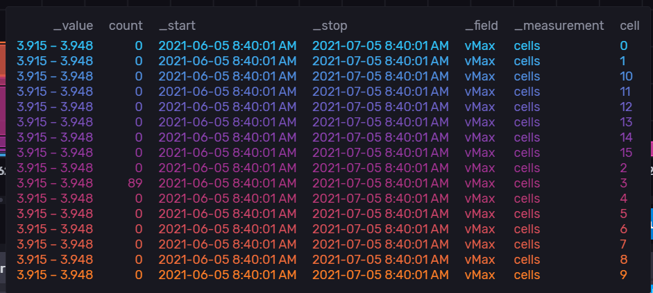

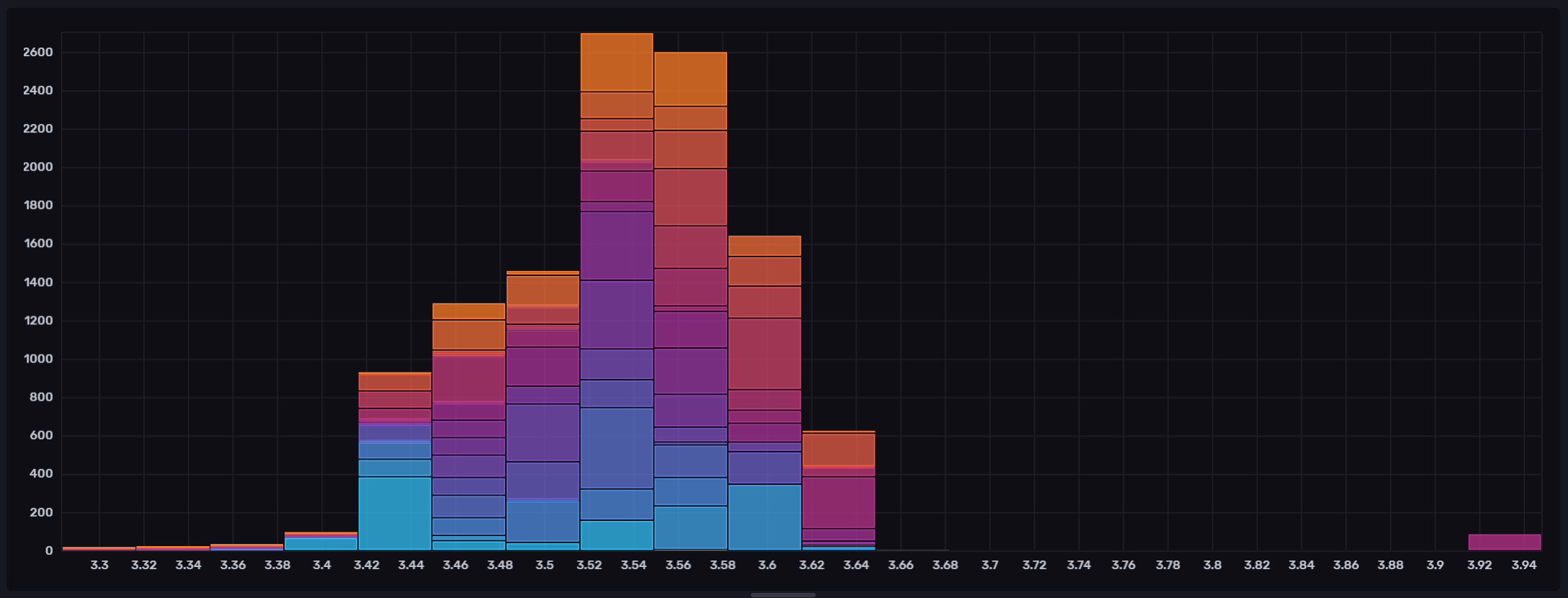

I sat down to investigate the max and min voltage of all cells so here is a histogram of max voltage from last 30 days :
As you can see something stands out on the right, looking into that :
it’s clear, that this (cell 3) is the only cell reaching this high from all the cells.

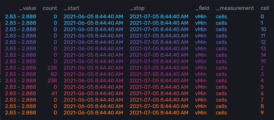

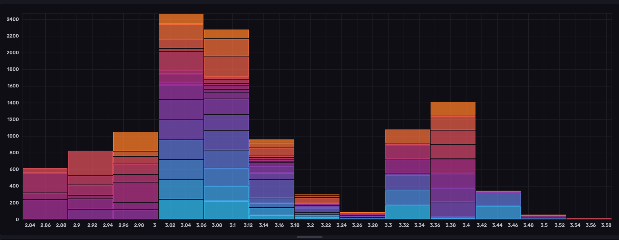

Looking at the min values in the same timeframe it’s not a clear picture anymore :
the lowest values in details :
as you can see more cell go down to the lowest levels.
I am not sure i can conclude this is a aged cell or something else.

this is not an issue with diybms in special. you will see this issue with every bms. You won’t find any which can burn 50 amp!!! Do a thorough top balancing!
You can set max charge voltage to e.g. 56V and start balancing at 3.5V. By that, charger will reduce current when getting near 56V and bms has a chance to burn off excessive voltage of individual cells…
No one is saying the BMS is suppose to balance 50A ! I understand the shortcomings such as only one 1A balancing current, the issue here is that when charger pumps 50A it takes in worst case 3s (in my 16s case, if you have more cells then this number is higher) before BMS reacts to the high cell voltage, one needs to be aware of that.
