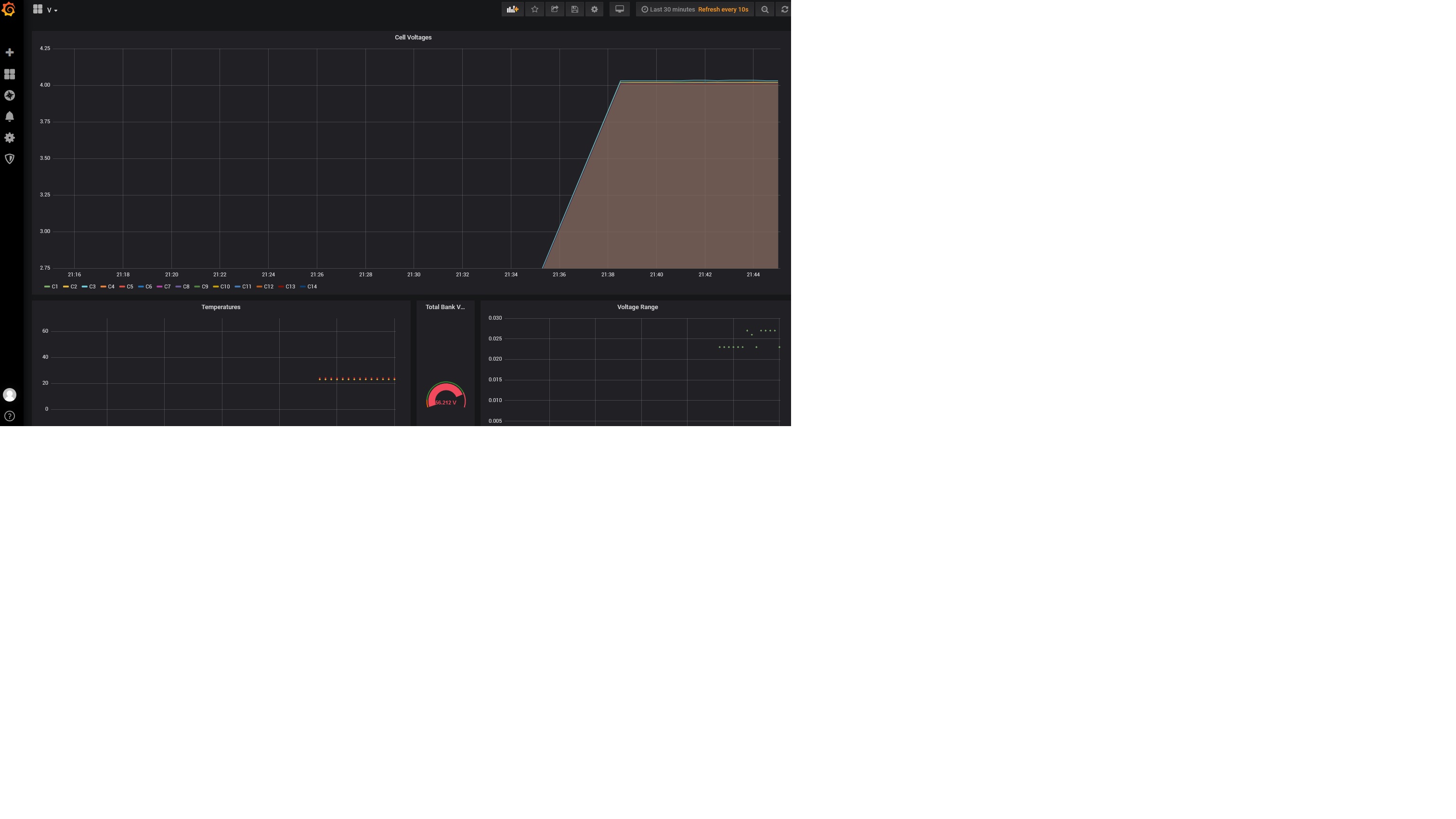

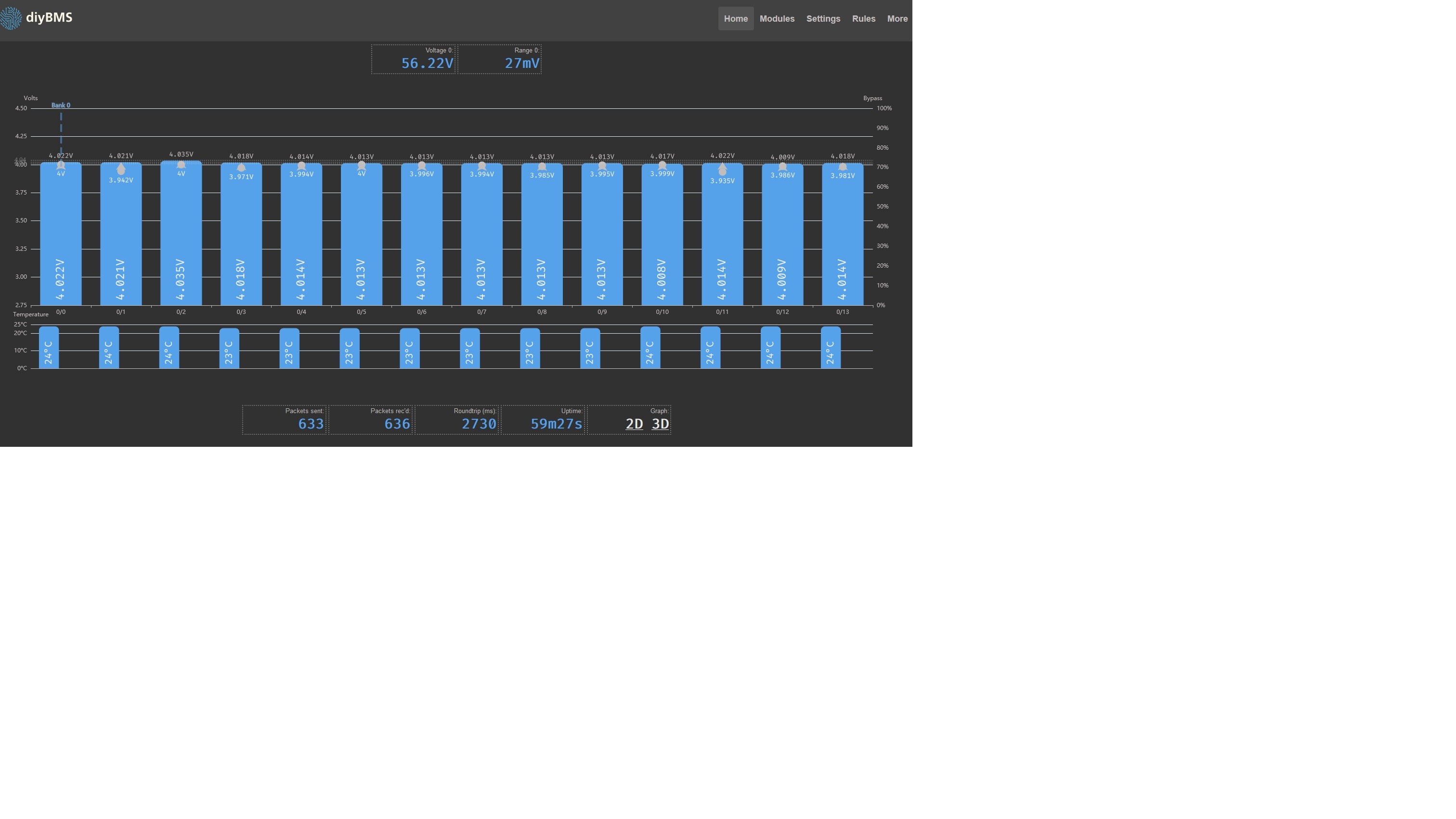

H you measured the voltages with a multimeter at the cells themselves? Did you also calibrate each module when you installed them?
In the screenshot, had the charger stopped charging?
Hi Stuart.
Thanks for the advice, Modules was calibrated but Iāll calibrated again with a better voltimeter (If I get oneā¦)
Yes charger stops carging because charging voltage is lower, but I can not guarantee 100%
The other thing to look at is why the voltages are drifting out when charging. In a perfect world, they would all charge at the same rate and be the same voltage.
It may be worth stopping charging/discharging and just set the balance voltage to 4.1V and let all the cells balance for a few hours so they are all similar voltages.
The 4.37V is higher than I would like to see, if these are 18650 cells.
One of the major benefits of the DIY BMS is that the modules can operate on their own. I donāt think stuart or someone else should invest time in fixing the common wire problem. Better fixing your battery wiring.
Its good as it is now. We canāt change physics.

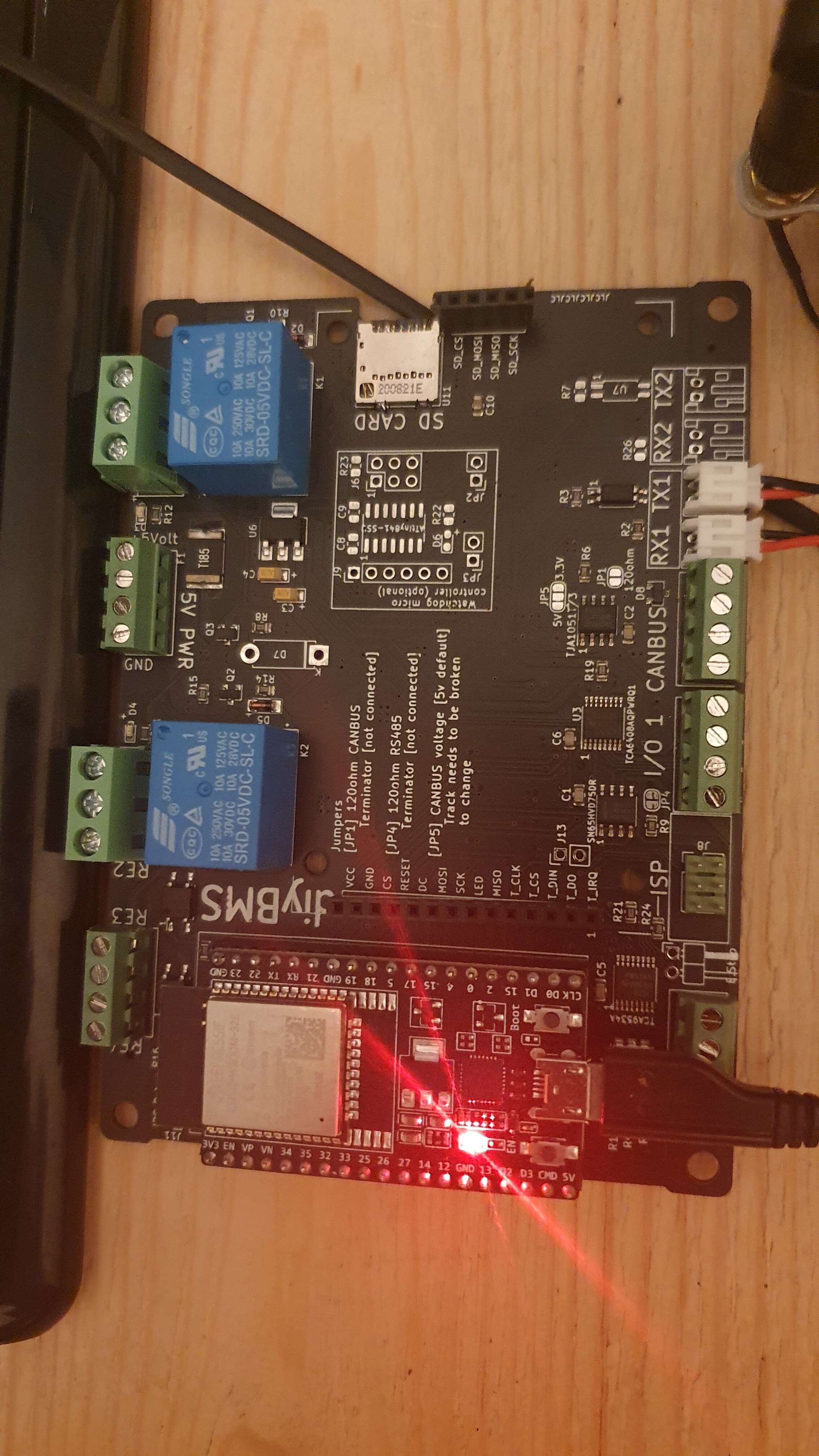

Hi Stuart, i did an update yesterday and I am having same issues than dakoal. But I am using latest firmware version. No relay is switching!
Voltage readings seem stable now and also no time out issues so far. Thatās great.

Hi, did it work with an older version of the code?
The last bug was a simple fix, so as long as you are using that version it should work.
Yes, it worked with the older version. Iām trying the older one now and hope that this doesnāt bring back my āolderā issues with time out and voltage reading/calibration issues.
After the update, its likely to have reset the rules you have, so double check they are firing as needed.
hey @stuart, check your PM here on the forum.
Yep i know but even when i set relays on always on and save settings they donāt do anythingā¦
Is there anything different on the controller?
Just went back on release from may 11 and relays work lika a charmeā¦
Did you definitely get the latest release when you use the current version?
If you install it again, take a look at the about page and the version should show e0a3f4b
as said, iāve seen dakoalās comment on relay issues and confirmed that i have latest release⦠which i have/hadā¦
I flashed it 2 times with same outcomeā¦
I will download again and re-fleash with latest version and check what version it shows on gui.
curious, isnāt itā¦

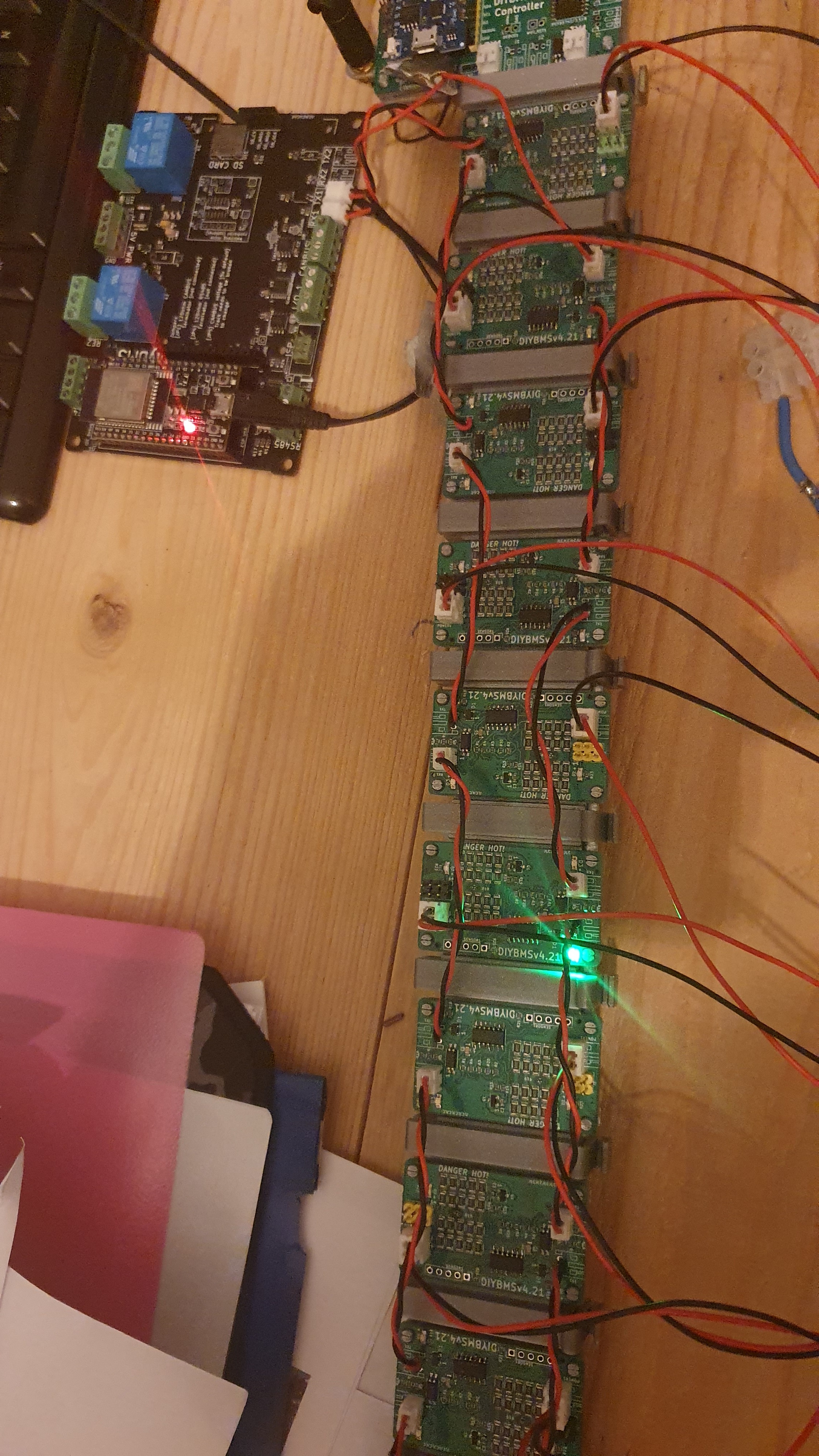

Finally able to start testing the new controllerboard, latest code, programming the modules is very easy.
Well done Stuart!
Got some more testing to do the coming days
Great work - @Emir0815 is having problems with the relay outputs - can you test your board?
Yes - my controller is working using the latest version, and @dakoal also confirmed working after the change, so Iām a bit lost of what to suggest next!
Iāll check again on the weekendā¦
Thx stuart!
Havent tested the relays and rules yet, still testing range (wifi) on 1s2p 18650 bundle connected to al modules, so voltage levels should be and stay the same more or less, i did find that the board restarts itself, everytime at a different intervall, the board is still powered via the micro usb connection on the esp. I change to proper connection on the board this weekend to see if that makes a difference.even though it restarts i see no data gaps in my grafana graphs, from influxdata.
I also cant seem to adjust the time and cannot activate daylightsavings
If i insert an sdcard, am I then able to log more data to be able to track these āissuesā ?
Iāll test relays this weekend and will keep you updated
