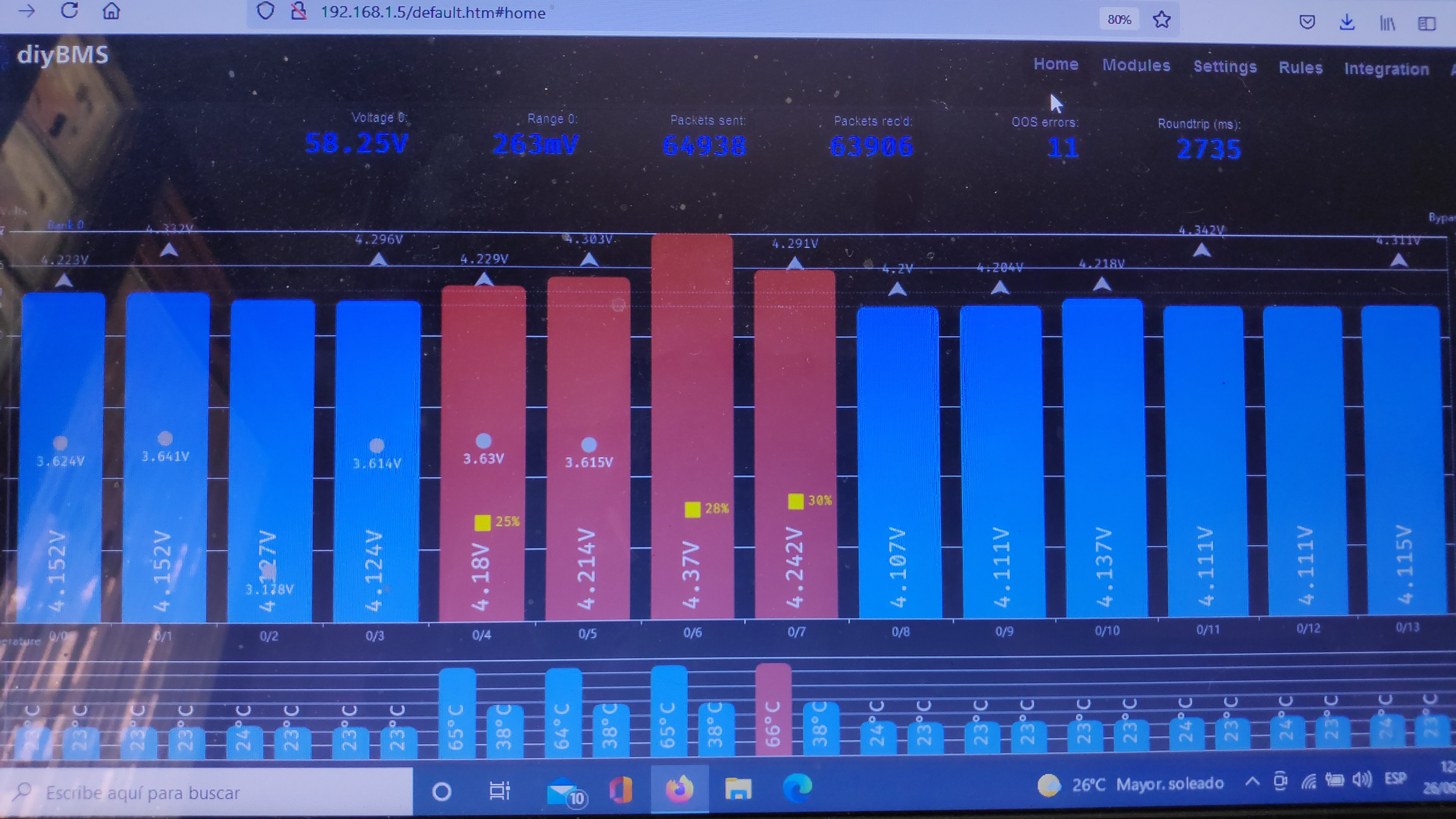

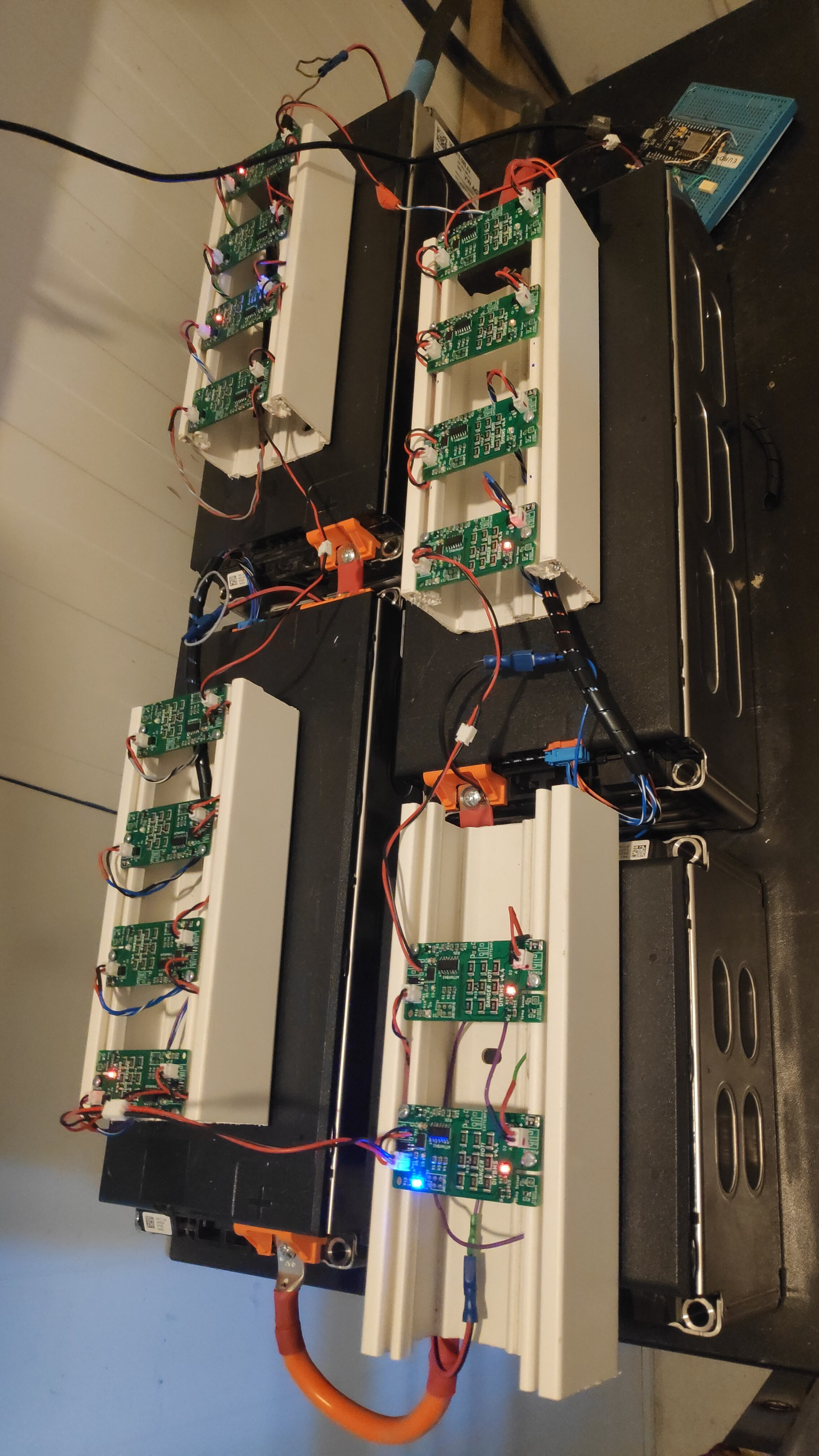

Hi
Finally I mounted diybms with EV cells. “Comon wire” efect is visible because use of balancing conector.
What relation between bypass voltage and mppt voltage charger should be recomended?
Which EV cells are you using? Also what rail system are you using to mount the modules?
What I’ve seen suggested everywhere is set the MPTT to 0.1v lower than bypass in diyBMS. This way the charger should stop charging before the cells go into balance mode so they will only go into bypass when they go out of balance.
Thanks. I’ll program my system for that, expect to minimize cell balance.
The cells are samsung SDI for VW e-golf. 5.6kwh
Rails are unex u23x trunking cable tray
Common wire efect: one of the modules 4s start to equalize all of cells. My charger volt is 57.4 aka 4.089 cell and bypass treshold is 4170.
