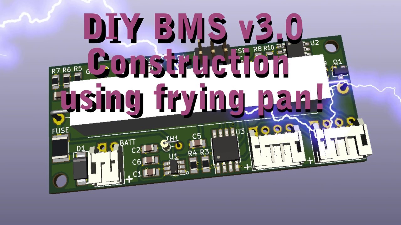

I tried to make 20 V3 boards and wasnt that successful to be honest biggest headache.
I know only have 8 boards out the 20 working, did have 16 working and provisioning. Anyway i was going to try and make V4 but i want to make it with Through hole components if possible. Has anyone tried this. If so love to chat and if possible get copy of the pcb and BOM fiies. Thanks Andy
Why not use the current board package, it’s not as difficult as you think. There is a video couples of post up about the making of the bms
Ufumoa is right. People have hand soldered them. One guy did it while in a truck stop over night.
Heck I tried it for the lols, but did the rest with a heatgun. But it is possible. Re-engineering the boards for thru-hole is just a waste of time that you could be spending on soldering the normal SMD boards.
If you want to avoid the soldering, just ask the PCB company to assemble the board for you - it will cost more but you will get a working board without the hassle.

I have the same problem. Already soldered 5 ESPController and 5 ATTINYCellmodules, they are blinking, Cellmodule every 8 seconds, the other module every 4 seconds. But I can’t get any connection in between the modules. Debugging shows, that the ESP 8266 is working, just doesn’t get any data. But I have to say, that this is my first SMD soldering project. So I continue trying to get better and better in soldering :wink:
Maybe the professionals here have some advices for beginners? Are there any other ways to debug the modules?
For example on the ATTINYCellmodules I have 4V at the RX1 and 240mV at the TX1. Is this ok?
5 controllers ??
Are you referring to v4 boards here? Just connect a single controller and a single module together (don’t forget you need 2 cables for this for form a loop).
When soldering the critical part is not to solder the 2 pins of the opto-isolator together - this would be very bad :slight_smile:
Take a look at my frying pan soldering techique for the v3 boards - same applies to v4
