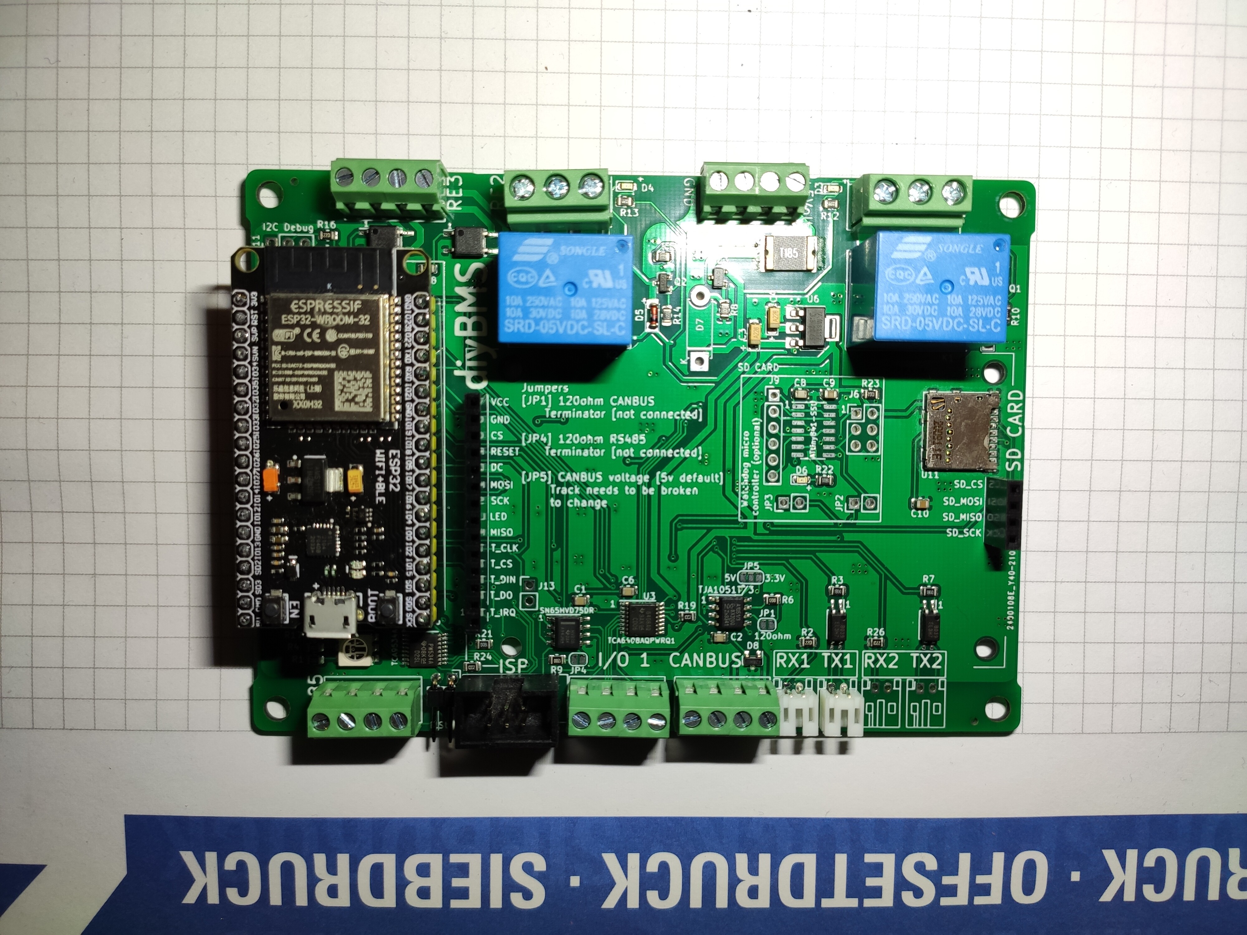

I’m in the process of ordering the new version of controller, and D2 orientation is wrong!!
(Stuart made a post about this on Patreon)
A message to JLCPCB probably can prevent the wrong orientation.
I just wanted to mention it again as it was by chance I saw it Patreon.
This has also been corrected on GitHub I believe.

I want to get started on trying the new controller (using the ESP32) so i am trying to order at JCLPCB using :
Gerber : diyBMSv4/Controller_Gerber.zip at master · stuartpittaway/diyBMSv4 · GitHub
BOM file : diyBMSv4/ControllerCircuit_bom_jlc.csv at master · stuartpittaway/diyBMSv4 · GitHub
Pick and Place file : diyBMSv4/ControllerCircuit_cpl_jlc.csv at master · stuartpittaway/diyBMSv4 · GitHub
All components besides :
- TFT display i can buy on bangood using your link : 2.8 inch ili9341 240x320 spi tft lcd display touch panel spi serial port module Sale - Banggood.com
- Controller : I already have few ESP32 DevKitC - WROOM-32U.
- 3 things are missing on JCLPCB :
, can be found at Farnell https://dk.farnell.com/molex/104031-0811/connector-micro-sd-8pos/dp/2678573
, i can’t find this at Farnell, maybe there is an alternative ?
, can be found at Farnell https://dk.farnell.com/on-semiconductor/nup2105lt1g/diode-tvs-array-350w-24v-sot-23/dp/2101833
Anything else i should be aware of ?
The NUP2105 can be swapped for the alternative JLCPCB suggest.
I would wait until the AO3401A is in stock again before making an order.
If needed and if there is sufficient interest I’ll order another batch
