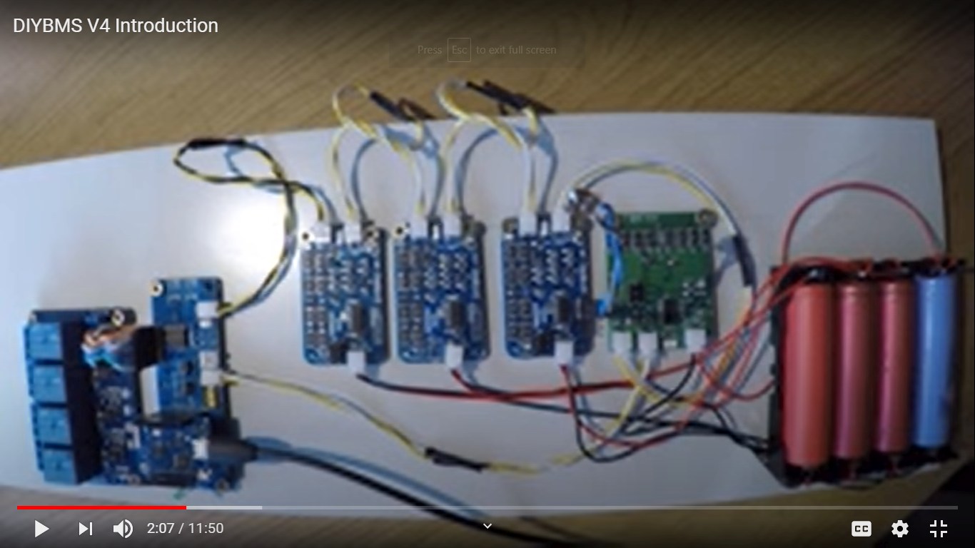

DIYBMS v4

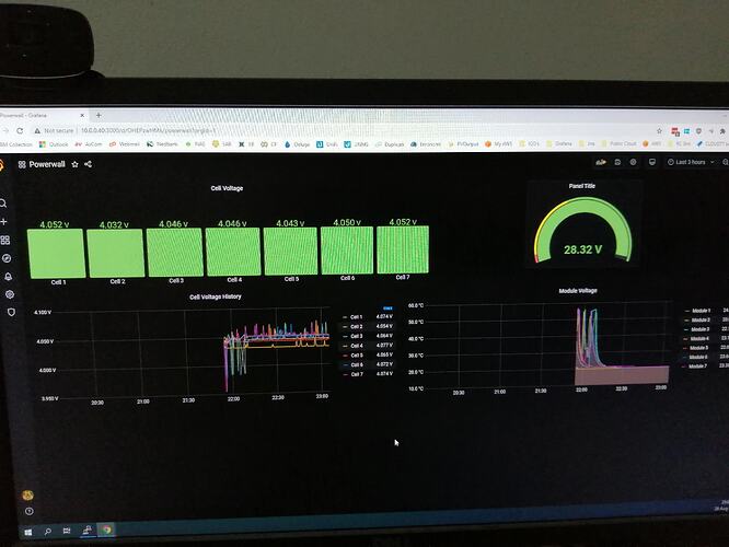

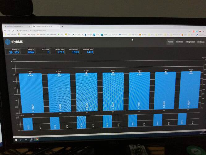

Well after a very long time I have finally got my 1st bank hooked up, just want to say thanks to all that helped here and especially to @stuart
Powerwall with DiyBMS operational

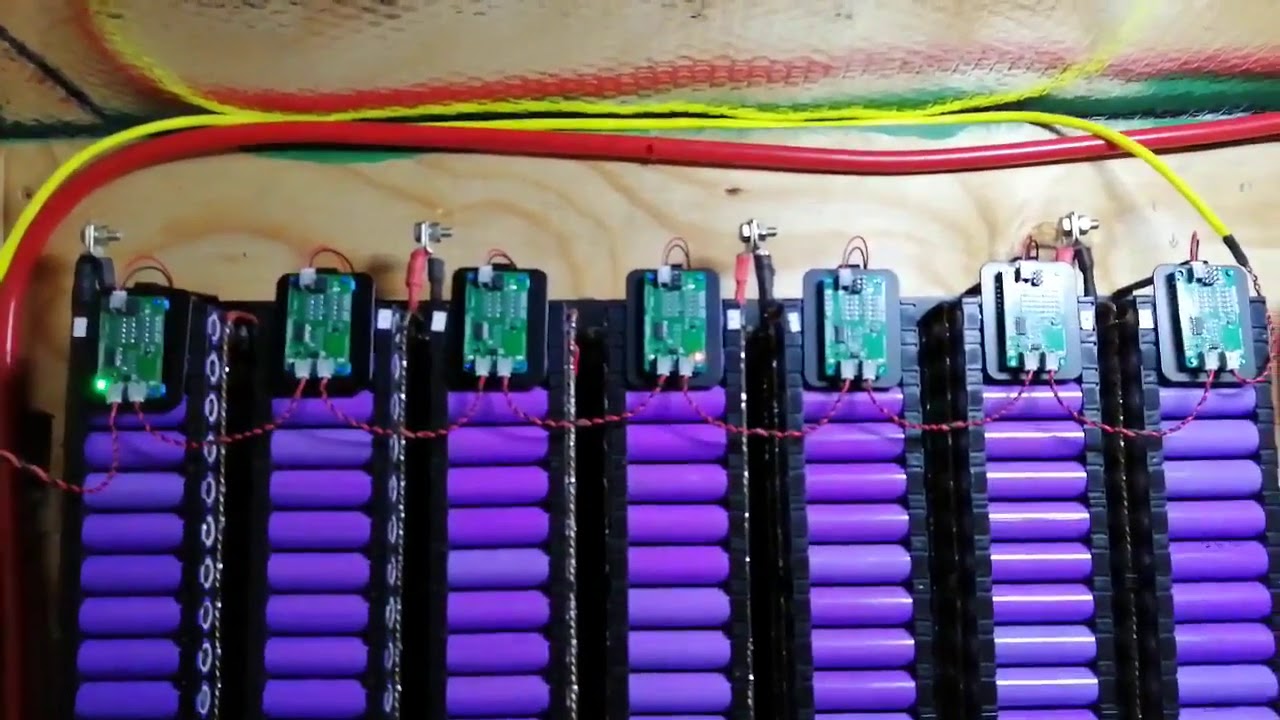

Thermal Video of a module in bypass
It looks like HBpowerwall-design wall mount was specifically designed for DIYBMSv4 boards =)
Nice place found to mount the boards - looks awesome!
Yip it is HBPowerwall Pete’s design, I used these mounting plates designed by Adam Welsh to hold the modules

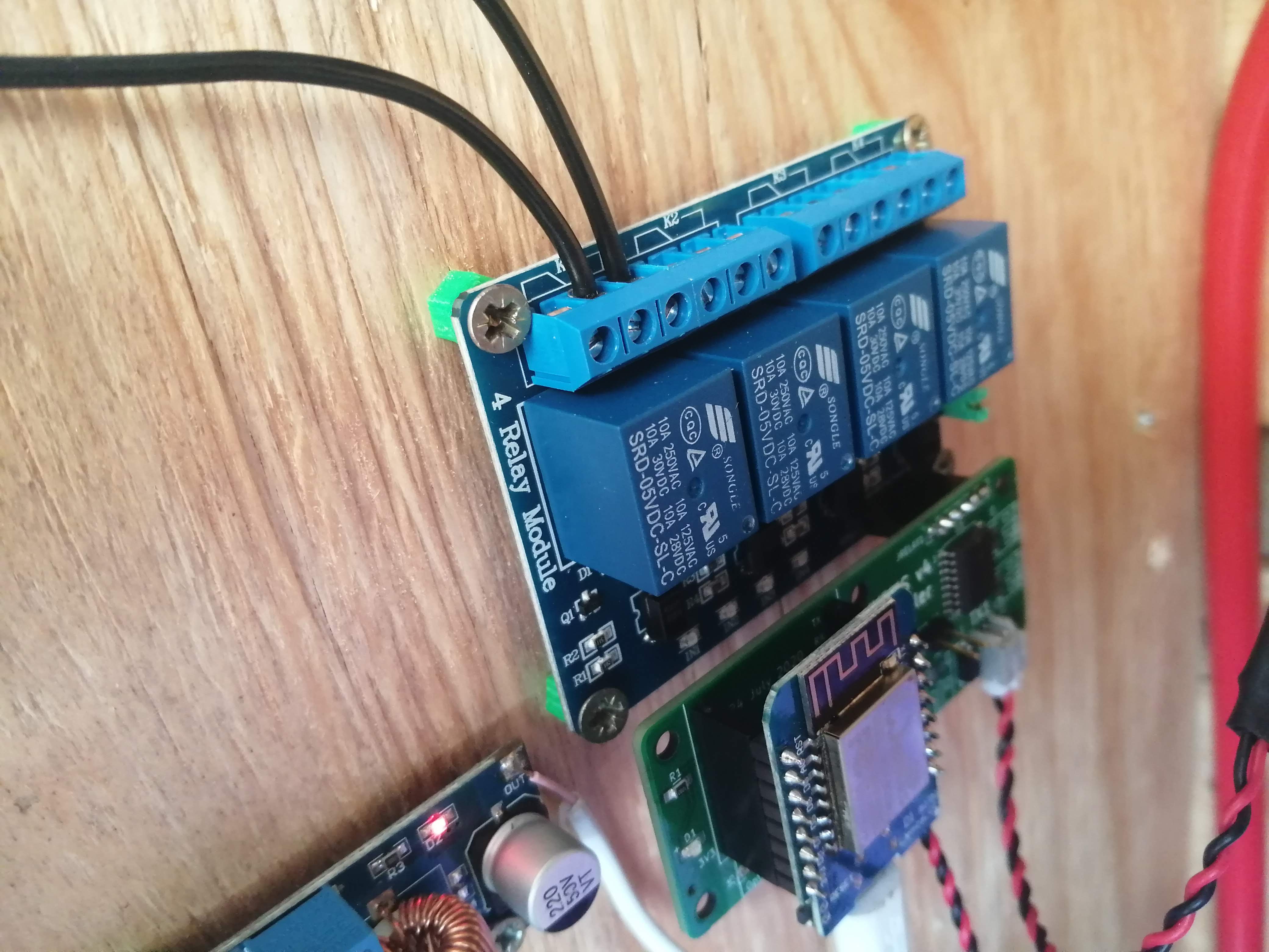

Also for those who want to add a realy board, I soldered female pin header to the underside of my controller and them just plugged it onto the relay board as below
Great thermal video, how accurate was the temperature compared to the BMS reading?
so the BMS is set to 65 deg, and if you look at the thermal video it gets to 64 deg and then cools off, so by my book that’s as good as perfect
