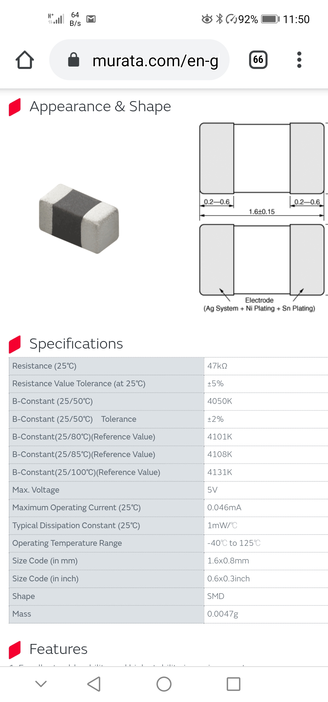

Can anyone comment of wether these thermistors would work for pack temperatures ?
THERMISTOR NTC AXIAL 47K 5%
AXIAL, GLASS ENCAPSULATED THERMISTOR,
NTC, 47K OHMS, 5% 3900K

This are the specifications of the thermistor on the PCB, and they work also for external sensor.
(Just solder 2 wires)
The ones you like to use have different specifications. They seem to be intended for much higher temperatures.
Most likely not accurate enough at the temperature range needed.
It seems they have minimal temperature of 25 Celcius.

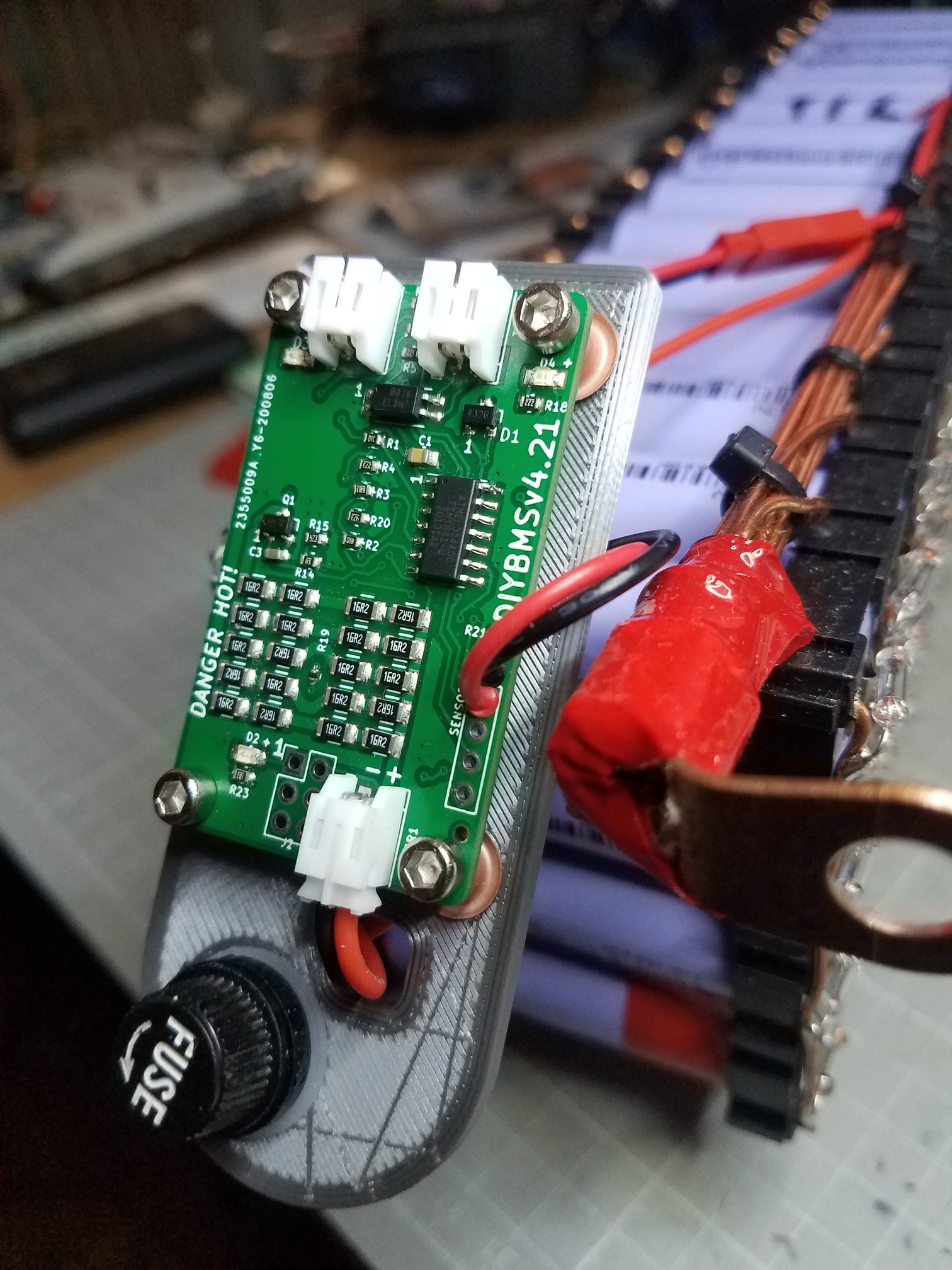

Yes, the silk screen was off in the pcb so I’ve tried again!
