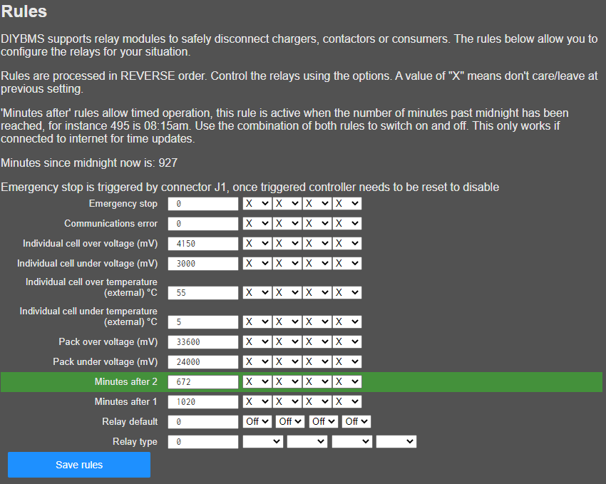

Below is a screen grab of the rules page, very straight forward, to input your desired values and click save, Stuart does have a video of this as well below
Thank you!
