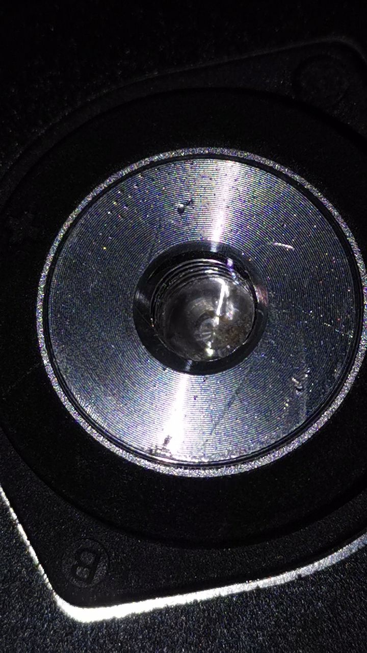

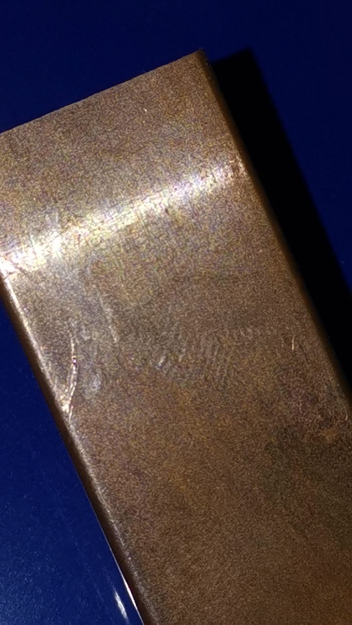

Question not strictly DIY BMS related.
It is related to the usage of the DIYBMS.
So much combined knowledge here I don’t want to miss the chance on asking.
For LiFePO4 higher Amperage cells you connect the terminals with bus-bars.
Bus-bars that are bolted onto the terminal.
I personally use headless bolts as they place less stress at he weak shallow aluminium thread (only 6mm deep and max 8Nm torque!!!)
Anyway, to improve connection between bus-bar and terminal they obviously need to be cleaned and flat as possible.
I read that professional installers use silver electricity conductive paste. Expensive stuff!!
Many people use nothing in between.
Would something simple as solder paste improve the connections between the terminal and bus-bars??
Solder paste flux is non-corrosive
Solder paste have about 50% solder.
Naturally, a really thin layer, just to maximize conductivity.
It won’t be as good as silver, but I think a lot better then nothing!
Both terminal and bus-bars (this is not yet bus-bar, now just copper bar) have minimal damages and the terminals have circles.
Flatening by filling the mini gaps should improve total contact surface, yes??
Or is it a dumb idea??
cheapest I know of is using Vaseline on aluminium electrical connections , helps with corrosion so better connection long term , any thing with silver / diamond is going to be expensive
mixing aluminium and copper is also a bad idea (galvanic corrosion) better using stainless steel or brass
I was referring to your aluminium bolts not the bus bar material , personally aluminium is my favourite it actually conducts more electricity / weight
carbon paste is another alternative

I know vaseline indeed, after firm connection on top of the cleaned aluminium terminal there’s no air to oxidate.
Diamond powder… it’s expensive insulator :slight_smile:
90 % of all bus-bar is copper , with aluminium terminals.
That must have a good reason, or the galvanic corrosion isn’t a (big) problem in this setup.
I do known it to be huge problem in computer water cooling to mix copper and aluminium. For car water cooling the same.
Adding coolant liquid stops the galvanic corrosion process…
In the early days (1960’-70’s) they put iron nail in the radiator to desolve, as the least pure metal goes first. Later it was replaced by better chemical solutions.
This question is for optimalisation, not a discussion about types of bus-bar
(Not negative intended, just trying to keep the focus on the question.)
Is using solder paste better then using nothing, just bare metal?
Next question would be if solder paste is better then vaseline?
