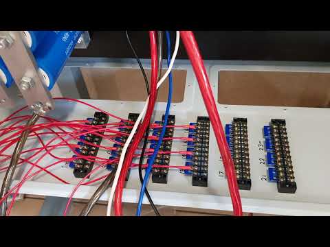

I am building a 22S lithium Titanate battery bank and looking at changing the resistor bank to a different value to suit the 2.8v cell voltage, as you just stated that there is a bank on 20 resistors (4.96 ohms) @ 6.2 ohms giving you 3.55W of power at 4.2 v battery voltage.
Calculation on a 2.8V cells @ 4.96 ohms only gives me a 1.58W of power dissipation. how much can i change this value of resistor to suit the lithium titante cells to get the most safe dissipation out of the bms boards, I have not yet ordered them from JLCPCB, I know i will have to change the BOM list.
Just doing some calcs of resistor bank to suit 2.8v lithium titanate cells, based on 4 in series and 5 in parallel
2.4 ohm bank gives me 4.08 watts (1.92 ohms of resistance)
2.7 ohm bank gives me 3.63 watts ( 2.16 ohms of resistance)
I hope my calcs are correct?, just wondering if this is the go with making this boards work the best with the lithium titanate cells?
