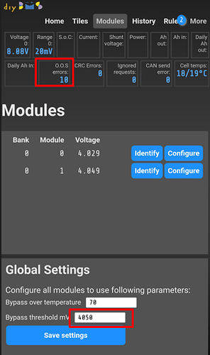

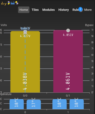

Hello @stuart , Today I checked everything once more and there are no errors until the battery needs to be calibrated.
Now I set bypass threshold mV 4050 and immediately all modules start to flash D4 led synchronously.
When I tried using the small 5 cell pack, the calibration worked.
I don’t understand why it doesn’t work when I connect it to a large pack.
Yes after 12 hours of operation I got “OOS errors”
Where do I find the problem?

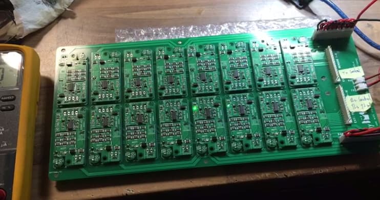

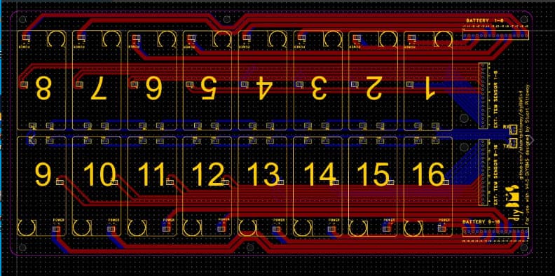

First of all, I created a more efficient design to use V4.5 (fatter tracks, without crossings and definitely more efficient.) I share it with pleasure.
The cable I used was 18AWG and the longest distance is approximately one meter.
It works efficiently in combination with an active capacitor balancer.
In the old design you couldn’t use the full speed, but with the new design, the modules operate at 10K without problems.
When I had the V4.4 modules, I did notice interference in the voltage reading when matching, passive and active balanced, but with V 4.5 this problem is no longer present.
As for the cables, there are 32 cables from the batteries to the v4.5 module board and other cables (17) (I didn’t want to share them) from the battery to the passive balancer.

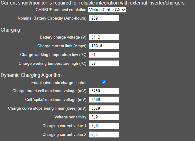

i use the dynamic charge function so if one cell spikes at near full charge the bms will lower the charge voltage over canbus and the inverter reduce charge power almost to nothing.
then 200ma are enugh to balance my cells in minutes but 500ma are better then 200 so i take that risk with the other resistors and i will use a big heatsink with fins and a 80mm fan to cool them down.

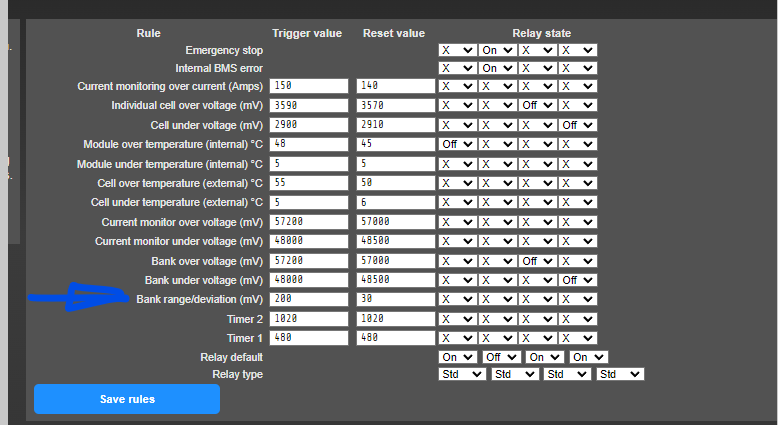

Hi, i want to use the modules V4.20 (orderd for my LiIon Powerwall 2020) with my new LFP 16s Pack. I also have a current meter an a controllerboard with display. I have connected the dyiBMS Controller with a Victron Cerbo GX. After connect the Cerbo to the inverters, the inverters go into error state “low battery”. My oppinion is, that the BMS decide to disallow charging and discharging. And also I can see, that diyBMS sends a temperature of 0°C to the Cerbo. At the modules are no external temperature sensors installed.
Do someone have an explaination?
I have experienced a similar problem after updating the version of the controller until I realized that in rules, there is a new one: Bank Range/deviation (mV) that was too low, I don’t know if this could be your problem
I changed this values with same result. When I reload the diyBMS page, the charge and discharge prevention are the same.
Nick, you need to have the diybms current shunt board (or a newer controller) for the victron integration to be useful. That is the only way to get state of charge and current readings into diybms.
Hi stuart, I have a shunt board with 500A shunt/50mV and get voltage and current from the shunt over MODBUS. Do I need a temperature sensor for the victron integration? The 4.20 modules only has internal sensors for balancing.
Yes, at least 1 external temperature sensor is needed for cell monitoring.
Without any temperature sensor the diyBMS will send the Victron, that charging ans discharging ist disallowed?
