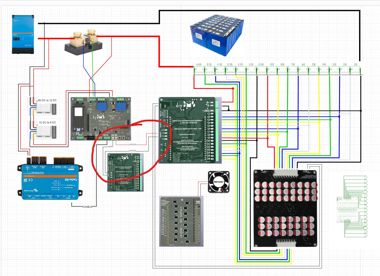

I am preparing a schematic for the Spanish group, but I have doubts about how RX and TX are connected between 2 All in One and the controller for a 32-cell system. Would someone know how to help me?
the tx1 and tx2 confuses me too

@stuart , what are your thoughts on stacking two 16S passive balance boards on a common V490 AllinOne Monitor board, perhaps populating TH1 on one and TH2 on the other as a means of increasing balance current? Header pins are supposedly rated for 4-6A, but I don’t believe we need to get that carried away!
thought the same today but then the lower balance board cant be active cooled.
better you swap the resistors to 6.8ohm for 500mA balancing but you need a good cooler
Fan could be mounted on the edge of all boards, blowing air in between boards.
its not enough i think
I don’t think so either, I have ordered 6.8 and 8.2 ohm 2W resistors and the same package to do tests, but contact with a dissipation surface is essential, another thing is to mount a second group of L-shaped resistors in such a way that it can be placed on both the heatsink and the fan, but it will be a bit Frankenstein
well a additional balance board could be placed under the all in one module, then both sides can be cooled.
but this will be also a frankenstein :slight_smile:
and its not so compact anymore.
tell us your experience with the 6.8 ohm resistors when its ready.
i will wait a month till i order, maybe stuart improves something.
