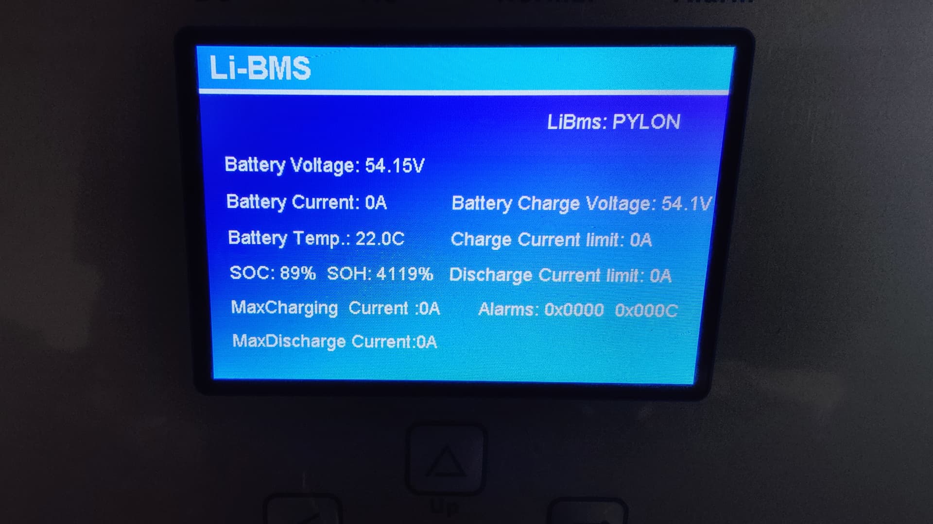

Dear all,
Finally, my DIYBMS 4.5 and LiFePo batteries in 16s configuration are running with my DEYE 12K inverter.
Unfortunately, I can only run it in “Dumb mode” as my CAN bus seems not to work as hoped.
The inverter recognizes that a “Pylontech” system is connected via CAN and both systems are told to use a Pylontech emulation.
Strangely, the DIYBMS controller reports under “tiles” that here are no CAN bus errors and that a couple of thousand/hundreds packages have been sent/received. Looks to me like it works in principle. However, the inverter’s onscreen BMS pages show zero voltage/-75 deg/0% SOC (vs. DYIBMS 54.3 V/21 deg/98% SOC) so as if no information has been received by the inverter from the DIYBMS system.
Any ideas what could test in a next step? I am currently out of ideas…
Any help appreciated!
BTW, the shunt is not yet installed but that shouldn’t affect the general ability to communicate over CAN, correct?
You really should have a current monitor installed first - there is even a warning on the configuration page to that effect. Some values such as SOC absolutely will not be sent unless it’s connected. At a quick glance of the code V and T appear as they they might be reported without a monitor installed but… you’ll still be stuck in “dumb mode” until you install it anyhow, right?
I do agree…however, I fear that there is something wrong irrespective of the shunt?
At least the voltages and temperature(s) should have been transferred, correct?
Hi, I also couldn’t get diybms to run correctly via can with a deye 12kw inverter

At least Voltage, Temp, Battery charge Voltage and SOC are displayed.
Do you have the shunt module installed?
Best,
Dominic
Without the shunt no voltage, current or state of charge will be transmitted over CANBUS.
Do you have the shunt installed?
Thanks Stuart!
That’s a relief - so probably nothing wrong…
Shunt is on its way :wink:
D
Yes, I had a have the shunt installed.
Great - do you want to join the conversation on this GITHUB issue - its about the DEYE inverters.
See if we can get it working for you.
