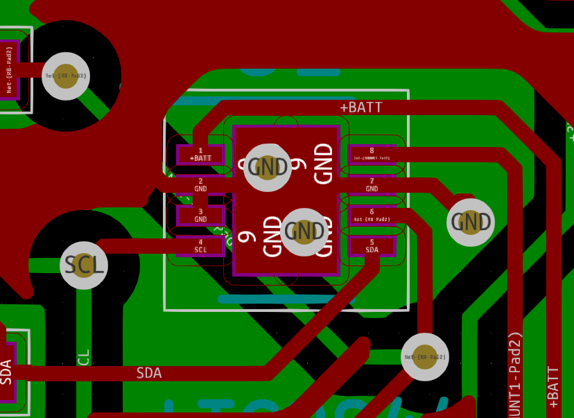

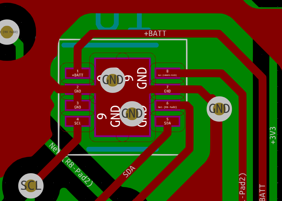

Hi Mike, I think its the rendering from JLC that makes it look a bit close.
Screen grab from KiCad.

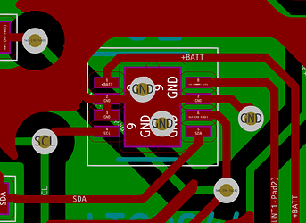

Ahh, yes, it looks like you might be right. I’d likely push the +BATT about 1/2 trace width towards the top away from the GND pads but otherwise it looks good in KiCad rendering.
I’m 1 step ahead of you, just did exactly that!
great! you might also consider similar adjustment on pad 6 and move the GND that is to the right down into the larger fill area
So far so good!
