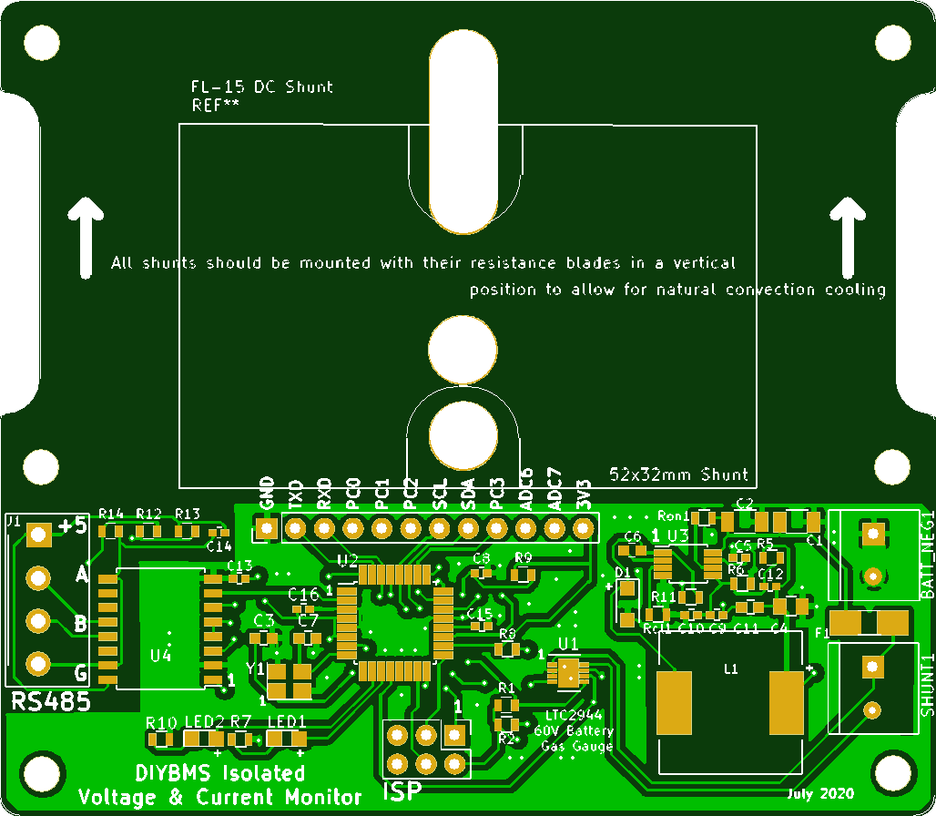

I’ve sent off a prototype shunt design to JLC, this is using an isolated RS485 comms and the LTC2944 “battery gauge”. No idea if its going to work yet!
I’d say your design looks pretty good. A couple minor comments:
  1. adjust your GND fill to be solid where it connects to pins so you have a stronger connection to the pins (see the BAT NEG terminal on right side has spokes)
  2. double check the traces have sufficient clearance on the QFN like IC, specifically top side left corner they look just a tad close to the pads.
  3. double check that all components are sized for thermal dissipation needs (I think they are but would need to see exact components used).
