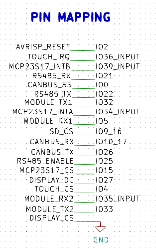

No its running off the SPI bus - actually I’m using both SPI interfaces on the ESP32. One controls the display (running at a high clock freq) and the other is for everything else running at lower freq.

What other devices are using SPI? Do you really need two bus speeds? If you are using SPI for CAN or RS485, you can switch to a basic transceiver since the ESP32 has built-in support controller support for both of these.

The remaining stuff is:
  • ISP programmer
  • SD Card
  • Touch screen interface
  • MCP23S17 (SPI I/O interface)
On top of that,
2 pins for module serial 1
2 pins for module serial 2
3 pins for module RS485 (including enable)
3 pins for module CANBUS (including enable)
1 pin for AVR programmer reset pin
I’m using 19 I/O pins!
Yeah, it is a very capable device for sure!
These should all use the same MOSI/MISO/CLK pins so they should only need a CS pin. For the SD card, be sure you are using 1-line mode. I’d also recommend using MISO:2, MOSI:15, CLK:14, CS:13 for the SD.
For the CAN connection you might be able to drop the enable pin, which transceiver are you using and how are you powering it?
For the AVR reset, you might be able to overlap usage with another pin (ie: gpio 0).
Also note that PICO D4 does not have GPIO 16 available. I’ve collected some notes on pin availability/usage here.
This is approximately what pin mappings I’m looking to use at the moment. I’m using the recommended pins for HSPI and VSPI (to avoid slow down via the multiplexor)
RS485 is using SN65HVD75DR and CANBUS SN65HVD230DR.
The PICO seems to have 2 extra pins available that the DEVKIT doesn’t (pins 37/38). I’ve also tried to make use of the input only pins where possible for RX lines etc.
These two pins typically have a filtering cap on them to 36/39. I wouldn’t use them for any purpose.
From the pin mapping you have provided it would appear that you might be using some reserved IO pins. GPIO 6-11 CAN NOT be safely used as they are directly connected to the onboard flash on all esp32 variants (esp32s2 uses a different range and are not exposed for usage). Also note that GPIO 16 should be avoided as it is used for PSRAM on some PICO-D4 boards.
Sticking to input only pins for RX is not a bad thing, there are only four of them to contend with (34, 35, 36, 39). The pins I recommended for SPI/SD are HSPI pins and are the defaults used by ESP-IDF for SD 1-line mode, arduino-esp32 SD library would use the same when using HSPI (default).

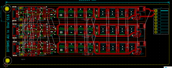

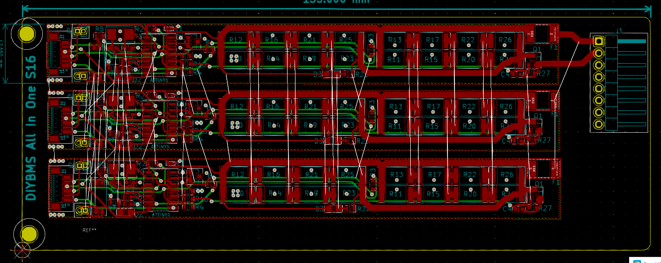

@stuart or @atanisoft do you have any advice for making a single board with 8x modules and 1 controller?
Is there a way to have jlcpcb perforate the modules so that you can separate them? Then maybe have some tx/rx pins in position so that you just jumper them? This would enable the modules to be separated like the current ones. This would increase the waste of the 5 min order, but just resell them.
The goal is no daisy chain wires and one thing to mount.
Like this you mean…
I’ve had the same thoughts and design ideas that you mention (this one was started before COVID) however what you don’t see is the feedback I get in regards to why people picked the DIYBMS in the first place.
A lot like the fact that the modules are isolated from each other - this helps avoid wiring issues and the original use case was a ā€œpower wallā€ which could be physically large and having the module next to the cell makes sense.
However I aborted this ā€œall in oneā€ idea - it looked very silly having 16 ATTINY chips on the same board along with 16x programming headers and all the other stuff. I didn’t know what the thermal issues were with 16 cells all dumping heat into a single PCB (and I didn’t want to get into fans etc.)
Ultimately, an all in one board makes sense (which is why Batrium launched one!) but only if you also redesign the entire circuit to remove the duplicate ATTINY (or similar). To remove the multiple controllers then introduces ground isolation issues again (but between the cells this time).
Thermal management is also a big concern with that much power/heat concentrated into a single space.
