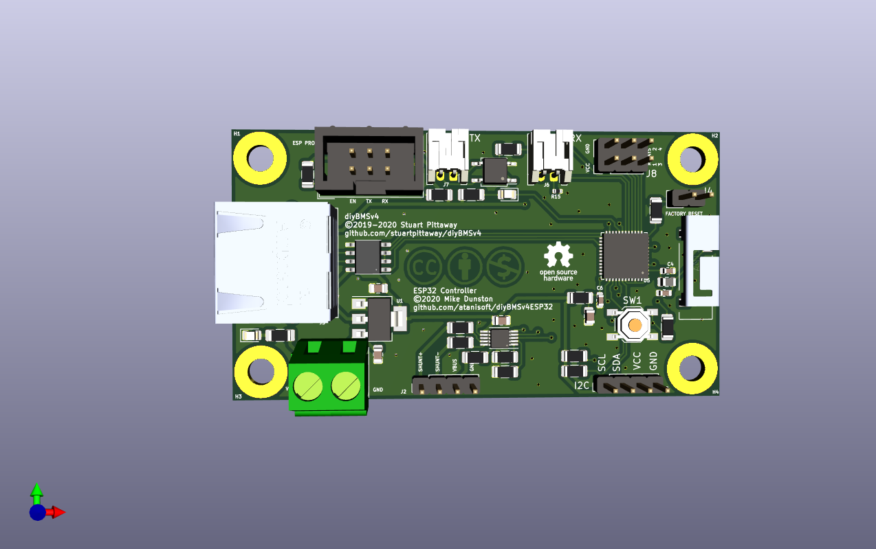

I had designed a PCB to replace the current controller with an integrated ESP32 SoC:
A quick rundown of features on the PCB:
- ESP-PROG header for ease of programming.
- CAN transceiver for connecting to solar charge controller (was planning on EPEver/EPSolar).
- Integrated INA-226 with header to connect a shunt.
- External power connection with 3v3 buck converter to power the ESP32.
- Nearly the same footprint as the current controller PCB (40x75mm).
- I2C header exposed for expansion (ie OLED/LCD display).
At the time I designed this all parts were available via JLCPCB except the antenna, unfortunately they have stopped carrying the ESP32 for their assembly services. The approximate cost for five populated boards was around $55 USD (plus shipping of approximately $18 USD) or for 30 boards it is around $116 USD.
If there is interest in this I’d gladly refresh the design and share the files with @stuart or others.
Looks great but I understand nothing about these components, however if the ESP32 is not available from jlcpsb then that would be a problem as the component is hard to solder ?
I wouldn’t attempt hand soldering of a QFN-48 part with an iron, especially not on the ESP32-PICO-D4 as it has 49 pins (GND pad on bottom side) and the side pins do not have much exposure for hand soldering.
If I revisit this design I’d swap for either an ESP32-S2-WROVER module or for the ESP32-S2-Saola-1 devkit. Both of which have more IO pins available and native USB support.
It would only be possible via stencil and reflow oven/hot air.

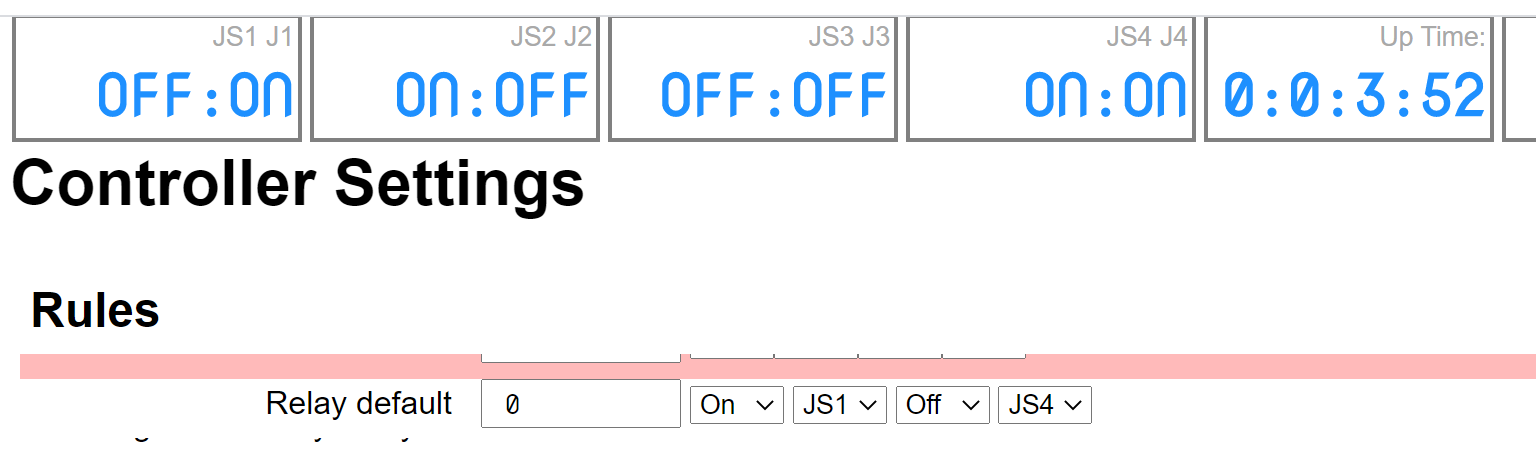

I made a change to the default rule such that the relay can get it’s value from the 4 inputs (I call them JS1-4, where the S is Switch).
I figured it would be handy to show the current state of both the switches and the relays. This particular display is not good. I think the future will have pretty indicator lights and the user will be able to name them so instead of JX, it will be “Inverter” or whatever.
