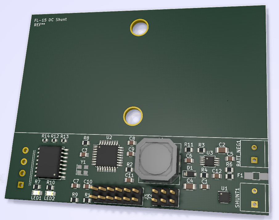

I’ve also been working on a gas gauge/trip board design using the LTC2944:
I strapped a bought-in buck converter to it so that I can run as a standalone board directly off the 48V batteries. I added the suppression components as recommended in the data sheet, so hopefully I won’t suffer and noise problems.
The idea is that it would be placed close to the battery and sit there monitoring and figuring out the SOC.
It has MAX485 (or optionally RS232), that I will use for control/query via MODBUS protocol. There is no isolation as I didn’t think I would need that since it’s all referenced to the same ground. Hopefully that won’t prove to be a bad choice.
I went with an on-board ATMega328PB since that’s what I had in stock. I also added a big-ish FET that should be up to firing the solenoid in my shunt trip, plus a couple of other opto-isolated outputs for currently undetermined future use.
Soldering the 2944 chip was actually surprisingly easy. I used a heat gun though. I think it would be much harder with a soldering iron.

Really nice design, and fun to see, that you decided to go with the same design as Stuart and George decided.
Leaving out RS485 isolation (Or similar) can cause a lot of melted insolation from the wires if somebody by purpose or not decides to power the controller from one of the batteries (Except from the battery closest to gnd)
Adding isolation also means, that you in the future, if Stuart decides so, can change the interface for the battery modules without changing controller and shunt-circuit :slight_smile:
Really nice work there @ebsol (Cliff) how easy was the 2944 to program for ?
The isolation isn’t a problem if you know what you are doing (and it looks like you do!) and have a controlled environment - if everything is running from the battery negative all good.
Unfortunately we can’t guarantee that in the DIY world, people have strung all sorts of things together (good and bad!) and a battery with 20 or 30 kWH of storage in it has a whole lot of potential to make things go bad really quickly :slight_smile:

Heres what a potential PCB could look like. Using the FL-15 shunt dimensions from here the PCB could be screwed/bolted to the shunt for mechanical stability. The board is 82.5mm wide and 66.5mm high
I’ve exposed the spare ATMEGA pins in the 12 way header - not expecting to need these, but doesn’t cost anything to provide them.

It’s your design and I’m very impressed with this diyBMS project, so please do not consider my inputs as criticism
I don’t understand why you want the 2 shunt connection holes in this direction
why not have the electronics parallel with the shunt, and cut away PCB to the left and right of the holes, so you have room for some beefy cable shoes ?
Have you seen the official Arduino Library for the LTC2944 chip?
They are not shunt connection holes - just bolt holes - the PCB would sit underneath the external shunt. It should align with the 5.5mm holes. You would still need cables from the shunt bolts to the shunt1 connection on the board.

I think the architecture you created with the n modules makes your BMS unique in it’s flexibility to handle any pack voltage, and any size batteries. Your bolt holes seem to violate that design goal.

I did mention it was a prototype, seeing if it’s the right way to go, you don’t have to use the bolt holes and as there are so many different shunt sizes it probably doesn’t make sense. But anything which helps physical mounting of the pcb is good in my book.
