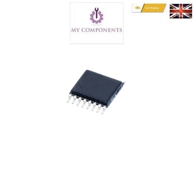

I just received my JLCPCB order of the ESP32 Controller Board. It was missing a couple parts C3, C4 Tantalum Capacitors, the relays, as well the TCA9534A. I ordered off eBay from the UK the TCA9534A. Im praying they are legit. The company looked to have pretty good reviews. Here’s the link if anyone is interested. They are $5/GBP not exactly cheap but I figured I would try this before the Chinese fakes/empty box.

DON’T ORDER FROM HERE!!! THEY WERE WRONG VERSION OF CHIP.
Just received 4x TCA9534A, but they are SOIC-16 and must either be the DWR or DWT variant.
