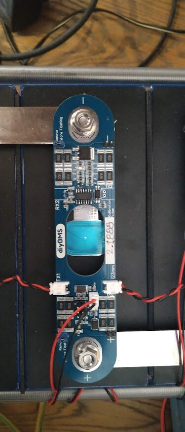

hello all,
following v1.8 that Andrew was quick to built and test (thanks!) I had more free time and thought of making a 123mm specific version (v1.9) pulling the resistors apart, helping in the pcb cooling as well as leaving a hole in the middle where the venting tab and QR code on each cell lives.
To avoid making the whole thing even longer, I added the ext temp sensor in the middle, easy to break out (or cut with a dremmel) Although I did wire this sensor to the board (so in theory doesn’t look like an individual pcb within a pcb) I was charged some dollars more, I think ymmv.
it’s a temp setup atm, once I built the rest, I’ll take the whole lot apart, clean test contact on each tab, shrink wrap the busbars and refit the lot.
@Andrew_Congdon did you test top balancing with these heatsinks on? What Amps will it withstand? Without heatsinks, 1A is the max the system will manage with 65C internal temp without V creeping up. Wonder the new limits! link to the heatsinks you used?
I’d definitely put heat shrink on the exposed part of the pcb, that’s why I did the v1.9 with full width ending so that it’s easier to heatshrink the busbar and keep it covered under the module endings. Note that there’s a thin M6 nut after the busbar and the module sits on top with a locking nut to finish off the install. Easy to replace without disconnecting everything

btw, from initial tests yesterday with just one new board, looks like on balancing it stays slightly cooler. Going through another balancing session with the four new boards so will know better later.
That latest design looks really good. Good to be able to easily see the vents.
The heatsinks certainly increase the sustained balance current although I haven’t measured it.
I have a working setup with the old boards and have put them only on the cells which regularly require more balancing.
They allow the 100% PWM indication to be maintained rather than being throttled for temp.
I don’t think they are required and may even mask issues like poor continuity.
I like the double nut idea. I’ve used thin copper washers between the nuts and boards so I can torque down the included nuts and be able to remove them without damaging the board.

@Andrew_Congdon exactly, thin they are, enough to torque down at this small value at M6. Further means that replacing boards or doing any sort of maintenance doesn’t bring the whole thing down. OK, wouldn’t like to seriously charge or discharge the system at the time, but in an idle/low load state, it should be fine.
Completed some testing with my 8S system where the middle four are the new v1.9 modules and the two on each end are the older ones.(as per the pic I posted yesterday above).
Balancing starting at 3550mV, top balancing with a bench supply where I can accurately tune Amps going in. Bypass overtemp at 65C, room temp 21-22C, results:
@1.2A new modules at 45-55C, old modules at 55-65C Managed to keep that indefinitely - OK, got bored after 20mins but didn’t really look like changing:
@1.5A new modules at 55-60C, old modules at 68-73C. Could not keep it for v.long as old module cells voltage kept creeping up as expected:
interesting to see the influx data in grafana (at 60sec interval though so relatively rough) where it clearly shows the split between the old and new modules internal temps:
Conclusion, looks like the split of the pcb in two parts helps in keeping the pcb cooler (will try with my IR thermometer as well but tbh cannot see that changing!) allowing for a slightly higher balancing current of 1.5A. These tests were done in order to decide on the Victron CANBUS integration Charge Current Limit (CCL). So looks like I’m sticking with 1.5A with no force cooling and heatsinks. May have to reconsider in July Med weather onboard though :grin:

V1.9 is 123mm only (ok, holes are oval so got ±0.5mm), built,tested and working fine now for almost two months at my 304 8S setup.
the new Q1 surprisingly is also back in stock!
EVE_v1.9F.zip (121.9 KB)
Note that this design has a ā€œholeā€ in the middle through which you can examine the vent on each cell as well as read the QR code without having to take everything apart.
This hole has the second thermistor that can fit on the side of the cell. I oversized them to make them easier to stay put with some doublesided or other tape.
YMMV, I was charged extra 8-10usd for them, I don’t mind that, you may be lucky and not charged. BTW, I’ve got tracks from the main pcb to this thermistor board so without breaking it away it will function as second temp sensor (albeit slightly pointless when it is 50mm away fro the pcb mounted one…)
Also note that by splitting the resistors apart, PCB seems to heat less (without heatsinks) so I can sustain 1.2-1.5A balancing at 20C ambient. Guess wont be that high onboard and with 30C ambient.
Final warning since I built my pcbs in blue and I generally avoid green leds, I replaced D4 for a blue led. Easy enough to swap over for a green if you wish on the BOM csv file.
