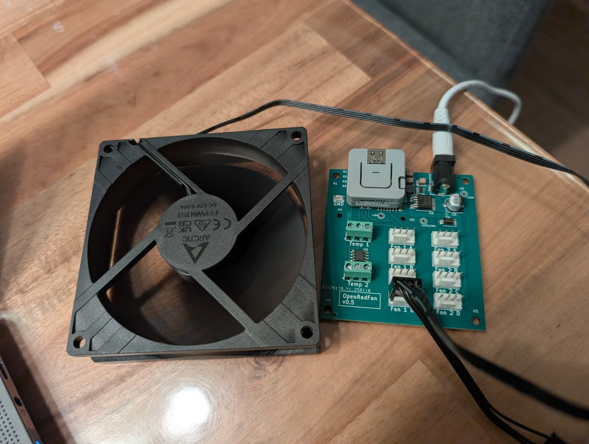

The prototypes are working nicely - total production & delivery very time was only 6 days from placing the order. I’m really impressed with the quality. I’ll do some full load tests and connect external temperature probes but it looks as if everything is working as expected.

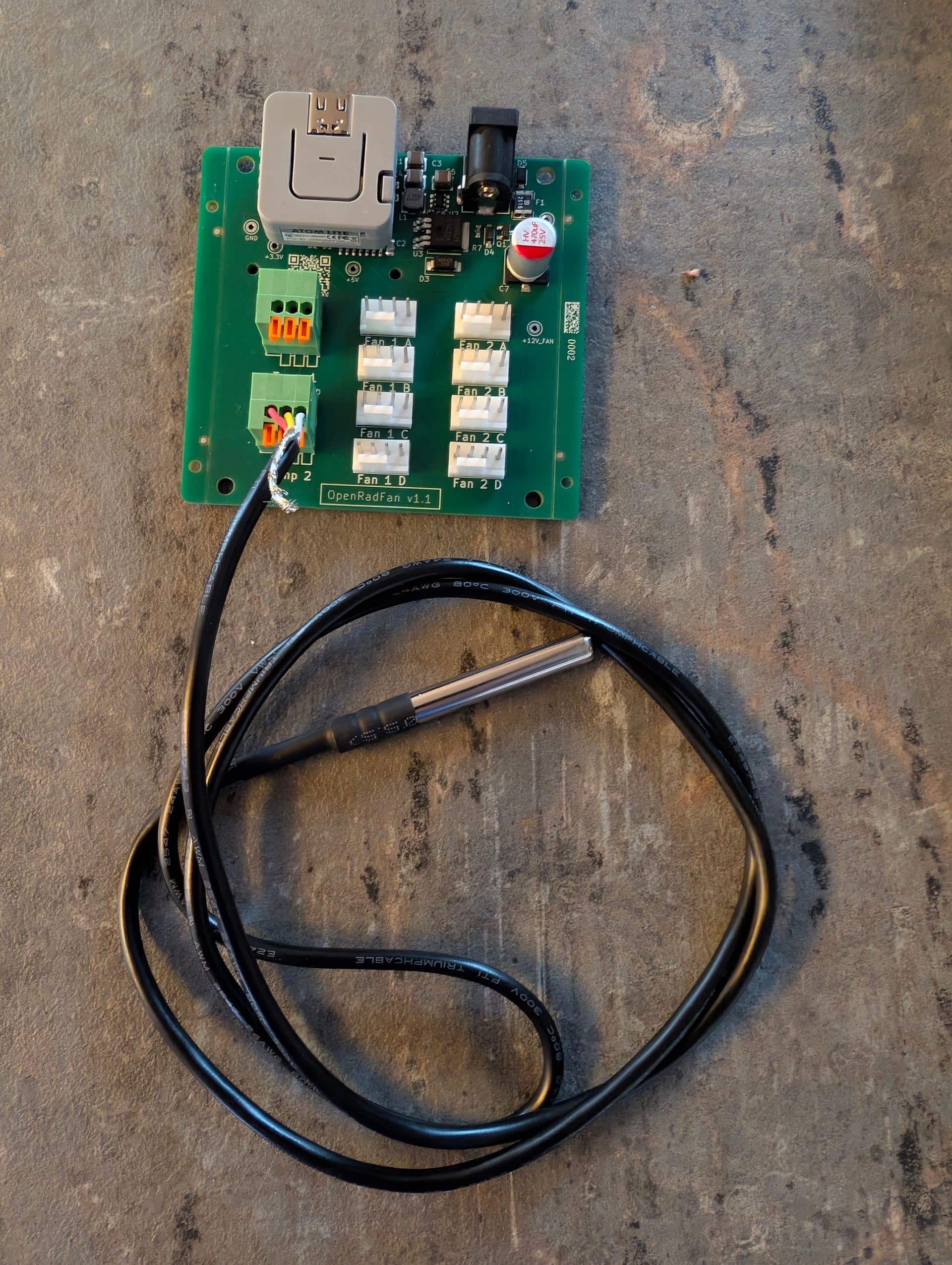

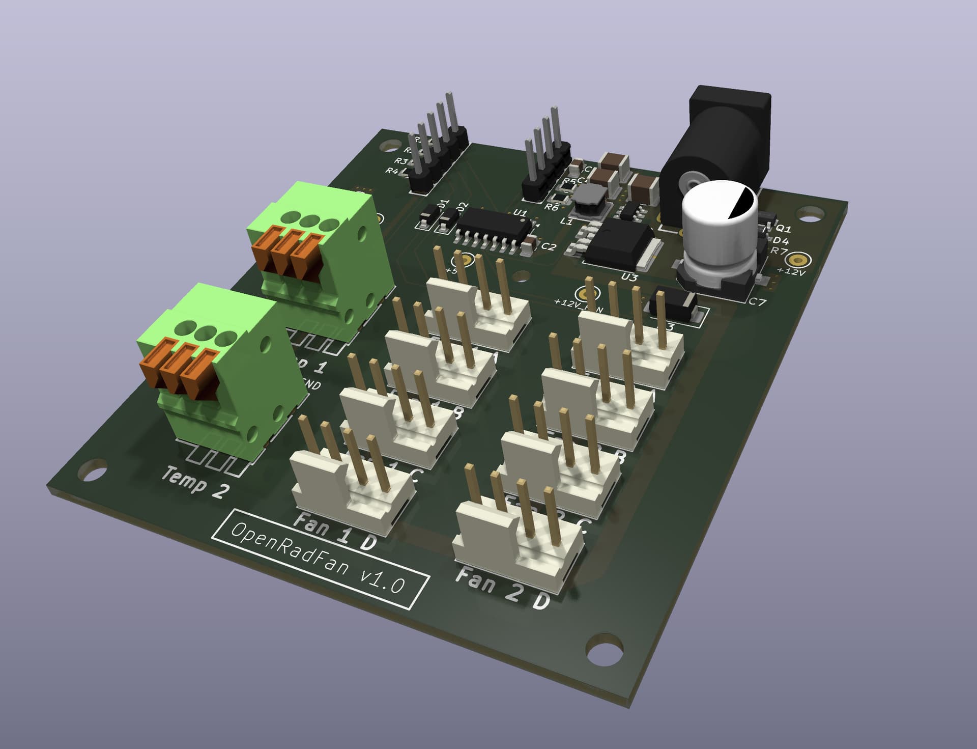

I have incorporated a few changes. I got rid of the on-board temperature sensor; mainly because it prevented standalone operation with an additional external sensor on the radiator, the reason being that you have to enter each sensor’s unique ID in the ESPHome yaml if you have more than one sensor. Without the always-connected internal sensor, the first connected external sensor will be automatically picked up. As there is a second connector anyways (and you can put as many DS18B20 in parallel as you want), I think this sufficient.
I switched the screw terminals to direct plugin locking terminals because I found myself hunting for small screwdrivers in testing. This way there are no tools required.
Finally, as people might be using them with universal power supplies or old ones they have lying around, I decided to add in some reverse polarity protection.
I am placing an order of 20 today at JLCPCB and expect them to be delivered to by the end of next week. I already got some requests - anyone interested in getting one (or more) please DM me.
I have uploaded the KiCad design files on GitHub. ESPHome code will follow.

Including customs fees + shipping to me, the price per controller including one temperature sensor came out to 35€/30£, a bit more than anticipated earlier. There’s definitely room for saving some money in the next version, but for now I’m quite happy. I’m not aiming to make any profit off these for now since this is just a hobby project, so I’m happy to send them out to anyone interested for the 35€ + shipping.

The cheapest fans I am using are the Arctic P9/P12/P14 PWM fans. You can get a 5-pack for around 30€. Another nice feature they have is that you can cascade them, even though the controller has sufficient sockets, this allows you to just make a long line of fans that only occupy one socket. They are not the most silent ones but cost only half of others. Also they can run really fast (1800 rpm) and modulate down to 0 RPM. I’m using them in my living room running at 35% where they are inaudible, even without acoustic decoupling.
