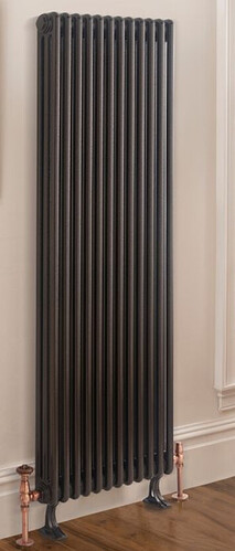

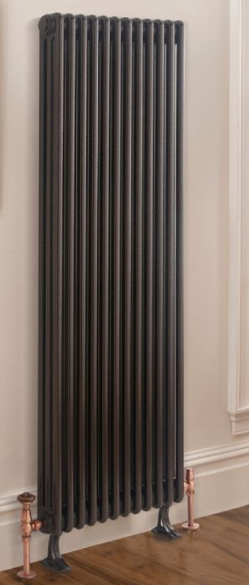

Is there any hope for fashionable “column”-style radiators with fans? I have one fed with 10mm microbore in the wall, probably worst-case radiator install ever, and most in need of more “power”.
Can you post a picture of such a radiator? I’m not sure I know which type you mean?
This kind of thing:
Which actually has a horizontal pipe across the bottom which would quite effectively impede airflow from the fans.
Could probably do something with fans slightly behind and pointing slightly up.
It might even work from below with a bit of distance. I definitely think you could boost output by quite a bit as any forced air movement around the radiator will help distributing the heat.

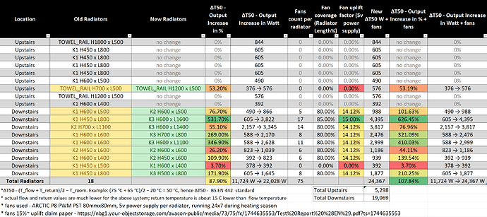

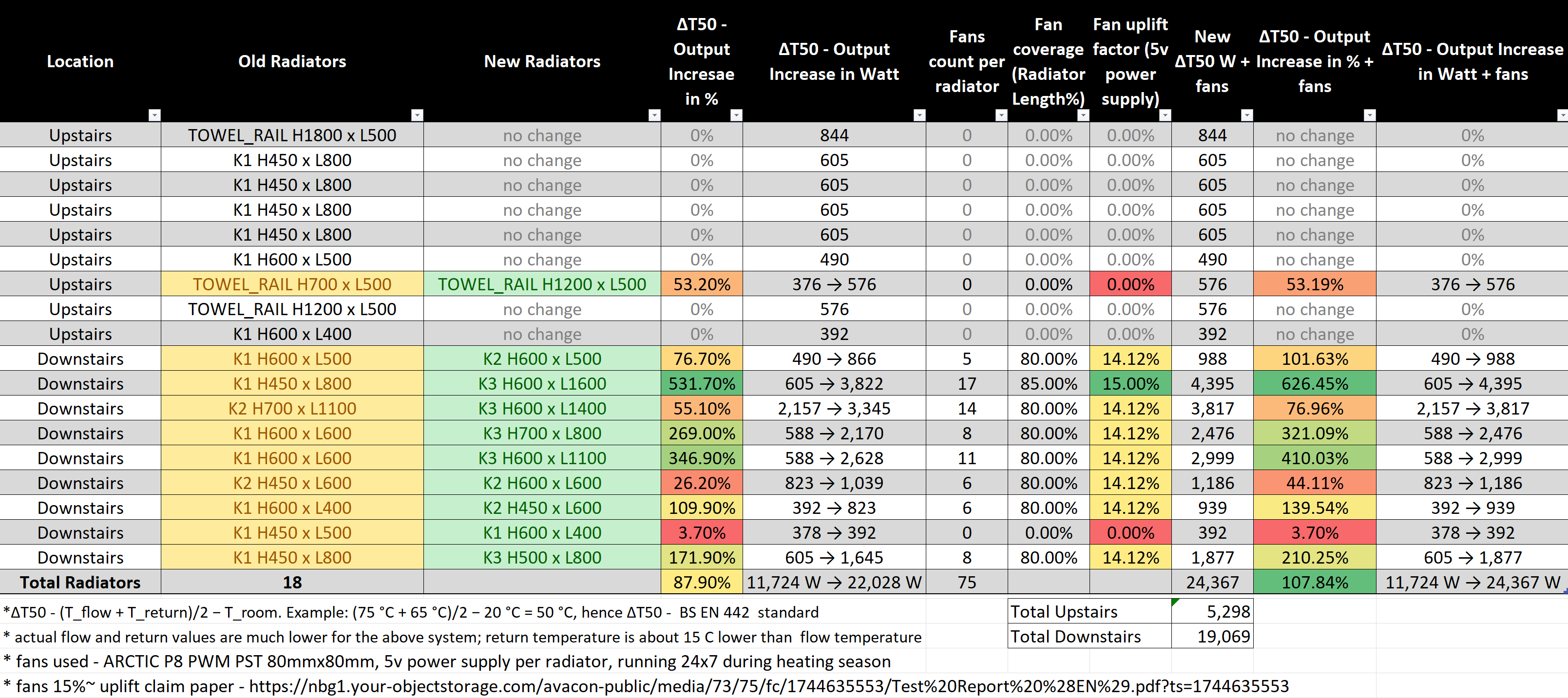

I recently upgraded some radiators and installed the ARCTIC P8 PWM PST (5 pack) fans under some of them. They fit perfectly under the Stelrad k3 radiators and cannot be seen. For one k2 radiator I used the slim version so they are also nicely concealed there too. I used a glue gun to attach them.
For the power supply, I found some unused USB chargers at home and then used the following USB to 4 Pin adapters.
For radiators where you want to ensure noise levels are minimal, I used
Here’s my radiator upgrade with the estimated heat output using the standard dT50 approach

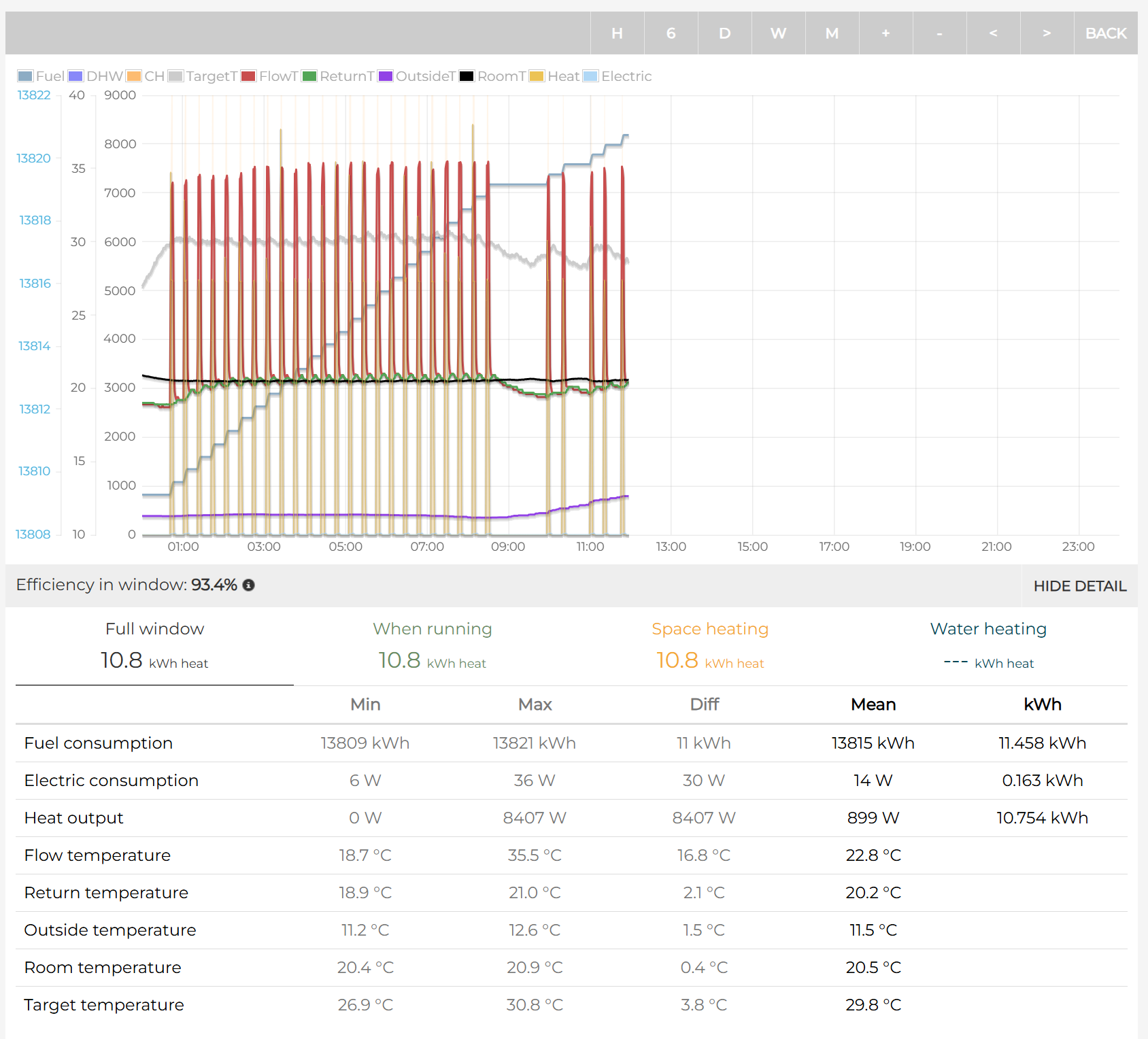

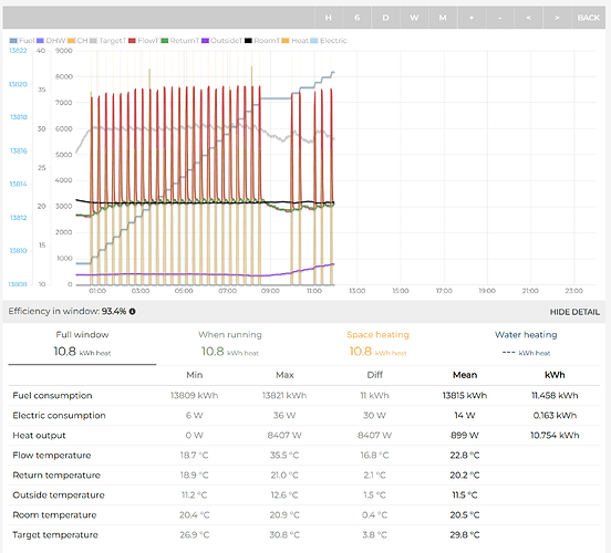

Today so far
Here’s my system on emoncms - return temperatures are now very low :slight_smile:
Emoncms - app view
Grafana view for some extra data
