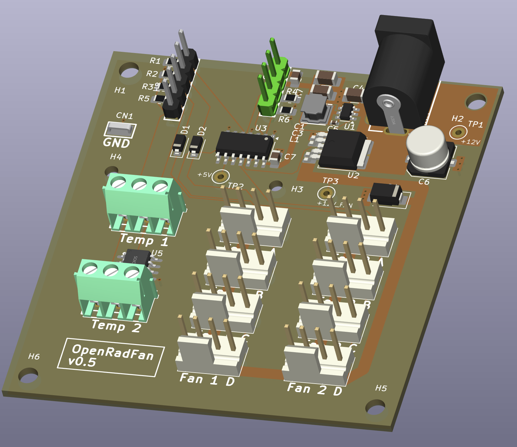

Sorry, Santa got held up a bit. I have noticed a few flaws in my design that needed fixing. This is 90% done now. I have redesigned the whole electronics so it can be cheaply manufactured at JLCPCB for less than 10€/PCB, plus the plug-in controller. Once this is finished, I plan on placing one big order.

That will be sufficient to get the extra degree. One of the flaws was not having sufficient sockets for fans, the new design has 8, so perfectly suited for your setup ;).
I put 8 fan connectors and the temperature sensors can now be attached with screw terminals to avoid having to crimp a connector to them. Also, there’s one DS18B20 sensor already on board. I’ll review the design again in the coming days to avoid any stupid mistakes and then order a first testing batch.

Would it be possible to swap the barrel DC power connector to a 5V USB-C type? This would make for a neater install in combination with USB wall sockets…
The fans are 12V, so that’d be kind of tough. You can negotiate different voltages over USB-C but I never looked into that

I had a look - you can buy 12 V “Trigger cables” that are barrel jack on one end and USB-C on the other. They integrate the necessary hardware to negotiate the voltage with the wall wart and then output the 12V on the barrel plug end. It’s a good idea to move to USB-C, but I would see that as further down the road as integrating the hardware to comply with the USB-C specifications is not trivial (to me at least). I’d really like to have USB-C and a full Esp32 instead the pluggable Atom lite on the PCB in the future but I don’t have the time for that currently.

You have to check whether they deliver sufficient power. It needs to be USB-C PD (power delivery) on the wall wart, otherwise they cannot deliver the power. If the rating is 3A at the standard 5V USB voltage that would be pushing it, as one 140mm fan can draw up to 0.3A @ 12V, i.e. 3.6 W. With 8 fans + some headroom you need a 30W supply to run them at full power.
I ordered the fully assembled prototypes from JLCPCB last night and hope to have them by the end of next week. If the tests are successful, I will place another order and could ship them to anyone interested. The more I order, the cheaper it gets. An order of 25 would result in 10€/PCB, plus another 10 € for the Atom Lite controller, so overall around 20€/piece + shipping. Cost optimization comes next, but I think this is not excessive. I’m just not sure about the process of shipping to the UK from the EU - I guess this would just be a private parcel without any customs involvement.

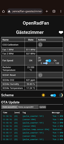

Softwarewise I’m currently using ESPhome in conjunction with Home Assistant. I guess a more standalone solution is needed as not everyone has HA.
There is latitude for some “edge logic” in ESPhome [I am sure you know this anyway].
For example, I have ESPhome deployed on smart plugs which pings something and power cycles if it stops responding for so many minutes.
ESPhome also can have its own web interface.
The web server component is a great idea, I hadn’t considered this. I’ll try right away to activate it for one of my devices to see whether the memory suffices.
