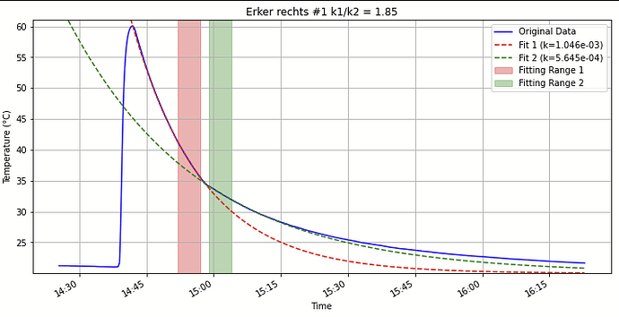

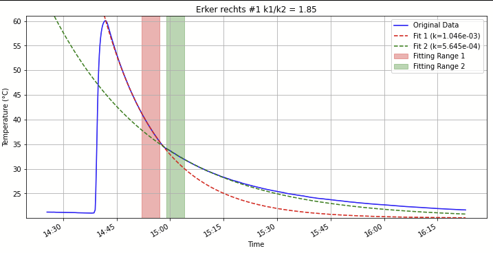

Here’s my data on this. As stated before, I let a bolus of hot water enter my radiators, completely fill them and then closed the TRV to observe the cooling using an infrared thermometer. The expected curve is simiular to an exponential decay, but not quite. It would be exponential if the heating power of the radiator was just proportional to dT (radiator - room temp), however there’s an exponent on this difference, i.e. Power ~ (T_rad - T_room)^k. k is typically 1.3 for natural convection in Type 33/22 radiators. This means an exponential decay will not nicely fit over the whole temperature range but will fit locally in a short-enough segment.
In any case, I left the fans running to cool the radiator down to 35°C and then turned them off. Looking at the time ranges immediately before and after the switch-off, I can fit exponential decays to these sections and compare the decay rates. This gives me the relative heating power with/without the fans. The example plot is a type 33 radiator, approximately 1 m long with 5 fans. I’m getting a decay constant ratio of 1.85, meaning I output around 85% more heat at 35°C flow temperature. Experiments on other radiators yielded similar results - between 75 and 110 % increased power.

Nice experiment. Another method would be to use the feature in My Heatpump app to estimate emitter size with and without the fans. I reckon my fans increase output by about 1kW.

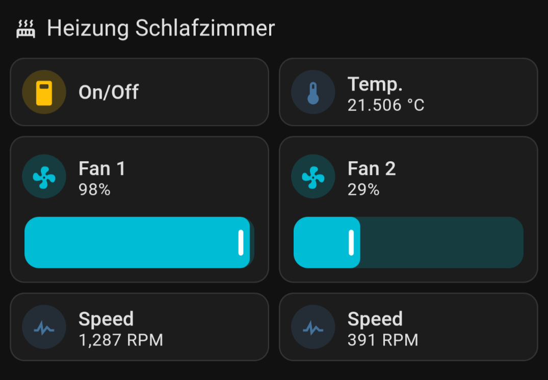

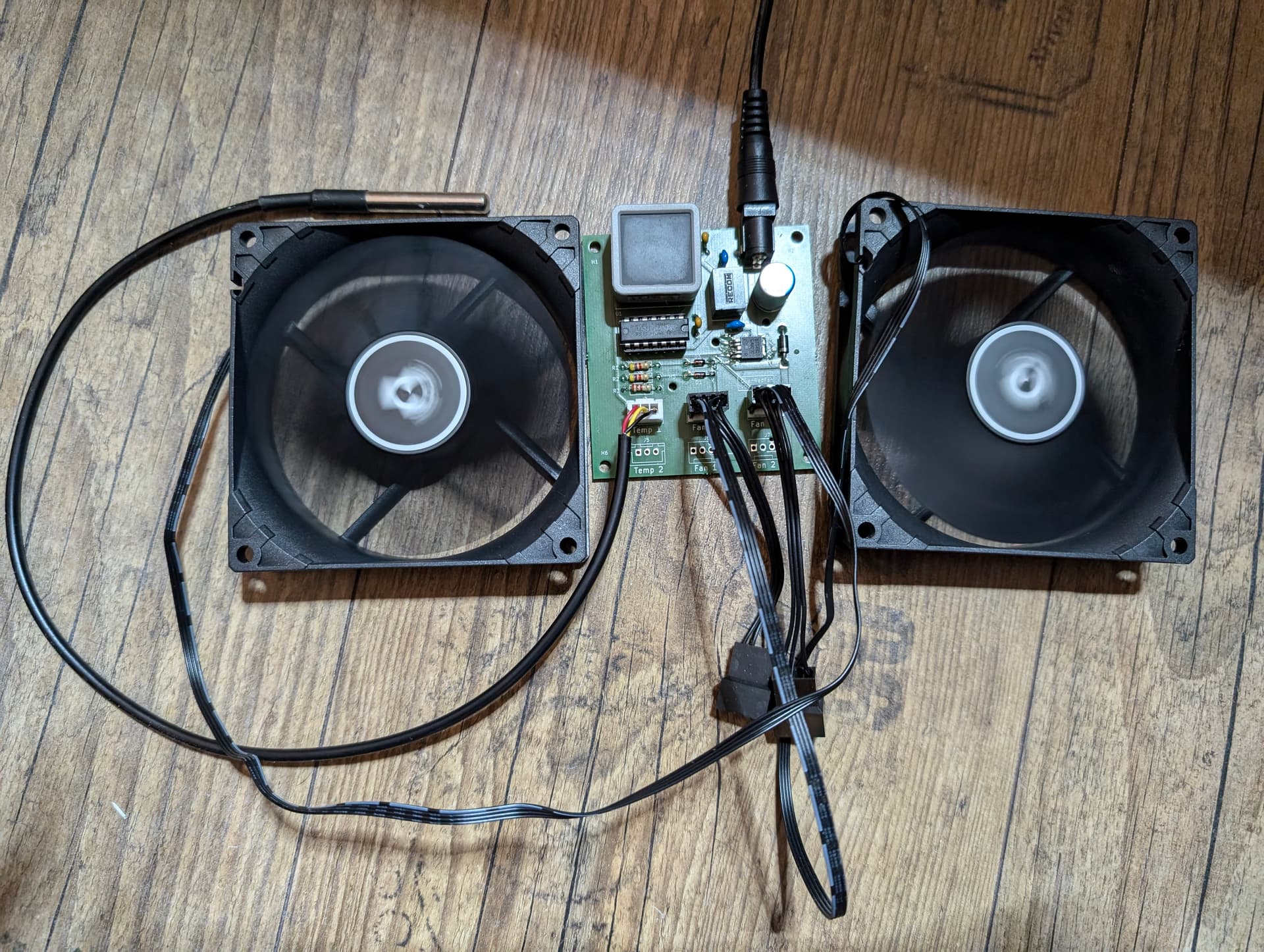

My second prototype is working nicely. Full control over two channels, temperature sensing and Home Assistant integration via ESPhome. Im quite happy with it! I thought on how to make this available - I’ll put all design docs on GitHub, and if there’s enough interest I could order a batch of populated PCBs through JLCPCB. I’ll do a small design uldate before though to make it more friendly to automated assembly.

Nice work. What brand/model are the fans? Clearly not the ones you mentioned in a previous post.
Those are Arctic Cooling 90mm PWM fans. They’re cheaper but a bit more noisy, but can also run faster. I use them for my Type 22 radiators´.
