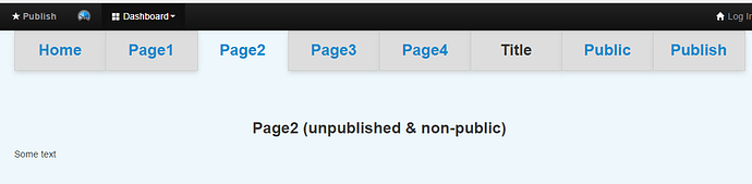

As a workaround I tend to have quite a few dashboard links and not publish all the dashboards eg you could have a “smart energy plugs” page that displays a dial or feed value and title for each smartplug and put a transparent box over that with a href link in so that the gauge or feedvalue becomes a hotspot clickable link to another more indepth per device page with a “back to smart plug list” button on each.
I have also made pages that have tabs at the top of using grey and white containers eg
Once you have a template page it is easy to clone and rearrange the tabs for each page (move the white one along one place and rename it and the grey one that has swapped position.
(please ignore the content and labels, this is some test pages I set up when trying to get read-only navigation working. With this method I can send a someone a link with a read-only key in the link and they v=can then navigate around those few pages as I have included a read-only key in the href’s so you do not need to be logged in)
