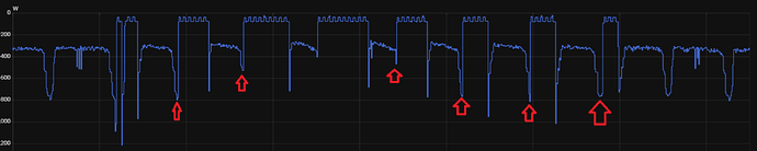

The update seems to have helped our 9kW unit, in that lowest power draw is now just over 700W compared to 950W previously. While running yesterday, it rose from ~700W to ~850W before tripping on flow temperature. That seems to be a significant improvement, especially if it will keep to the lower power end as the ambient temperature drops.
