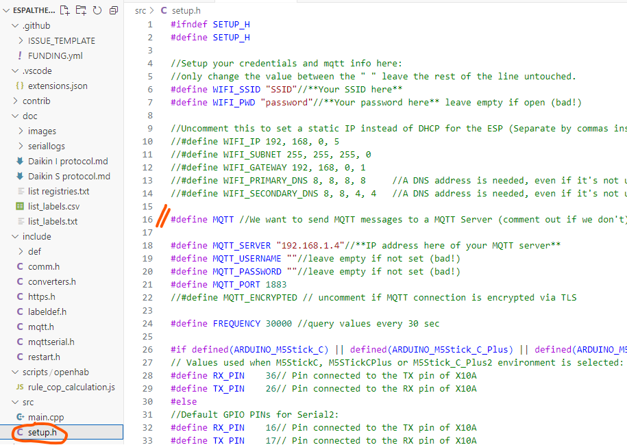

  • in converters.h, BOOLNUM needs to be defined - this means that rather than ON or OFF being sent, the data is 0 or 1 which is what EMONCMS is expecting

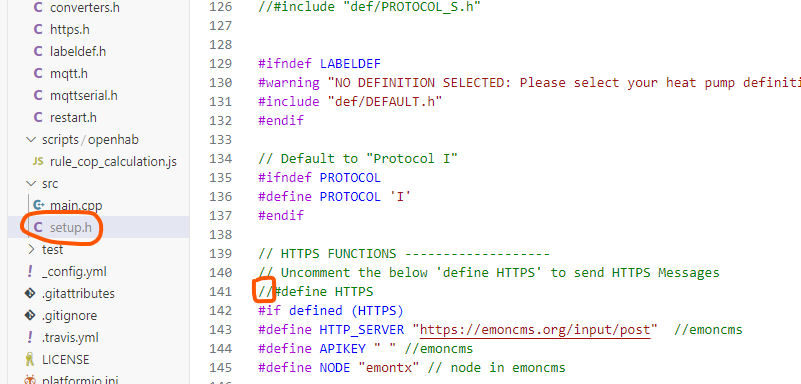

  • in setup.h, HTTPS needs to be defined, as well as MQTT not being defined

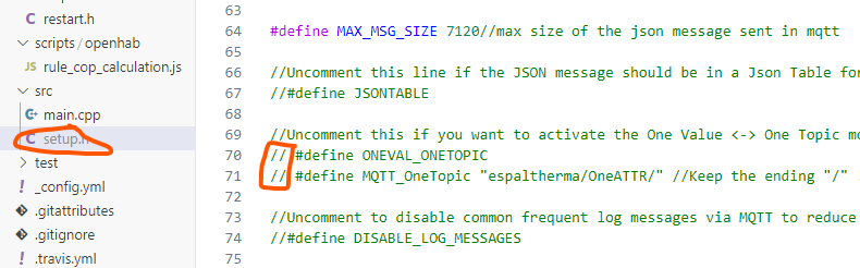

  • also in setup.h, ONETOPIC_ONEVAL should not be defined.

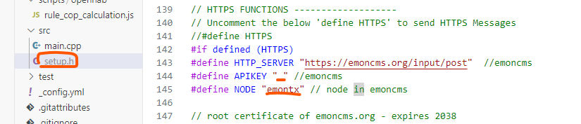

  • APIKEY and NODE also need to be defined with your own values

As regards the steps needed for making it go direct to emoncms then what you’ve posted back is the summary. To be more explicit:
remove the two slashes to uncomment #define BOOLNUM (you should see the text change colour.
*setup.h - uncomment (remove slashes)
*setup.h - keep commented i.e. leave the slashes here:
*setup.h - put your own emoncms read/write API key in place of the space. NODE you can choose what you like e.g. you could call it “HeatPump” etc.

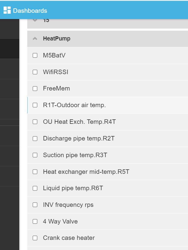

Fantastic, just what I need thanks!
Now getting values into EmonCMS…

@scanfer presumably you have asked for that in the list of data to send. I don’t see it in the screenshot above.
Do you have any of the 0/1 data that would have been ON/OFF in the normal HA/MQTT version?

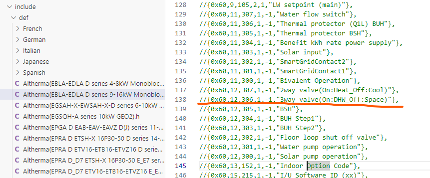

@Phil_E I’m using “3way valveOn”, firstly I should check that it’s the correct one to use to detect DHW?
It’s showing as zero in emonCMS Data Viewer since logging started on saturday.
is the one I’d expect to be used.

  1. As Simon Scanfer found, the 3-way valve signal is coming through but is zero all the time. This means that I do’t get separate data for hot water and heating. I have uncommented the line below
    {0x60,12,306,1,-1,“3way valve(On:DHW_Off:Space)”},
    and also uncommented #define BOOLNUM in converters.h
  2. I could not find the definition file ALTHERMA(TOP-GRADE) which others have mentioned is the correct one for my heat pump (Altherma 3H HT split). Just wondering if therefore I’m using the wrong code for the 3-way valve.
