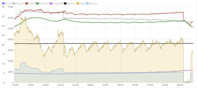

For those of you who have had Daikin attend and update the monobloc firmware on 9-16kw units, have you noticed any change in power consumption/efficiency etc? I haven’t and have not been contacted either.

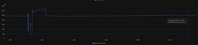

I’m curious since my unit will ramp down as low as 700w or so if its mild outside (10c out, target LWT 25c). Right now, it’s 4c outside, target LWT is 34c but it’s gradually risen and risen to 38c whilst consuming 1000w input power. I just wonder why it wouldn’t ramp down a bit instead since I know it can run lower than 1000w and if since the engineer firmware update if your unit is now able to do that and if any other changes you’ve noticed since.

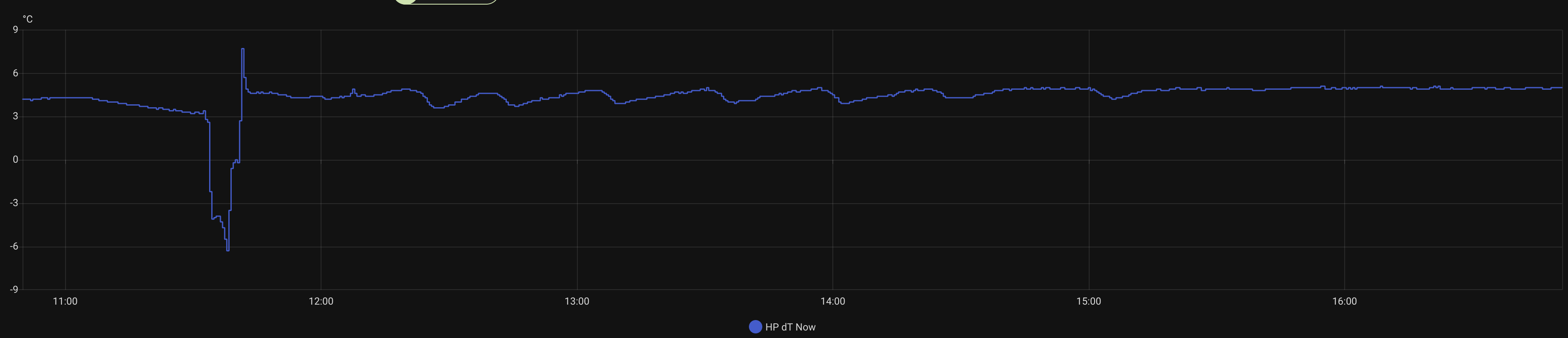

That ripple you see in heat output marries up with a similar but shallower ripple in input power.
It seems to be doing what it is supposed to be doing.
Your return is rising so the flow is rising within the overshoot allowed to maintain your requested dT of 5c.

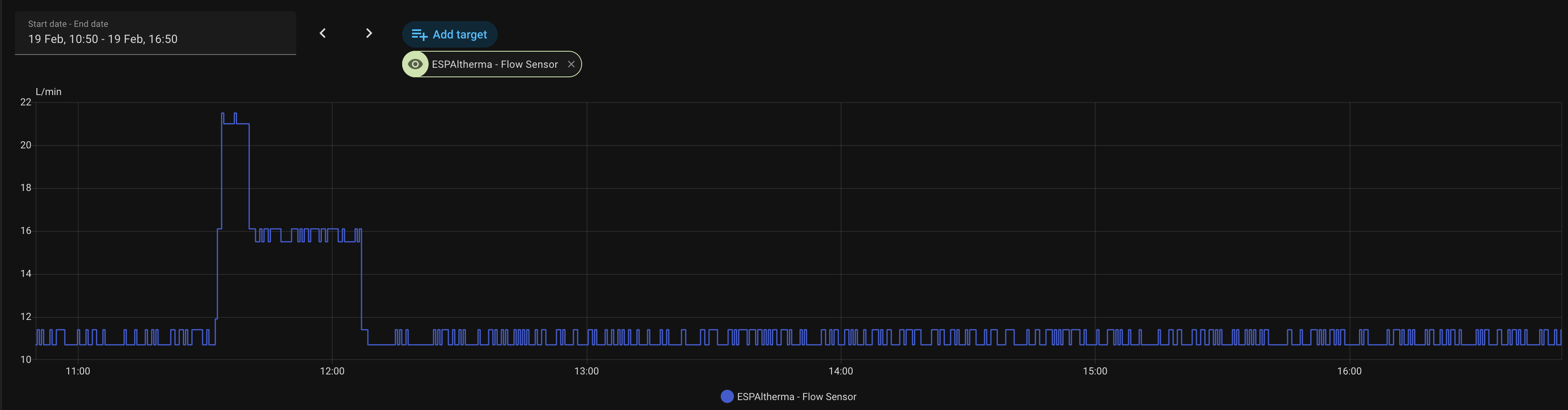

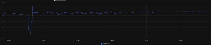

What is going on with the flow rate?
The same data showing the flow rate would be useful, I would guess it is on the floor at around 10lpm, otherwise it could have reduced the flow rate to keep the dT at 5c.
It’s all to do with return temperature with Daikin heat pumps.
I would assume you have hit the limit of your emitters and flow rate so the flow has to go up to keep running.
Flow rate is slammed at the minimum 11lpm as it usually is in steady state.
Overshoot does kick in, so it’s working in that regard. I just wonder why it doesn’t back off the input power consumption since it’s running above it’s minimum by some way and whether the firmware updates that Daikin has been installing for some here have changed this behaviour.

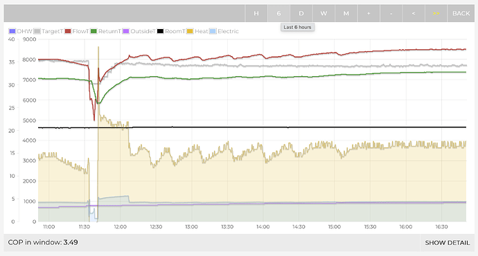

It’s 4c outside and it is heating the water to 38c, 1,000W of input seems reasonable to raise the temperature of 11l of water by 5c at that outside temperature.
If you want less power input then you will need a lower flow temperature which means either bigger emitters, a lower internal temperature or a smaller dT.
Reducing the dT to 4c should allow it to run a lower input as you should be able to get closer to the requested flow temperature at the minimum flow rate.

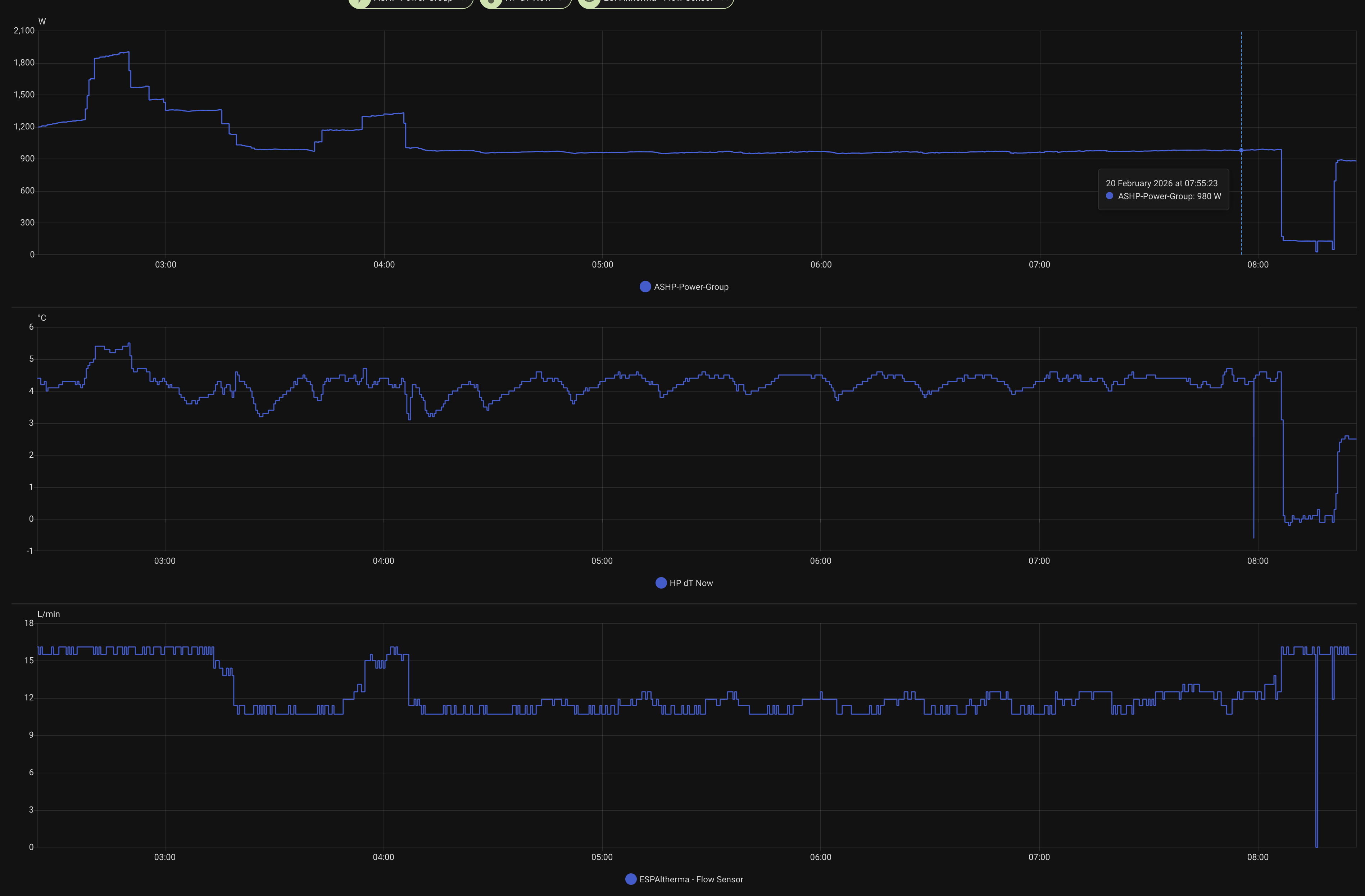

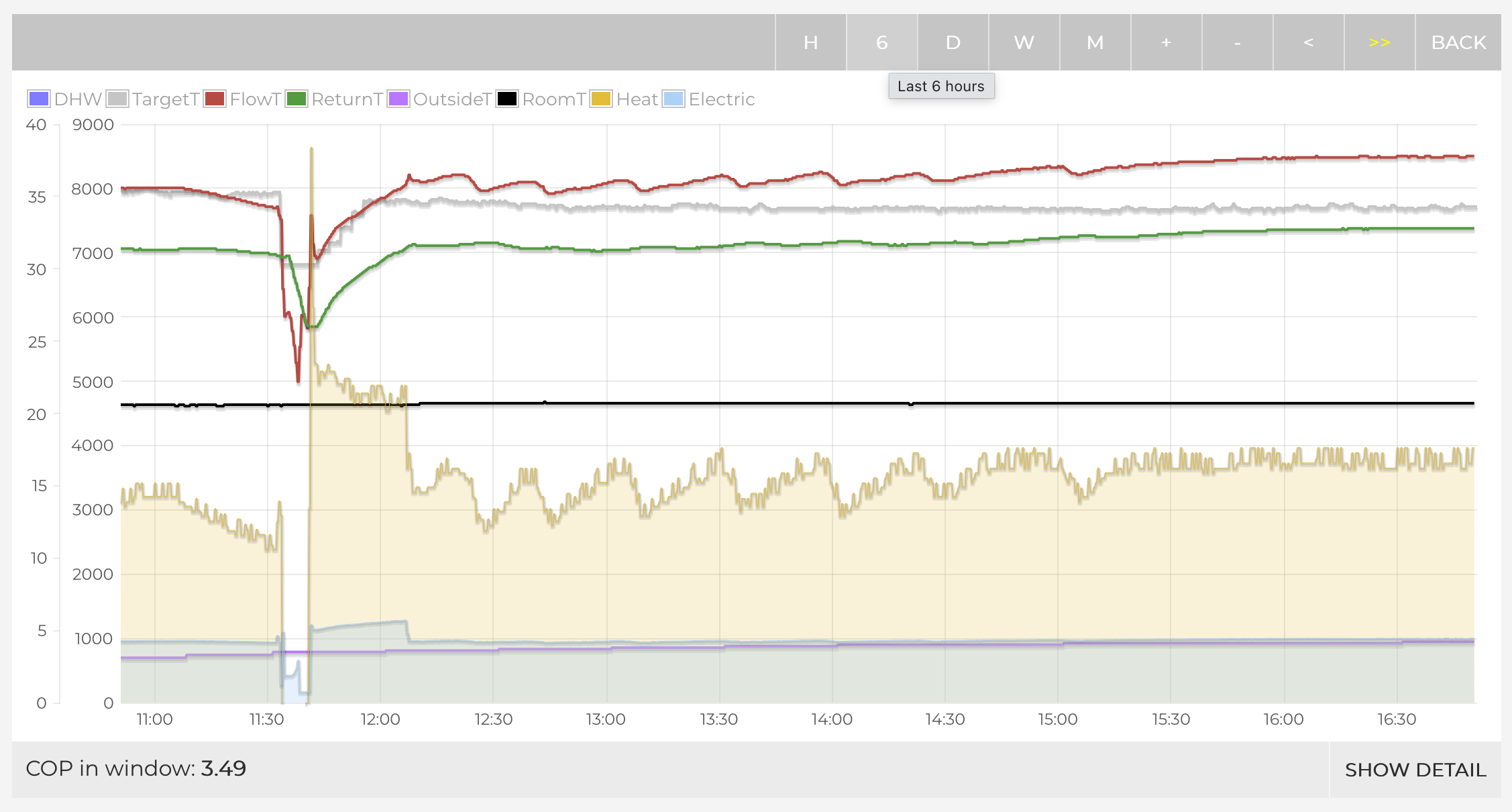

Here’s DT4, very similar conditions, a tad warmer outside at 5-6c.
So it’s the same symptoms. The compressor could run lower to not overshoot but it doesn’t.
The question remains, has anyone who is doing this level of monitoring seen this behaviour and if so, did it change after the Daikin engineer attended firmware update?

But that’s just the point. It could. It’s being told to consume 980w of input power but the flow temp keep rising and rising. Maybe there isn’t enough emitter power, maybe it’s oversized. It doesn’t matter. We know it could consume as little as 700w input power so it’s programming could reduce input power a bit. It feels like it has a window of operation depending on target LWT.
I know you’ve said before that it’s governed by return temp, but how does the Overshoot 4c parameter come in then? From the charts, it looks like overshoot is governed by the LWT, not the return.
I guess I could try DT3 but I think it’ll be the same. There is too much energy being input into a system that can’t emit it and for whatever reason, the compressor isn’t being run at a lower input power even though there is scope for it to do so.

The return is rising as your emitters cannot pass all of the energy into your house at the selected flow temperature.
If the flow temperature remained as you set it the dT would decrease.
Daikin heat pumps don’t work like that.
They maintain a requested dT using the return temperature as the reference point (it could not be referenced to the flow temperature and be maintained)
As the return temperature rises the heat pump has to increase the flow temperature to maintain the dT. It does this within defined limits.
That is the Daikin control logic, a dT based on return temperature maintained by adjusting flow rate and when flow rate is at the minimum it increases flow temperature by up to 4c until the dT is too low and it shuts down and tries again.
Think of it it this way
Requesting a flow temperature of 35c with a dT of 5c is actually asking for a return of 30c
Your heat pump cannot do that in your example above so the flow temperature has to rise.
If you removed the overshoot then it would shut down and restart a few minutes later and carry on doing this.
This is not really affecting your input power, that is being determined by the amount of heat being delivered and the outside temperature. A few degrees higher flow temperature won’t make that much difference.

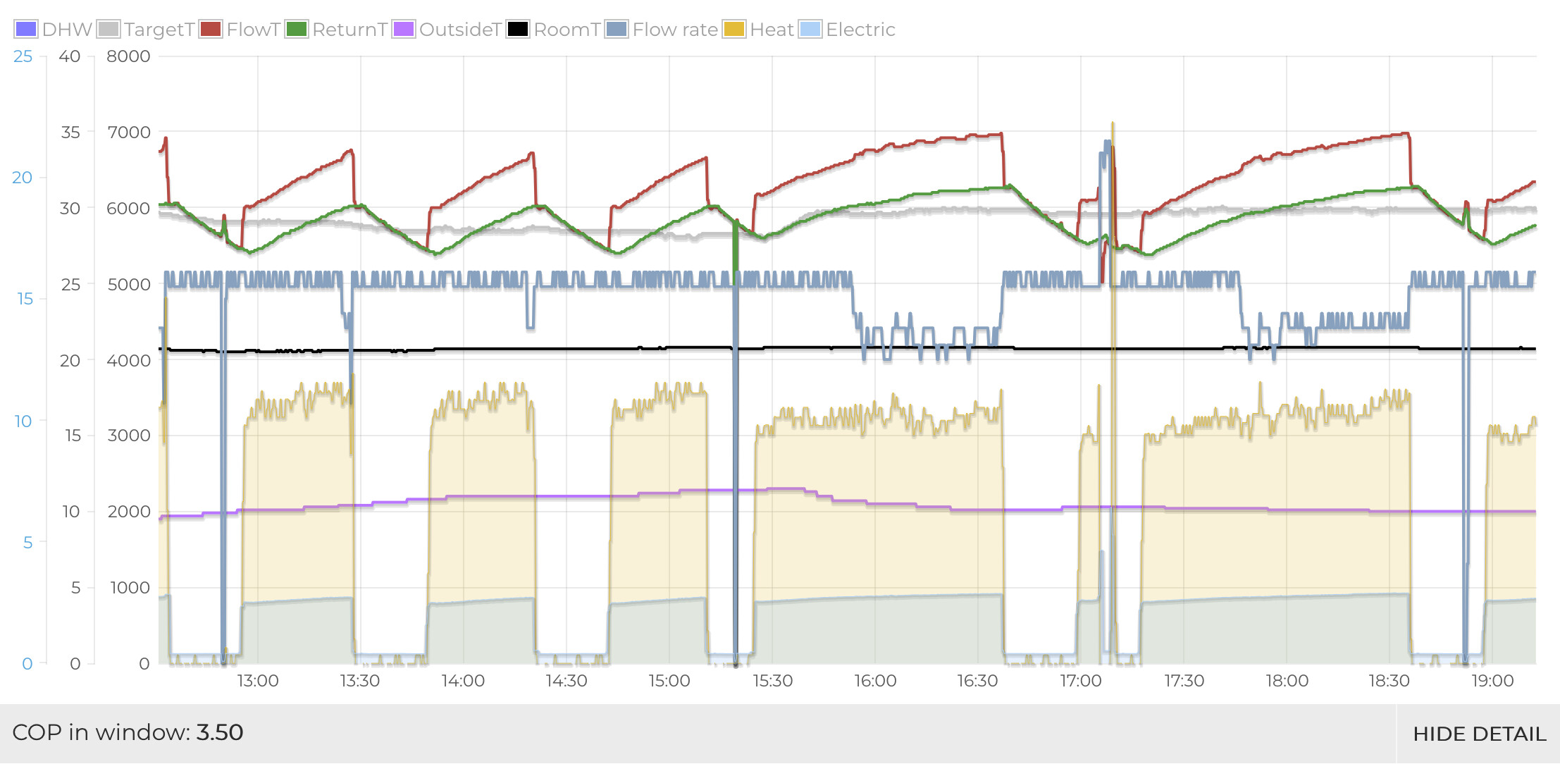

Well, DT3 was quite the change… (DT4 before 15:30, DT3 after)
@ColinS has seen quite an improvement on his system, see: Can you help? Heat Pump Maximum Output Testing - #7 by ColinS I think Colin has noticed other improvements alongside higher max outputs as well
@chrisg your COP at such a low flow temp is very poor because the emitters/ rads cannot output the minimum heat produced. The tell tale for this is the saw tooth wave form for your flow temp. The excess heat = input - output, first goes into an increase in flow temp until the overshoot level is reached and the compressor and fan stop. This is always bad news for efficiency. You will find if you increase the flow temp minimum set point ( or wd set point) to around 35 or even 40 c as Matt suggests, that the saw tooth changes to a square wave form and, as your rad output matches the min input, your % of Carnot and hence cop increase to about 5 or more at 10c compared to 3.5 now.
One other comment on the discussion above: the compressor and fan ramp up and down to achieve the target flow temp, they do not automatically change when you change the dt target. Flow temp is the primary target. Let’s say the energy input is Q
The pump speed goes up and down to achieve the target dt. As Q= flowrate x dt x specific heat capacity, then doubling the flow will halve the dt and vice versa. So pump speed alone controls dt.
Of course if your rad output is too low because the flow temp is too low then, even at min flow rate the dt target will be unattainable. I do not believe that the HP automatically raises its flow temp to achieve the dt but you will see the unavoidable rise in flow temp due to excess heat production mentioned above.
