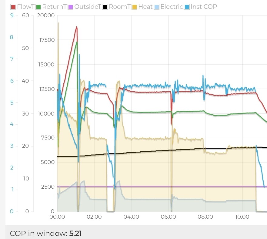

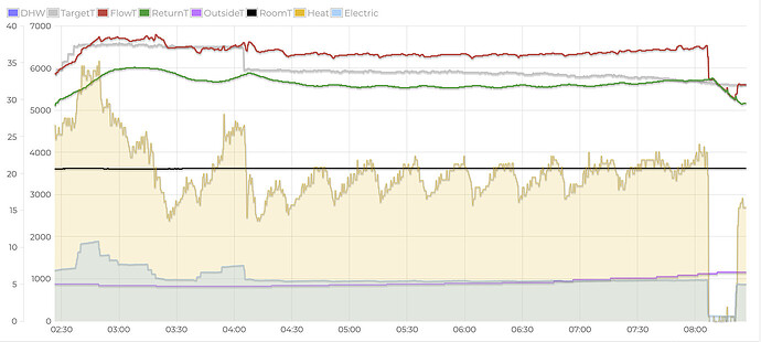

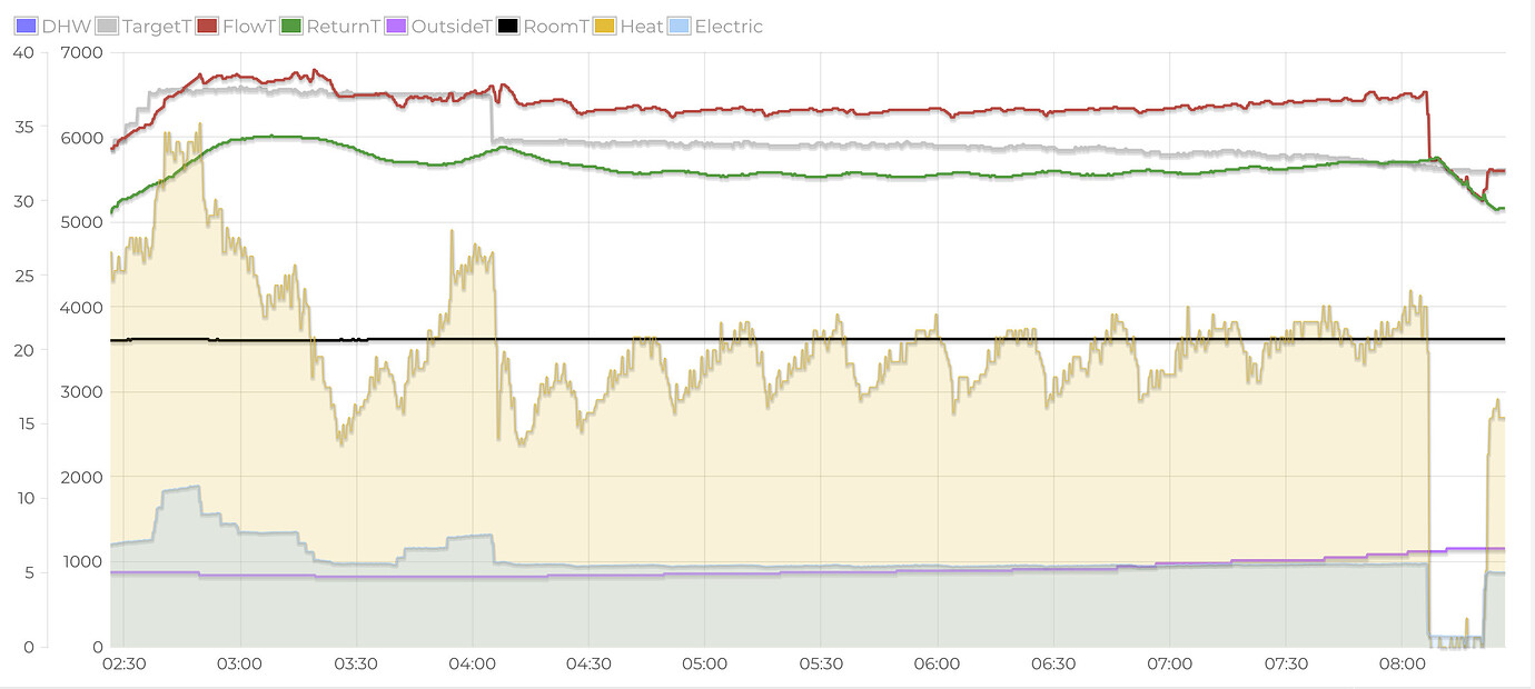

I have to say I’m puzzled by the 25 minute ripple in your flow temp and power, especially as the flow temp ripple in the first example above is not mirrored in the return temp. Then the opposite is true in the second example. There isn’t a trv somewhere ‘hunting’ and turning a rad on and off is there? It either this or some hunting by the compressor or pump at their minimum control levels OR do you have an auto bypass set to maintain minimum flow rates?
In any case it would be best to lower your dt target so the flow isn’t jammed on minimum. Raising the flow temp and rad output will also help raise dt.

The ripples are there in the return, they’re just more muted - I suspect because the rads output smoothed them somewhat. I can see them more clearly in the HA graphs.

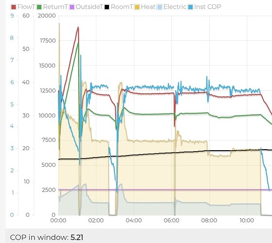

Re the ripples, I ve looked again at your dt4 example:
So you do get stable flow temps at 35c which i hadn’t spotted before. I had meant that the ripples are in the return here. The puzzle is that with a stable flow temp you should be seeing a much better cop in these conditions. As the rads here are coping with the output I’m wondering if the lower than expected cop and maybe the ripples are due to how and where you are measuring the flow and return temps? I’ll send a sample from my unit under similar conditions to show how I suspect your unit is really performing..either there is a fault in your unit or in your measurement.
