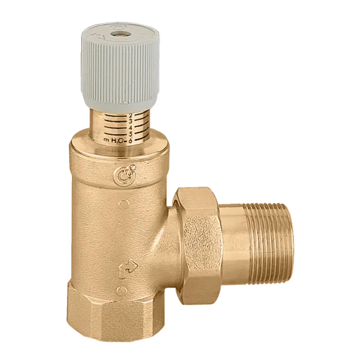

Bypass is set to 2 (1 = open and 6 = closed). See attachment.
Why 2? Because per Daikin manual instructions, I closed it, ran pumptest (12 L/min), then opened it until the flow was 14 L/min because that appears to be the minimum. It still said 12 L/min at bypass setting 3, but reached 14 L/min at bypass setting 2.
I tried 3 and 4 but with 4, the compressor started to make a lot of noise. Maybe because the bypass opened and closed continuously at that pressure point?

Your bypass is different to mine so I can’t comment on that. I would suggest, though, that testing it with the loop fully closed may not be a fair comparison since usually you would never expect that to be a real world condition. My bypass valve isn’t binary; I can hear it bypassing as it is adjusted with greater or lesser amplitude of flow noise. You may want to try it more towards the closed side for normal operation? Just an idea. I’m by far an expert in these matters. I hope others come along soon to offer help.
There’s maybe some useful information in this topic: Correct setting for Automatic Bypass Valves? (ABV)
