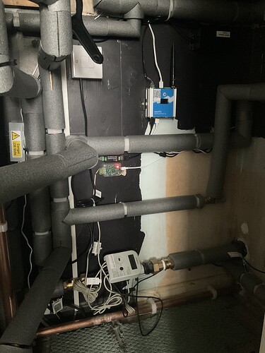

What type of heat meter (or flow meter) do you have, and has it been installed in the correct orientation?
I have the Axioma E4 DN25.
It’s installed horizontally before Any splits in the system.
The body is installed so the flat plate for the electric display is pointing 45° off the vertical line
Which is as specified in the installation guide
I assume this is correct or have I got it installed incorrectly ?
See very poor photo
Regards
Mark

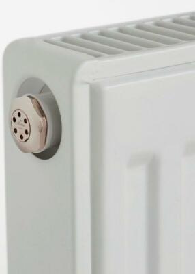

I’m not entirely convinced that AAVs are sensitive enough for this problem. I think they are probably more suited for big gulps of air pockets rather than the micro-bubbles that are interfering here.
That’s why I’m finding value in manually releasing at the points I listed.

On that highest radiator I mentioned, I did also fit an Aladdin Aav, but I don’t think this has been effective either.
