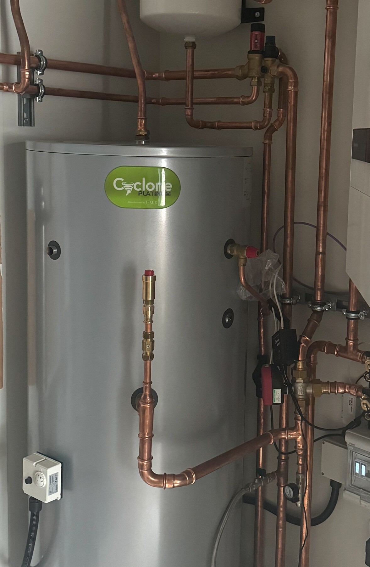

If you don’t already have one, a short length of pipe and air vent on the flow at the top of the cylinder coil will help remove trapped air. Also running the entire system through a fill & flush pump unit at commissioning will help remove the dissolved air, especially in UFH.

I expect idealy the pipe that connect to top of coil should be vertical above connection point, in a significant larger pipe size then rest of system with vent at top and connect to heatpump from a T part way up.
If a system have a volumizer, I would be tempted with value that short circuit the heating system so the complete flow only passes var the volumizer. (Maybe also emmerson heater in volumizer.) Then to cook off the air, temporary full open this “bypass” valve and run heatpump on maximum flow temperature and minimal pump speed with lowest system pressure heatpump will allow.
I’ve generally always put a air bottle/vent at top of coil, with flow pipe going up to it, seems to work a treat - and for what it’s worth I believe the Joule high gain cylinders we use have large smooth bore coils. A volumiser with air vent on top will help remove air due to the reduced velocity - I would recommend having fill & flush connections, often found on UFH manifolds, or add to primary pipework and use a flush pump unit with drum/container which will remove a lot of dissolved air if you run it until the water turns clear and handy for dosing with biocide etc.
