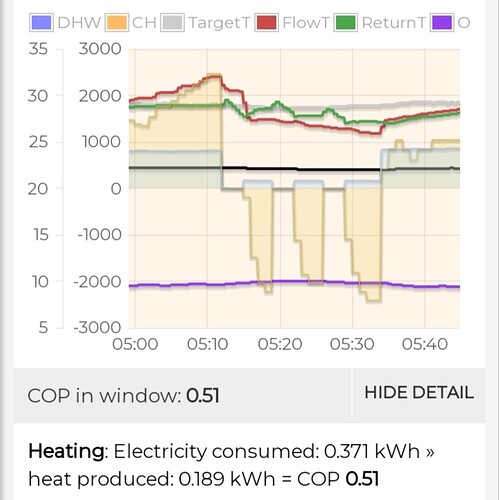

If we assume my R1T and R2T are not lying/faulty, then there is always a 2C loss in the BUH and associated large bore piping in the unit. At 30l/min, that’s approximately 2 x 30 x 4.2 / 60 kW or 4.2kw. More importantly, 10l/min is 1.4kW, which is a huge chunk of the output.
The simple graph above, plotting R1T temp (before), R2T temp (after), and R4T (return), shows how 2C makes all the difference to the numbers! R1T never goes below R4T, but R2T drops quickly below until the HP compressor cuts in again. Basically, the HP/BUH/pipes are sucking heat out of the radiators, which has to be restored before the Target Flow Temp can be reached. This doesn’t affect the house temp, because the R2T is still above the indoor temperature, but the transfer of heat to the outside and the required extra energy to warm everything back up is hammering the COP.
I’m probably going to remove the panels and check the insulation, or lack of, on the BUH and piping. It’s got to be going somewhere! I’m quite impressed that it can lose that much heat in such a small area/volume, but then the ambient-flow dT is 20+C.
Could some kind of radiant heat from the heat exchanger be providing an inaccurate reading of actual water temperature? Rather than the water actually losing heat in that short space which seems unlikely.

I wonder if R2T thermistor is faulty, or incorrectly fitted to the pipework, as I can’t see how it can possibly be that much lower than the return pipe while the heat pump is inactive.

Thanks for the input, really appreciated. I’m trying to think my way through this. Maybe Daikin will have some idea - I’ve asked them about it. Where would the heat come from to keep R1T higher? Maybe the residual heat in the heat exchanger? Which is then lost in the BUH? I note that @Stephen_Crown has only a 0.8C loss R1T-R2T, so my thinking is indeed a problem of some kind with the R2T thermistor. There remains the question of the loss in the BUH and associated pipework, but at least that’s lower.

The “pockets of water” are moving when the sampling occurs - the graph below shows that pump activity drops R2T below R4T, and they remain relatively static when it’s not.
  • red - pump speed (0-30 l/min)
  • blue - R4T (return)
  • yellow - R2T (outbound flow)
When the compressor turns off, we would expect the flow temperature to drop down to the return temp. Not below return.
This data shows 380 Wh of cooling, which is more than half the energy transfer as was used for heating. This says to me bogus measurements.
Also curious that (other) flow and return temps rise when water stops flowing, and drop when it flows again. But let’s tackle one thing at a time…
It will be instructive to look at @Stephen_Crown 's 11kW Daikin, which is also monitored by ESPAltherma reading the HP’s internal sensors. He reports a smaller R1T/R2T drop, 0.8C, but apparently his measured FlowT does drop below FlowReturn to some extent - I haven’t looked at that yet.

That’s less curious
Heat will soak.
When water flow rate drops the deltaT across plates etc will fall (so water gets hotter)
Lots of reasons this can be the case
