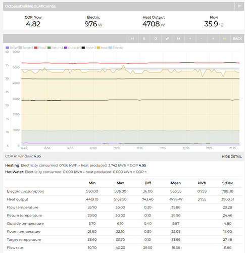

I’m struggling to understand what is going on with my heat pump. My radiators are now big enough to cope with the heat output but I have a more fundamental question when I compare my system to the 11kW Daikin in Cambridge.
Same flow temperature and same outside temperature but my heat pump uses far more electricity at the same flow rate and flow temperature. I want to find out what the problem is.
My heat pump, 1,348w flowing at 35.4c
11kW in Cambridge only using 970w to flow at 36.1c
I am using 50% more electricity for the same result, I just don’t get it?
My heat output is what I would expect at the flow rate and temperature, it’s just the electricity consumption that is required to achieve it. Looking at other pumps n the range it seems like I just consume more electricity.
At times it is fine but it is inconsistent.

Hi Matt
Yeah, very interesting. I have compared my recent numbers to yours (Heatpumpmonitor.org, top right/ graph symbol/ compare function, Reading Altherma vs Ipswich Altherma, dates 27/11-7/12), and yours seems maybe less consistent than mine. Even Electric Input vs Outside Temp shows mine with much lower numbers, which is a surprise to me, sitting in my plasterboard tent! There is one outlier on mine which is the dratted booster heater for legionella.
Do you think it’s worth doing a direct comparison of your MMI settings with mine, via an export to a USB stick, just to see if there’s any unspotted parameter?
Hi John,
Is yours the Cambridge one?

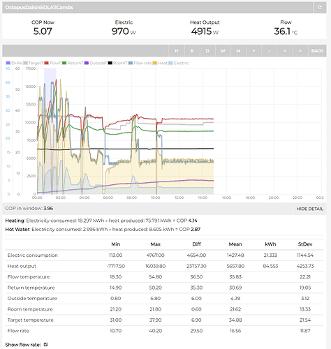

Look at this, my flow set at fixed 35c with no other influence I am aware of
Compared to this, I just don’t understand what would cause the different behaviour? Mine is currently flowing at 34.2c even though it is set at 35.0c
I am going to try and download the settings now.
I think I have sent them to you.
Now it is doing this.
I think it is heating DHW, it is scheduled for 13.00 tomorrow to heat to 50c and the tank is currently 47c.
I have seen strange DHW times with the schedule ignored and random unrequested reheats

@matt-drummer Hi Matt, this one is mine.
I use Leaving Water Control (aka pure weather compensation).
I have dT set to 5C target
Set to Sample and also Pump limitation for sampling at 60%
I have very narrow curve (32C @ 15 & 38C @ -3C) as it seems happiest in this range.
I have disabled the boost it does around 0C
I have disabled all backup and booster heaters
Auto bypass valve fully closed
Open system.
In fact I have tried reinstating the Honeywell controls to load shift using the UFH, and can see that it save no input electrical power, just outputs less heat!!! So UFH is now back to fully open, no valves, no pumps, no controls. Just old fashioned balancing.
Importantly, I have overshoot at its max of 4C - today a perfect example as most of the day it has run just over the target flow temp by a degree or two, and if I hadn’t got the 4C overshoot enabled, it would cycle like mad.
This unit appears to be most efficient running at minimum output (with the caveat that it needs the emitter output to be able to take the heat and dissipate it)
I think the madoka + its modulation may be your issue at this point as I use neither and you have significantly upgraded the heat output/load now
Bizarre as that’s where I’ve got to as well. Very interesting we’ve come to the same conclusion.
I just have to turn mine off in milder weather for a period of time.
@matt-drummer do note that as I’m running ESPAltherma, I have been able to add the “target flow temp” value.
Note that the flow temp is in the “overshoot” window (I have set it at 4C). This implies it is running at minimum output, can’t drop lower, but the overshoot parameter prevents short cycles.
Madoka + modulation probably does the exact opposite to this.

I have no trvs on my radiators, normal fully open lockshields on one end and Danfoss RLV-D lockshields on the other end.
The radiators I have now are what I worked out I needed to produce my heat loss at a mean flow temperature of 32.5c and 21c indoors, about 4.5kW.
I should be getting that now but for some reason I am not, I get close at times, I can only think I have flow issues, but I have a thermal imaging camera so should be able to find the issue(s).
I am going to go over it all again at the weekend and remove any variables I can, I just need a decent day where I can set a flow temperature and maintain it with no defrosts.
I think the Madoka messes things up but I may revert to it in the end, I just want to get it functioning properly first.
How have Octopus/Daikin responded to this same question?
There should not be such a discrepancy in steady state conditions.
