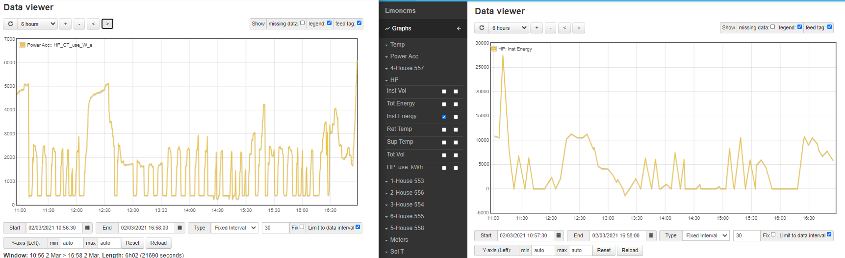

With regards to the CT sensor I was comparing the graph I am getting with the instantaneous energy reading of the heat pump:
Am I correct saying that the CT sensor reading is in Watts?

Hello @Rolop, interesting, how are you measuring electrical consumption? is it an emontx or emonpi?
Looks like a fairly low resolution from the heat meter readings. Is it a hot water heat up period 12 to 12:30?
The outside temperature feed is optional in the heat pump app, or at least it should be…
Hello @TrystanLea, electrical consumption is being measured via a CT sensor connected to an emonpi. There are no specific heating periods for the heat pump as it operates based on demand.
