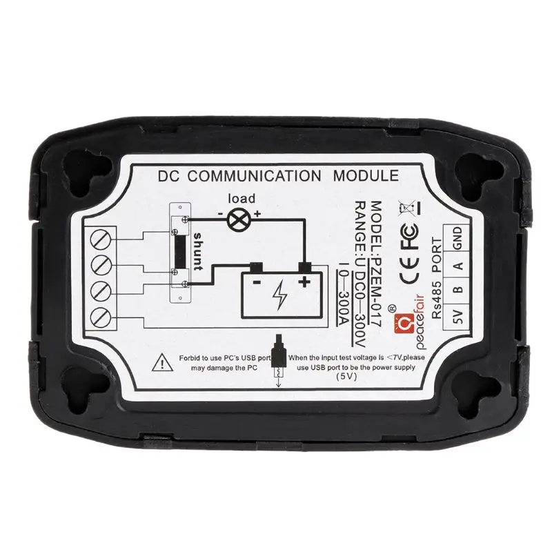

hi Stuart, what do you think about this rs485 200v shunt would that be good for the high voltage folk (and everyone else)? Cheap too.
You have to worry when the device says it will damage your PC if you plug it in!
Shows its not electrically isolated from the signals it’s measuring.
in the manual it is supposed to be isolated
the warning is to not power the unit with the pc (mini usb) when under 7v on the battery,
comunication port is passive and optoisolated.
I read that as just the opposite. i.e. use the PC’s USB port if the voltage is <7V.
Even though the maual does say when the test voltage is <7V, please use the independent power supply mode.
The manual also says the instrument is capable of reading frequency, but the register address table says otherwise. Why would a module that reads DC need a frequency function anyway?!
Seems to make more sense grouping the words on the left side of the USB connector symbol together
as well as grouping the words on the right side of said symbol together.
Reading them as one long string from left to right as Forbid to use PC’s USB port When the input test voltage is <7V please may damage the PC use USB port to be the power supply (5V) doesn’t quite read right.
That said, with things made in China, it’s definitely a WTH?! moment when it comes to figuring out
their broken English and datasheets/instructions. Seems like there’s always something lost in the translation.

sry i meant to say never use a pc to power the pzem on the usb port, only a power supply.
the pzem needs external power if main battery is under 7v.
It looks like the rs485 output has two optoisolators on it, which is good.
The code/intelligence if the existing diybms shunt is all contained on the board, it does all the amp hour counting and soc calculations.
This and similar shunts seem to be dumb in that they need an external controller to do that work.
